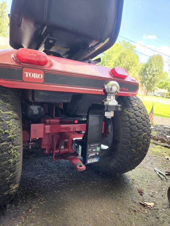

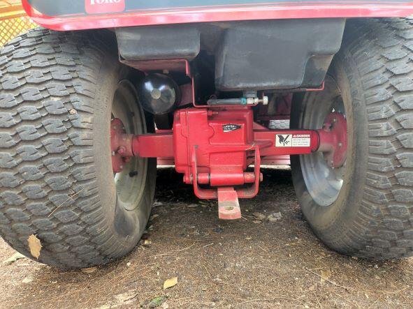

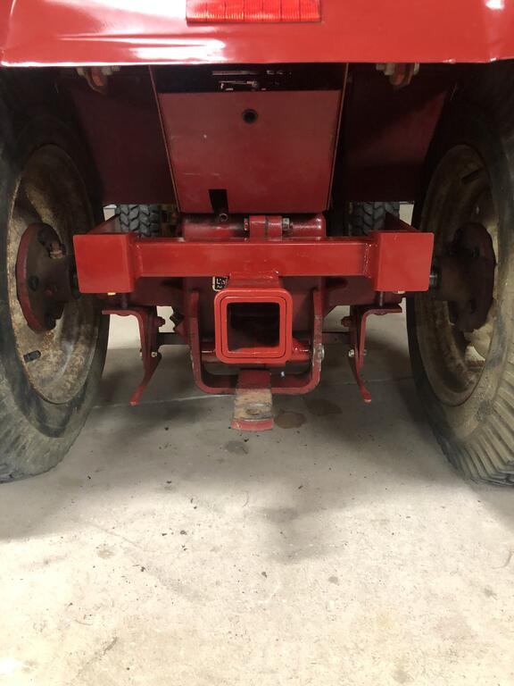

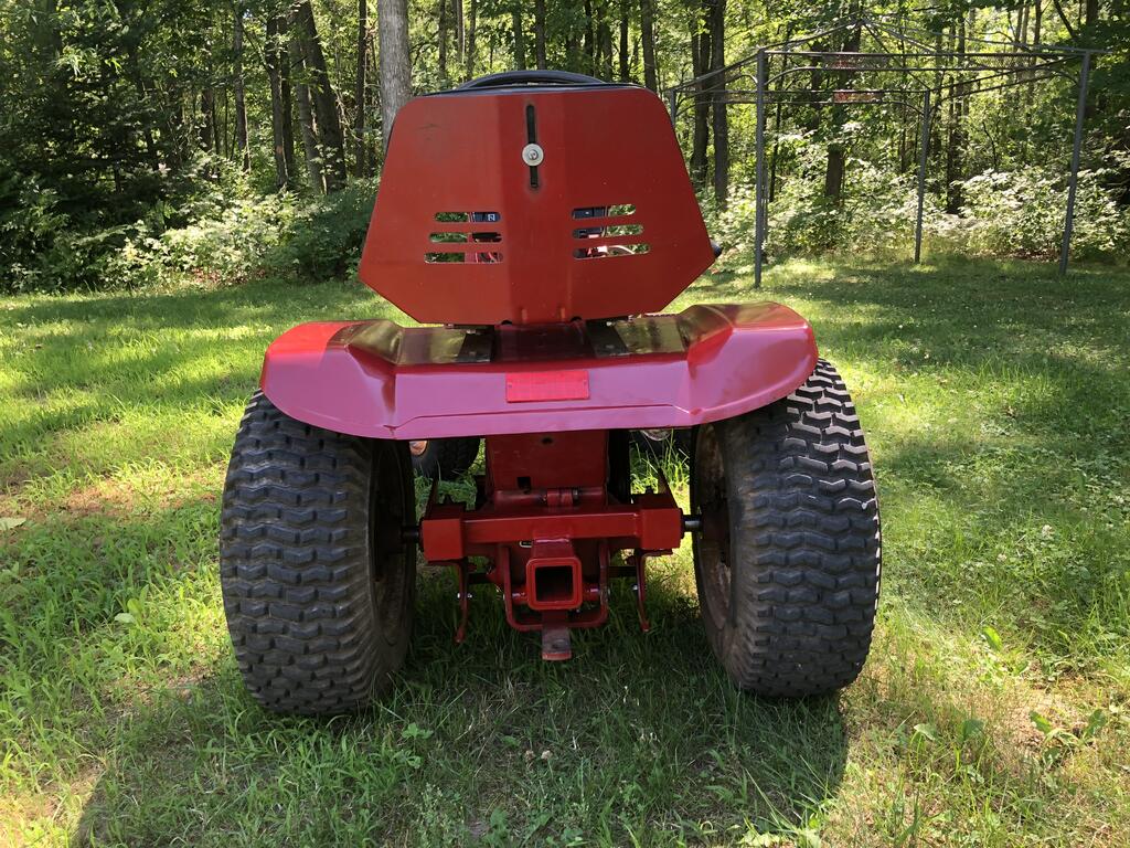

ReelFaster 53 #1 Posted July 23, 2022 Hey gang looking to pickup my first WH tomorrow. I've lined up to purchase a 416-H with low hours. Anyways I intend on putting a hitch on it to move some small trailers around the yard, something like this and this. Wanted to ask how difficult was to install and what's involved. Thanks much in advance! 1 Share this post Link to post Share on other sites
Blasterdad 3,163 #2 Posted July 23, 2022 Super easy, they just bolt on around the axle. 4 Share this post Link to post Share on other sites

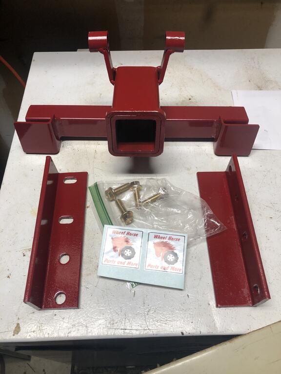

ebinmaine 77,553 #3 Posted July 23, 2022 1 minute ago, Blasterdad said: Super easy, they just bolt on around the axle. Absolutely agreed. I recommend the second one. That's from Lowell and Joette at Wheelhorse Parts and More. Good folks. 5 Share this post Link to post Share on other sites
Rob J. 1,942 #4 Posted July 23, 2022 I second Eric’s comment. I just did this. It fits like a glove and is stout as hell. 2 3 Share this post Link to post Share on other sites

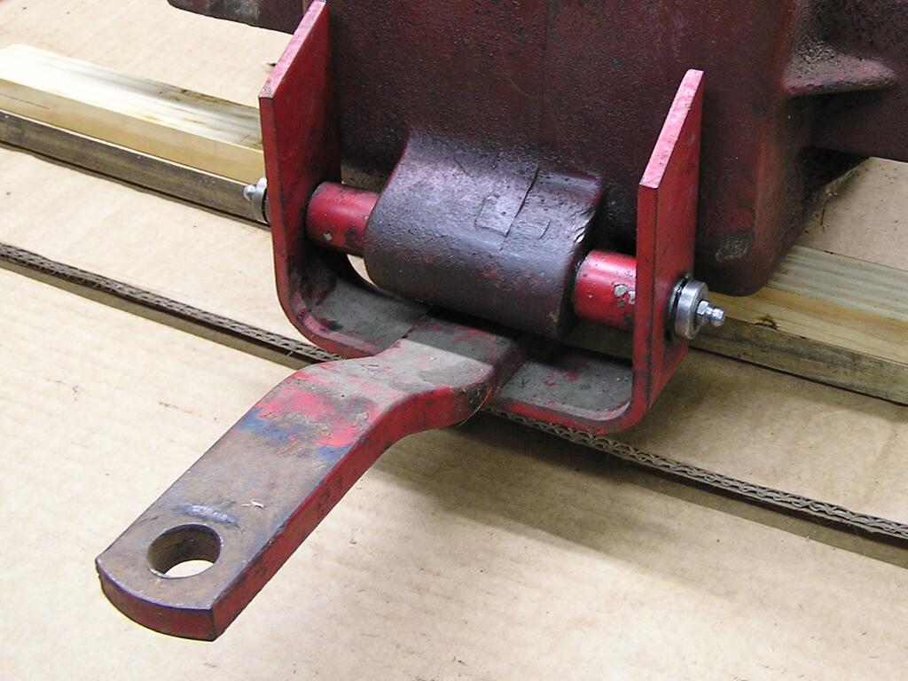

Rob J. 1,942 #5 Posted July 23, 2022 Just need to make sure your original hitch pin is free. 3 Share this post Link to post Share on other sites
Lee1977 7,577 #6 Posted July 23, 2022 I built all of mine. 520-H C-120/180 1 5 Share this post Link to post Share on other sites
ri702bill 11,414 #7 Posted July 23, 2022 (edited) 34 minutes ago, Rob J. said: Just need to make sure your original hitch pin is free. And that is EXACTLY why I do this with all of mine - undo one clip, push it out with ONE finger... going on 10 years now..... Edited July 23, 2022 by ri702bill 1 3 Share this post Link to post Share on other sites

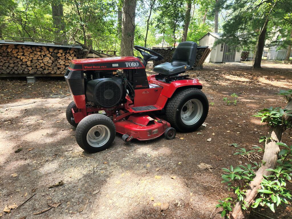

ReelFaster 53 #16 Posted July 24, 2022 Newest edition and my first WH. 2 Share this post Link to post Share on other sites
ReelFaster 53 #17 Posted July 24, 2022 Just now, ReelFaster said: Newest edition and my first WH. 2 Share this post Link to post Share on other sites
ReelFaster 53 #18 Posted July 24, 2022 (edited) I notice the receiver hitch is sold with a #104659 bracket or without. Not quite sure what that is, thanks in advance!!! Edited July 24, 2022 by ReelFaster 1 Share this post Link to post Share on other sites
Lee1977 7,577 #19 Posted July 26, 2022 (edited) On 7/24/2022 at 6:25 PM, ReelFaster said: I notice the receiver hitch is sold with a #104659 bracket or without. Not quite sure what that is, thanks in advance!!! That would be the two metal flats that go below the axle to mount to mount the hitch. Edited July 26, 2022 by Lee1977 1 Share this post Link to post Share on other sites
JohnD 145 #20 Posted July 29, 2022 If you had a plow mount on the rear axle you'd go without the bracket and mount the hitch to the plow mount. As you don't show a plow mount you need the version with the bracket. 1 Share this post Link to post Share on other sites
ReelFaster 53 #21 Posted July 29, 2022 10 hours ago, JohnD said: If you had a plow mount on the rear axle you'd go without the bracket and mount the hitch to the plow mount. As you don't show a plow mount you need the version with the bracket. Thank you! That's the one I ordered. Looking forward to mounting it and testing it all out. Share this post Link to post Share on other sites
ReelFaster 53 #22 Posted August 7, 2022 Hitch arrived this week and got it mounted this morning. It is really a great product, as mentioned extremely stout and well made. Already gave the wood trailer a test drive, feels great. 4 Share this post Link to post Share on other sites
peter lena 9,782 #23 Posted August 7, 2022 @ReelFaster when you hook up that under axel plow frame mount , use this type of safety clip , https://www.webstaurantstore.com/nemco-46281-hitch-pin-clip-for-6450-pizza-merchandisers/59246281.html?utm_ also push it thru the stop to the end big loop , so you will not loose it . also aerosol lubricate all related linkage areas , these clips too . pete 1 Share this post Link to post Share on other sites
