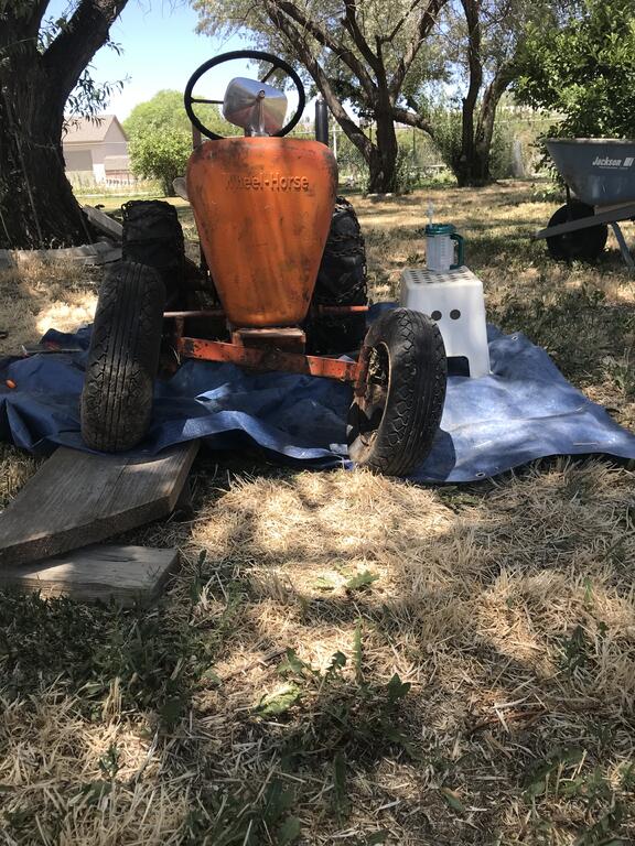

The Freightliner Guy 1,363 #1 Posted July 22, 2022 Hey guys I’m looking for new rims but I want them to be the same type 2 Share this post Link to post Share on other sites

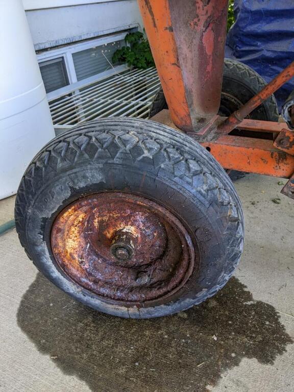

Kenneth R Cluley 659 #2 Posted July 22, 2022 Did something lift a leg on that rim or is it coming from inside? 3 Share this post Link to post Share on other sites
The Freightliner Guy 1,363 #3 Posted July 22, 2022 (edited) What do you mean by that. Oh I know what you mean but no people have told me it’s like calcium or something like that Edited July 22, 2022 by The Freightliner Guy 2 Share this post Link to post Share on other sites
The Freightliner Guy 1,363 #4 Posted July 22, 2022 It’s been rained and snowed on for 14 years plus Share this post Link to post Share on other sites
wallfish 19,258 #5 Posted July 22, 2022 Originals were filled for weight and the calcium chloride they used eats the rims. Original RJ rims are hard to find because everyone else's have rotted too. Take them off and measure the bore through the middle. Find some 8" rims that are close. Did you fix the steering or work on that engine yet? 1 1 Share this post Link to post Share on other sites

wallfish 19,258 #7 Posted July 22, 2022 Roll it away from wherever it is then. We're all allergic, THEY HURT! Unless they're those nasty white face aggressive hornets, they won't do anything unless you disturb the nest or get to close for a long time. Fix the steering pin. get a belt and get the engine running. It'll still drive on those old fronts. How are going to know everything you need for parts if ya don't take it a part and look at things? You won't need front rims if the engine never runs or the trans is toast. You're gonna need to get your hands dirty to get that baby going again! Try putting an ad in the classified section for stuff too. Best to drain that old crap out of that trans and flush it with kerosene or diesel fuel then fill with new gear oil. There are snap ring clips on the end of the spindles to get the rims off. You'll need to knock out the bearings with a bar and hammer to get those out. 2 1 Share this post Link to post Share on other sites

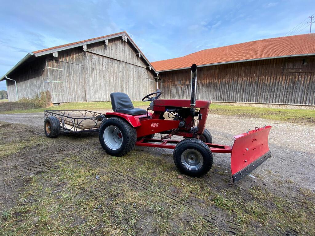

Tractorhead 9,216 #14 Posted July 25, 2022 On 7/22/2022 at 8:18 PM, wallfish said: Originals were filled for weight and the calcium chloride they used eats the rims. Original RJ rims are hard to find because everyone else's have rotted too. Take them off and measure the bore through the middle. Find some 8" rims that are close. Did you fix the steering or work on that engine yet? I purchased a set of brand new Rims for my 656 at this Source https://radundrolle.de/seiten/Felgen/Stahlfelgen/Kugelllager-Felge_450Ax6.htm The 8“ Rims fits perfectly and they be Ballbearing types. Stahlfelge 5.50Ax8 mit Kugellagern, Rollenlagern, Gleitlagern oder Antrieb unfortunately I can't tell if they sell it and ship it to the states, but it's still worth asking. Shipping to the States can be arranged. 3 1 Share this post Link to post Share on other sites

Tractorhead 9,216 #18 Posted July 25, 2022 5 hours ago, The Freightliner Guy said: Surprisingly all the gears are still existent and Trany does work perfectly That sounds to a 100 Points like mine was. i let them sandblasting and powdercoating. I ordered this with the same color like the Frontwheel was, but they coated them in RAL Aluminum - for me the wrong color, but however, they been well protected for my Needs and the next Century. And i find it doesn‘t look too bad either. 1 Share this post Link to post Share on other sites
