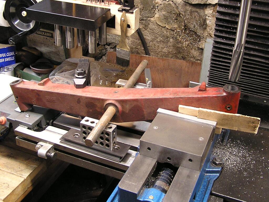

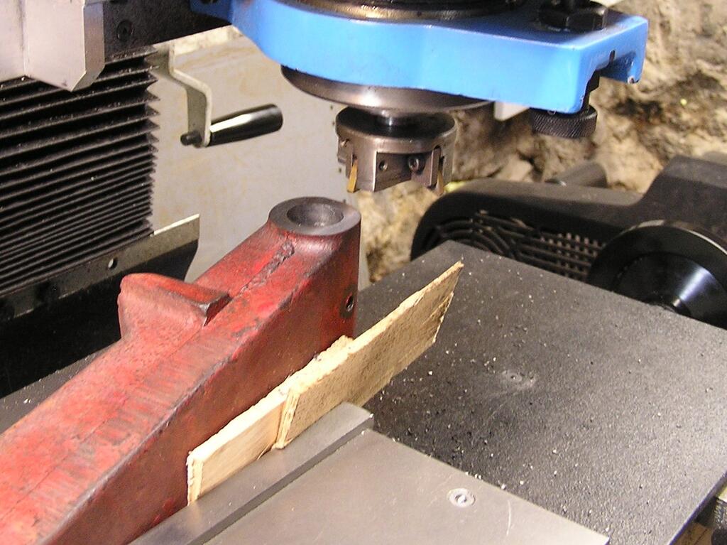

ri702bill 11,245 #2 Posted July 18, 2022 You may wish to raise up the front of the tractor by the frame and remove the pivot pin. Reproduction pins are available, as well as good used. IF the cast iron axle bore is wallowed out, it can be machined and sleeved for press in bronze bushings. IF the back boss is chewed up, it too can be machined down a bit and thin steel washers added to take up the play - I have done a few, and the spindle bores that way, machining the lower bosses down to add thrust washers. Bill 3 Share this post Link to post Share on other sites
