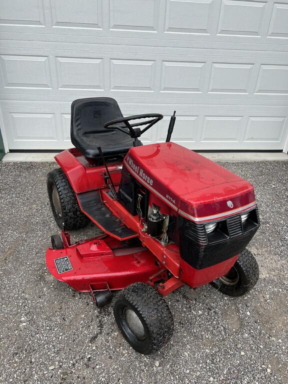

Prestons Hobby 76 #1 Posted July 18, 2022 Hello there. Yes, I am new to the group but look forward to tapping into the knowledge that I believe is here. I recently purchased 7 wheel horse tractors of various eras. One of these being a 211-A model. After a little bit of work I was able to get the girl up and running again and looking good but…. The only snag I have run into that I can not get a grip on is how the mower deck attaches to the tractor. The front of the deck is pretty simple and self explanatory. The back however was hung by a rope when I got it which I am guessing was not factory equipment. Any help finding a diagram or explanation of how this is supposed to attach would be greatly appreciated. Thank you 1 Share this post Link to post Share on other sites
gwest_ca-(File Mod) 12,015 #2 Posted July 18, 2022 Welcome to Red Square. There may be some info in these 6 files. Sorry we do not have an operator manual for the deck. https://www.wheelhorseforum.com/search/?q=05-42SB04&quick=1&type=downloads_file 2 Share this post Link to post Share on other sites

Prestons Hobby 76 #4 Posted July 18, 2022 Ok so…. As I stated, I am new on here and after looking at the entire list of files you provided I have a better idea of how the mower deck is supposed to look. The bracket on the back of mine is definitely different or was broken off a long time ago. It is referenced in one of your files so hopefully I can locate that mounting bracket and then I might be able to make more sense of how it goes together so long as I am not missing parts from the tractor side. Thank you again for your help. Very much appreciated Share this post Link to post Share on other sites
