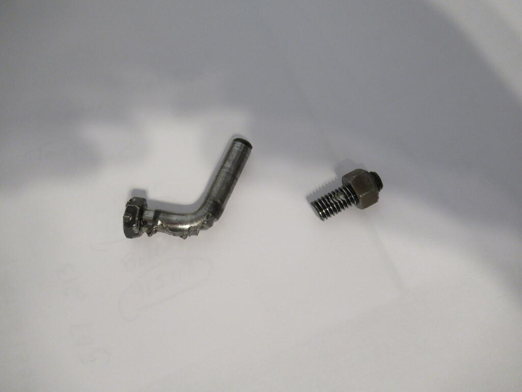

oldlineman 1,654 #7 Posted July 17, 2022 I had the same issue with a 1989 414 8 one of the diff bolts broke and was contacting the diff case inside bending the bolt. It would lock up then I could rock it back and forth and it would free up. I think you need to split the case and see what's up. Here's what I found only other damage was one of the diff. ends ( 4-19 ) was cracked were the bolts go through the differential. Good luck Bob 1 Share this post Link to post Share on other sites
"Manic-Mechanic" 1,485 #8 Posted July 17, 2022 39 minutes ago, oldlineman said: I had the same issue with a 1989 414 8 one of the diff bolts broke and was contacting the diff case inside bending the bolt. It would lock up then I could rock it back and forth and it would free up. I think you need to split the case and see what's up. Here's what I found only other damage was one of the diff. ends ( 4-19 ) was cracked were the bolts go through the differential. Good luck Bob scary thoughts running all through my mind! Lol Share this post Link to post Share on other sites
oldlineman 1,654 #9 Posted July 17, 2022 Wasn't a difficult repair with the help of great people here. As your saying goes, Never give up, I believe that Phil. 4:13 is very true! Bob 1 Share this post Link to post Share on other sites
