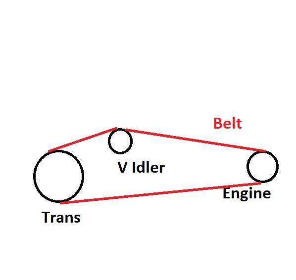

kitkit 137 #1 Posted July 14, 2022 I just got a c 125 8 speed and need to know does the idler pulley to the trany drive belt run on top or under the belt mine is gone thank you Share this post Link to post Share on other sites
Jeff-C175 7,207 #2 Posted July 14, 2022 (edited) 4 hours ago, kitkit said: I just got a c 125 8 speed and need to know does the idler pulley to the trany drive belt run on top or under the belt mine is gone thank you My bad... wrong advice, sorry! Edited July 14, 2022 by Jeff-C175 1 Share this post Link to post Share on other sites
wallfish 19,374 #3 Posted July 14, 2022 (edited) 2 hours ago, Jeff-C175 said: The idler pulley is a flat idler. The flat side of the belt goes UNDER the idler pulley. 8 speeds use a V-pulley idler positioned on the inside of the drive belt loop. (under) Not a Flat idler on the outside or top like a hydro tractor does. The belt will run on top of the V idler Edited July 14, 2022 by wallfish 2 Share this post Link to post Share on other sites

SylvanLakeWH 30,629 #5 Posted July 14, 2022 1 hour ago, wallfish said: 8 speeds use a V-pulley idler positioned on the inside of the drive belt loop. (under) Not a Flat idler on the outside or top like a hydro tractor does. Share this post Link to post Share on other sites
kitkit 137 #6 Posted July 14, 2022 Thank you all for the information , I was having trouble finding a drawing of it in the mauals . Share this post Link to post Share on other sites

daveoman1966 3,882 #10 Posted July 14, 2022 The OEM 'V' idler pulley for the C-125 is #7451...revised to # 95-7668. Find it on Ebay or at dealers for about $25. It is 4" diameter with a 3/8" hub...with standoff of 1/16" or so. parfts tree would be a source. Share this post Link to post Share on other sites
