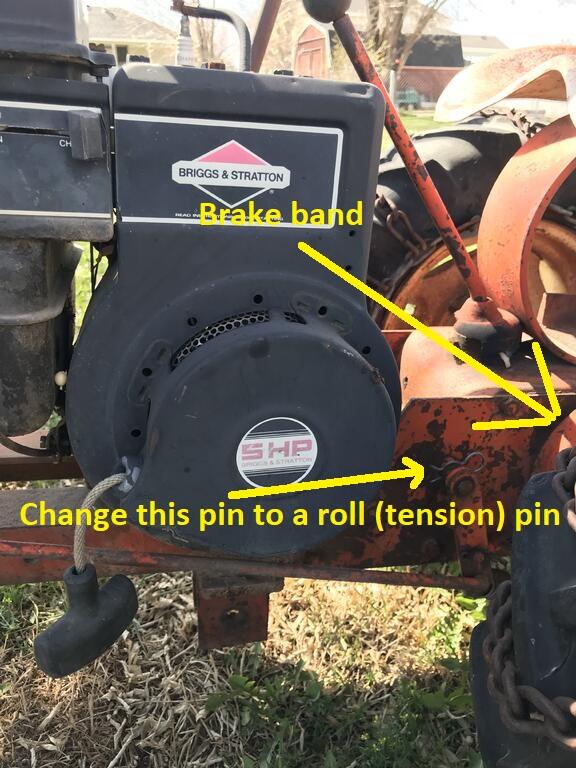

wallfish 20,618 #78 Posted July 14, 2022 4 hours ago, The Freightliner Guy said: Ok I’ll get those as soon as I can but I might end up rounding the bolts hopefully not though A 6 point socket and a an impact should turn'm right out. A ratchet will work too but using a 6 point socket is the best for some old hardware. The brake band should be located on the left side of the trans and connected with the pedal linkage 1 1 Share this post Link to post Share on other sites

wallfish 20,618 #85 Posted July 14, 2022 The foot pedal is pushed. It will release the belt first (clutch) and then engage the brake band to the brake drum. 1 1 Share this post Link to post Share on other sites

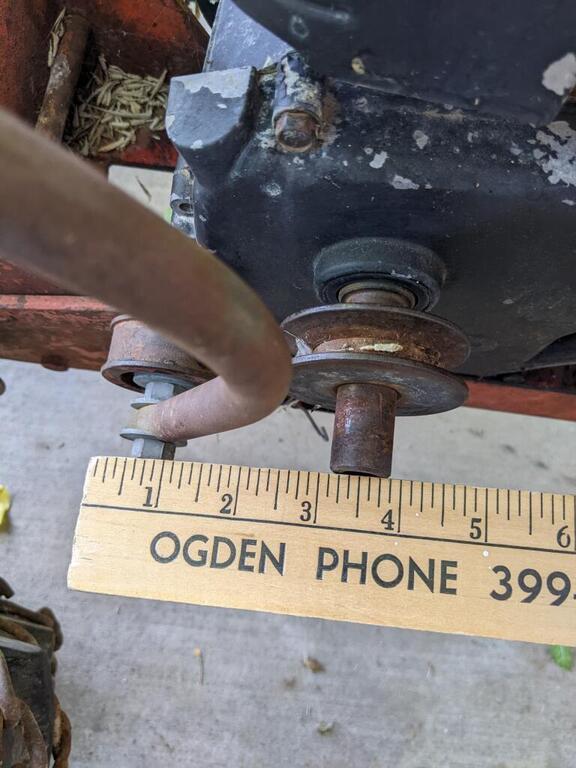

The Freightliner Guy 1,364 #87 Posted July 17, 2022 That’s how big the drive pulley is but I don’t know what dimension of drive belt I need and I want to make sure I have the right size belt 1 Share this post Link to post Share on other sites

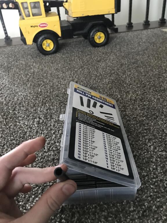

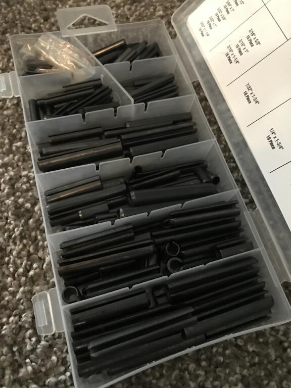

The Freightliner Guy 1,364 #90 Posted July 31, 2022 Also I got the roll pin set @wallfish told me to get 1 Share this post Link to post Share on other sites
The Freightliner Guy 1,364 #91 Posted July 31, 2022 3 Share this post Link to post Share on other sites
D_Mac 9,339 #92 Posted July 31, 2022 What I do when I come across an issue I haven't addressed yet is that I YouTube it. There are alot of helpful videos for just about every problem you are going to come across. I watch a couple videos then go at it. Trial-and-error is the best teacher. Watching a video also helps me to understand the instructions. I learn better by watching it done then someone trying to explain it. 3 1 Share this post Link to post Share on other sites
