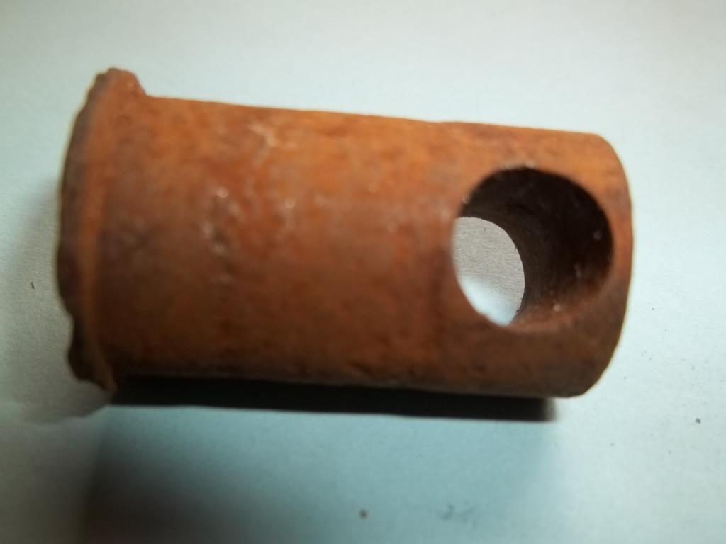

953 nut 70,654 #32 Posted July 11, 2022 10 minutes ago, The Freightliner Guy said: I don’t got a pic sorry but it’s a pin that goes in the steering shaft all the way at the front so the steering wheel turns fine cuz there’s no pin in it so it can turn the tires If this is the pin you are missing you can make one by welding/brazing a washer on the end of some round rod of the correct size. 2 Share this post Link to post Share on other sites

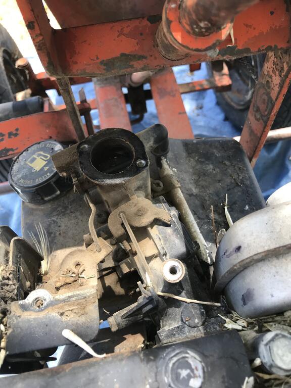

The Freightliner Guy 1,364 #33 Posted July 11, 2022 1 Share this post Link to post Share on other sites
The Freightliner Guy 1,364 #34 Posted July 11, 2022 Look down at the steering colom that’s where the snapped pin was 1 Share this post Link to post Share on other sites
The Freightliner Guy 1,364 #35 Posted July 11, 2022 Where that box thing is right about there 1 Share this post Link to post Share on other sites
The Freightliner Guy 1,364 #36 Posted July 11, 2022 And when the snapped pin came out it had a bend in the middle so I don’t think the holes can be aligned cuz I tried shoving a thic nail in ther hole and it wouldn’t fit 1 Share this post Link to post Share on other sites
The Freightliner Guy 1,364 #37 Posted July 12, 2022 I think when the pin snapped it left a small piece in it 1 Share this post Link to post Share on other sites

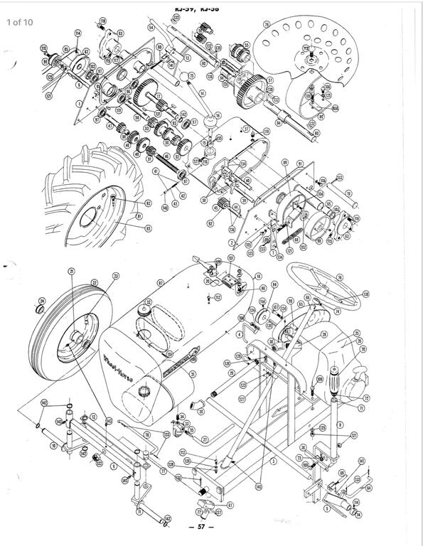

Pullstart 71,561 #38 Posted July 12, 2022 On 7/11/2022 at 1:11 PM, Pullstart said: You can learn quite a bit from the manual. Here is the illustrated parts list from the link I posted. Maybe it would help us determine what pin we’re talking about? 2 1 Share this post Link to post Share on other sites
The Freightliner Guy 1,364 #39 Posted July 12, 2022 I’ve seen this before 1 Share this post Link to post Share on other sites
The Freightliner Guy 1,364 #40 Posted July 12, 2022 On the diagram part 37 is the part that snapped on my rjs steering 1 Share this post Link to post Share on other sites
The Freightliner Guy 1,364 #41 Posted July 12, 2022 The part that looks like a pin at the bottom of the diagram is the part I snapped 1 Share this post Link to post Share on other sites
The Freightliner Guy 1,364 #42 Posted July 12, 2022 Which ever one that is at the bottom that has a 7 in the number that’s the pin the snapped 1 Share this post Link to post Share on other sites

wallfish 20,744 #46 Posted July 12, 2022 Then someone redrilled it. The holes should all line up to hold the block to the steering shaft. It needs to go straight through the whole thing. 1 minute ago, The Freightliner Guy said: And there’s not really room for a hammer Disconnect the steering link and turn it so you can get to it from the bottom. The hole will face down 1 1 Share this post Link to post Share on other sites
The Freightliner Guy 1,364 #47 Posted July 12, 2022 The thing is that I don’t know how to disconnect it cuz it’s like welded 1 Share this post Link to post Share on other sites
The Freightliner Guy 1,364 #48 Posted July 12, 2022 Here I’m having my grandma take a pic for me cuz it’s in their back yard 1 Share this post Link to post Share on other sites
wallfish 20,744 #49 Posted July 12, 2022 44 minutes ago, The Freightliner Guy said: The thing is that I don’t know how to disconnect it cuz it’s like welded Mother nature brown weld. It's rusted 1 Share this post Link to post Share on other sites
