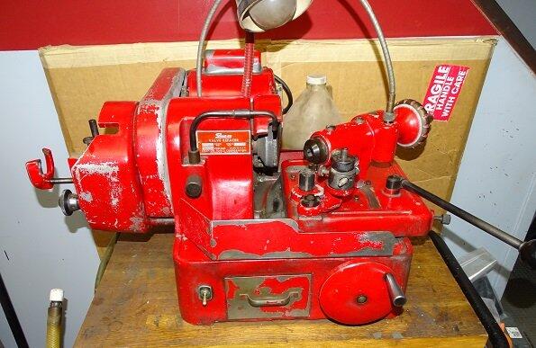

857lover 291 #10 Posted July 11, 2022 4 hours ago, squonk said: Did you grind the valve stems to set clearance? no i have not messed with it how do you do that ?? Share this post Link to post Share on other sites
squonk 46,115 #11 Posted July 11, 2022 First is it even an ACR engine? Is the cam 1 piece or 2 piece? I suggest you read these threads and download the repair manual. Share this post Link to post Share on other sites
rmaynard 17,105 #12 Posted July 11, 2022 Check the valve clearance with a feeler gauge. If the gap is too tight or non-existent, the valve in question must be removed and the bottom of the stem carefully ground to achieve the proper gap. Usually done at a machine shop, or if you have the correct equipment you can do it yourself. It's a trial and error. 1 Share this post Link to post Share on other sites
Handy Don 16,278 #13 Posted July 11, 2022 1 hour ago, rmaynard said: It's a trial and error Or, more hopefully, a trial and success! 2 Share this post Link to post Share on other sites
857lover 291 #14 Posted July 11, 2022 7 hours ago, rmaynard said: Check the valve clearance with a feeler gauge. If the gap is too tight or non-existent, the valve in question must be removed and the bottom of the stem carefully ground to achieve the proper gap. Usually done at a machine shop, or if you have the correct equipment you can do it yourself. It's a trial and error. i will have to clearance intake aswell too then Share this post Link to post Share on other sites
richmondred01 2,360 #15 Posted July 13, 2022 (edited) The valve stems must be ground on a valve stem/facing grinder. Don’t think that you can get a level cut on your bench grinder or using a file. Edited July 13, 2022 by richmondred01 3 Share this post Link to post Share on other sites
