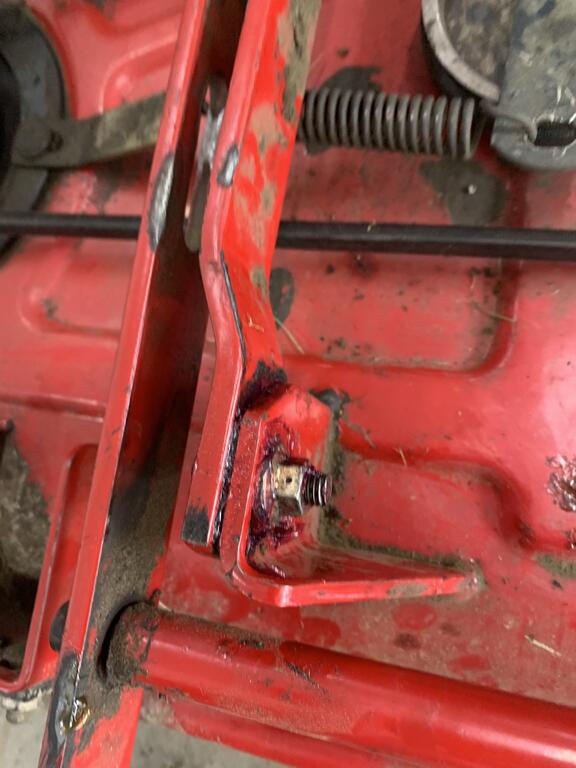

Tooomuch7 52 #8 Posted July 16, 2022 I’m hoping this was the problem,the bolt pictured here fell out also the bushing. I made a bushing for it,I will find out when I put the deck back on. 1 Share this post Link to post Share on other sites
