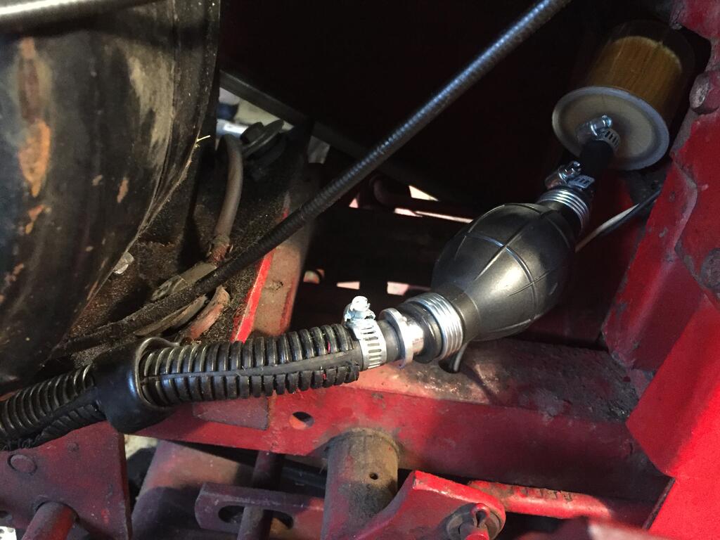

Ed Kennell 44,096 #4 Posted July 8, 2022 Install a marine primer bulb in the fuel line. The fuel pump is probably losing it's prime. A couple squeezes will prime the fuel pump and carb making for an easy start. 6 Share this post Link to post Share on other sites

SylvanLakeWH 30,164 #10 Posted July 8, 2022 (edited) 1 hour ago, Ed Kennell said: Install a marine primer bulb in the fuel line. The fuel pump is probably losing it's prime. A couple squeezes will prime the fuel pump and carb making for an easy start. Have that on my C 105. Works great!!! Edited July 8, 2022 by SylvanLakeWH 1 Share this post Link to post Share on other sites

JRess 12 #14 Posted July 8, 2022 Thanks all. Did pull the carb and the bowl was bone dry. I appreciate the pic of the marine primer and think I will go in that direction if cleaning the carb doesn't work. Adding an electric pump is probably above my comfort level. I will let all know how it works out. 1 Share this post Link to post Share on other sites
davem1111 2,262 #15 Posted July 8, 2022 44 minutes ago, JRess said: Thanks all. Did pull the carb and the bowl was bone dry. I appreciate the pic of the marine primer and think I will go in that direction if cleaning the carb doesn't work. Adding an electric pump is probably above my comfort level. I will let all know how it works out. If you end up needing to do the fuel pump replacement, it's not very difficult. Here is a picture of one I did. Not the most optimal or attractive location, but it works. You might need to buy some 1/4" fuel line depending on how you re-route the lines. Good idea to replace the lines all the way to the tank, filter(s) (I put one back near the tank and another up front), and maybe the shutoff valve & grommet at the tank while you're at it. I don't remember if you said you were getting fuel through the line all the way to the carb, but I've seen shutoff valves go bad and not open too... 3 Share this post Link to post Share on other sites
