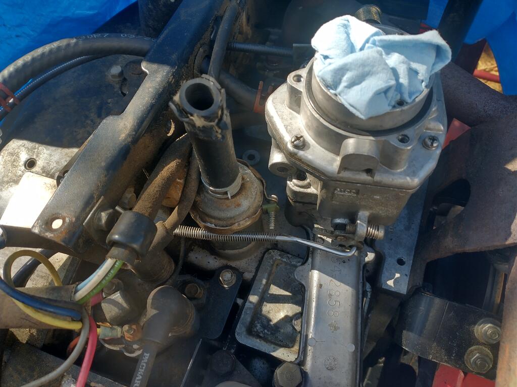

23 Reo 232 #1 Posted July 8, 2022 Bought my first Onan, a 416 with the P216. I am going through it before it runs. I took the carb off and cleaned it and put everthing back together. Only one problem. When I reinstalled the throttle linkage the carb butterfly is pinned at full throttle. The throttle controle is unresponsive. I did not loosen the throttle cable adjustment until after I noticed that the throttle was pinned. Is this what they call the Onan blues? Any advise. 1 Share this post Link to post Share on other sites
Achto 30,486 #2 Posted July 8, 2022 (edited) The butterfly will be held wide open by the governor until the engine starts. No matter where you set the throttle. As long as you can move the butterfly open & closed freely by moving the governor by hand you should be OK, Edited July 8, 2022 by Achto 1 1 1 Share this post Link to post Share on other sites
WHX?? 53,754 #3 Posted July 8, 2022 Onan blues are when she pops a valve seat ... sounds like you just may not have the linkage set as should. I take pics of how is was before I took apart. Still may not be right but gives me a starting point. 2 1 Share this post Link to post Share on other sites

23 Reo 232 #5 Posted July 8, 2022 Thank you, Dave 1 Share this post Link to post Share on other sites

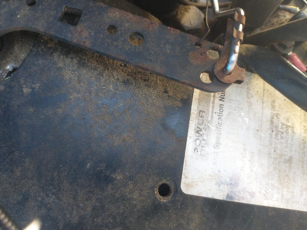

lynnmor 8,384 #6 Posted July 8, 2022 Looks like you have the linkage in the wrong bend, see photo for the correct position. 1 1 Share this post Link to post Share on other sites
