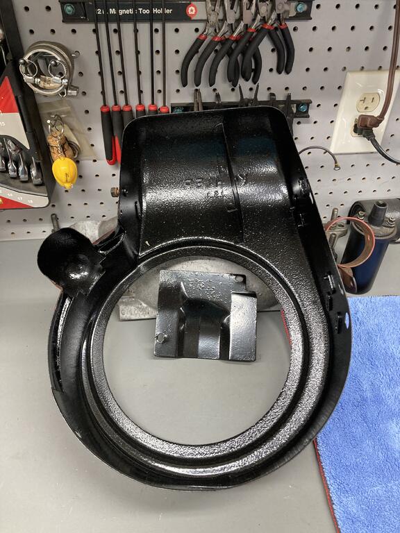

Blasterdad 3,045 #13 Posted July 8, 2022 Air blast under flywheel too, spray motor down with bleach. Mouse urine will attract more, I had to sandblast & paint the inside of these tins to get rid of the stench. When storing put a bar of Irish Spring soap on top of the engine, mice hate it. 2 Share this post Link to post Share on other sites
