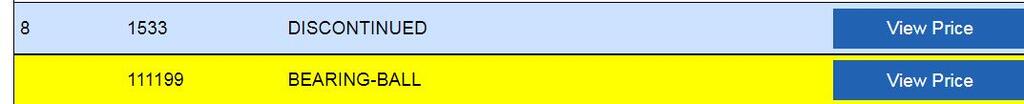

DeepH2O 66 #1 Posted July 7, 2022 I’m ordering all new bearings for my 1989 312-8 w/ 8 speed. I’m having a hard time finding if I 100% have the 1533 or the 111199. The Toro Master Parts viewer says 111199. Could someone else help me verify? Thanks!! Share this post Link to post Share on other sites

gwest_ca-(File Mod) 11,848 #6 Posted July 7, 2022 111199 did not replace the 1533 bearing. Toro changed the bearings used and some are listed here. Click on the fuzzy picture to see 1" axles 1-1/8" axles 1 1 Share this post Link to post Share on other sites
DeepH2O 66 #7 Posted July 8, 2022 12 hours ago, gwest_ca said: 111199 did not replace the 1533 bearing. Toro changed the bearings used and some are listed here. Click on the fuzzy picture to see 1" axles 1-1/8" axles Darn! It doesn’t list the one for my model 1989 312-8 model 21-12K806 Share this post Link to post Share on other sites
gwest_ca-(File Mod) 11,848 #8 Posted July 8, 2022 The bearing change happened in 1986 so 1989 should have the 111199 bearings. When the change happened the transmission model number did not change but the tractor model number did change. Share this post Link to post Share on other sites
DeepH2O 66 #9 Posted July 8, 2022 7 minutes ago, gwest_ca said: The bearing change happened in 1986 so 1989 should have the 111199 bearings. When the change happened the transmission model number did not change but the tractor model number did change. I measured my axle with a digital caliper and came up with 1””. I wish I could pick up the phone and call Lowell. I’m over seas and rarely get opportunity to use phone. I would like to order now so it’ll be there when I get home. Thanks for y’all’s help!! Share this post Link to post Share on other sites
