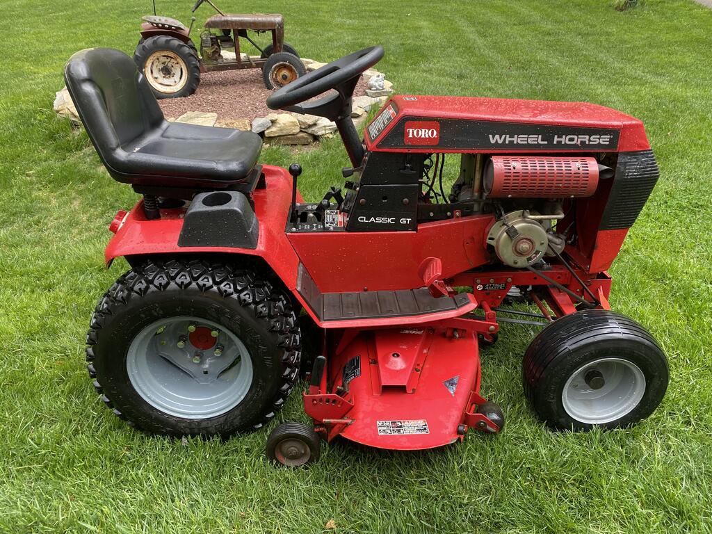

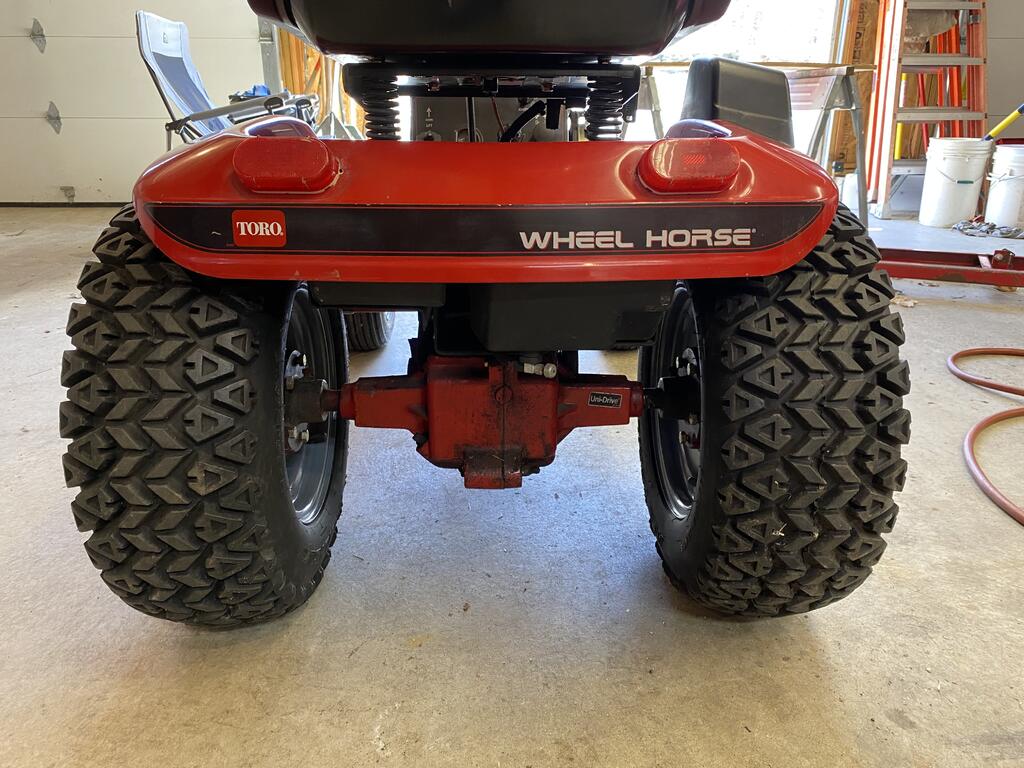

Sparky-(Admin) 23,903 #13 Posted July 6, 2022 27 minutes ago, Heatingman said: See lots of pictures with the AG type tires on garden tractors in the rear. Wont those really tear up a lawn? I’m sure these guys here are sick of seeing pics of my favorite rear rubber, but these always get my vote AND…they will fit on your current rear wheels. I present my 23x8.00x12 Carlisle All-Trails: 6 Share this post Link to post Share on other sites

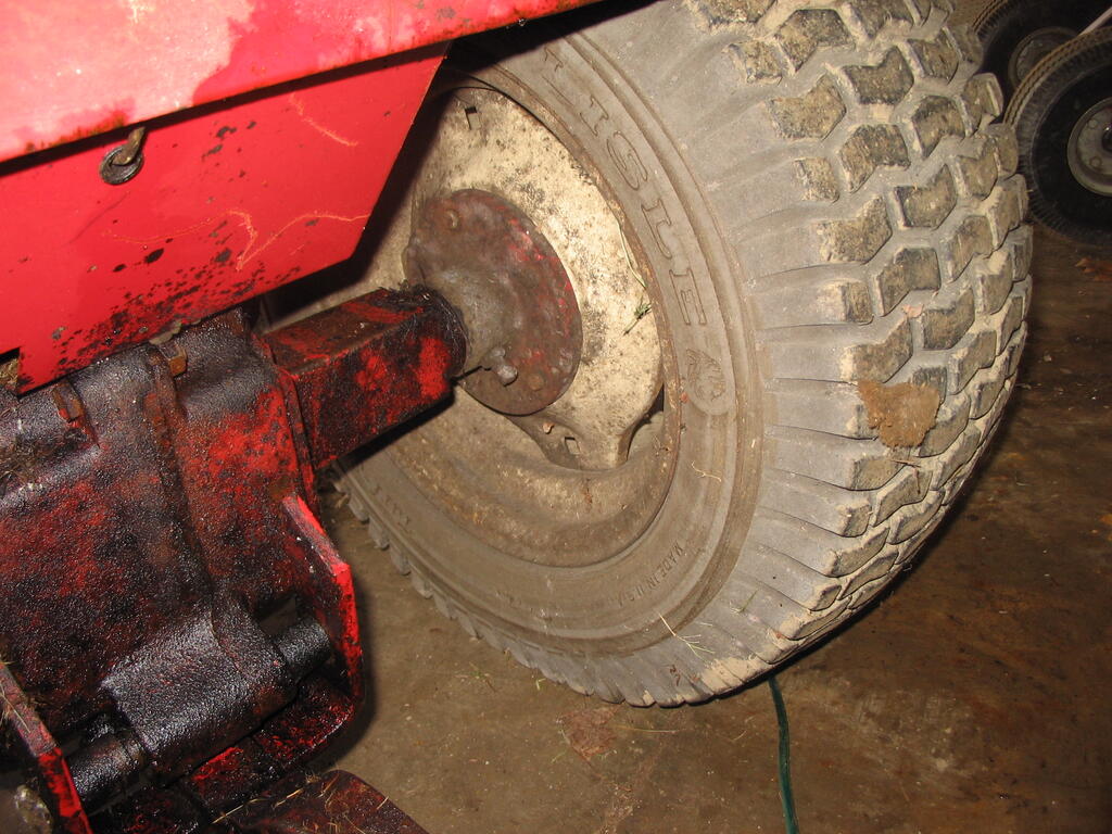

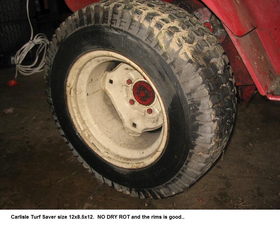

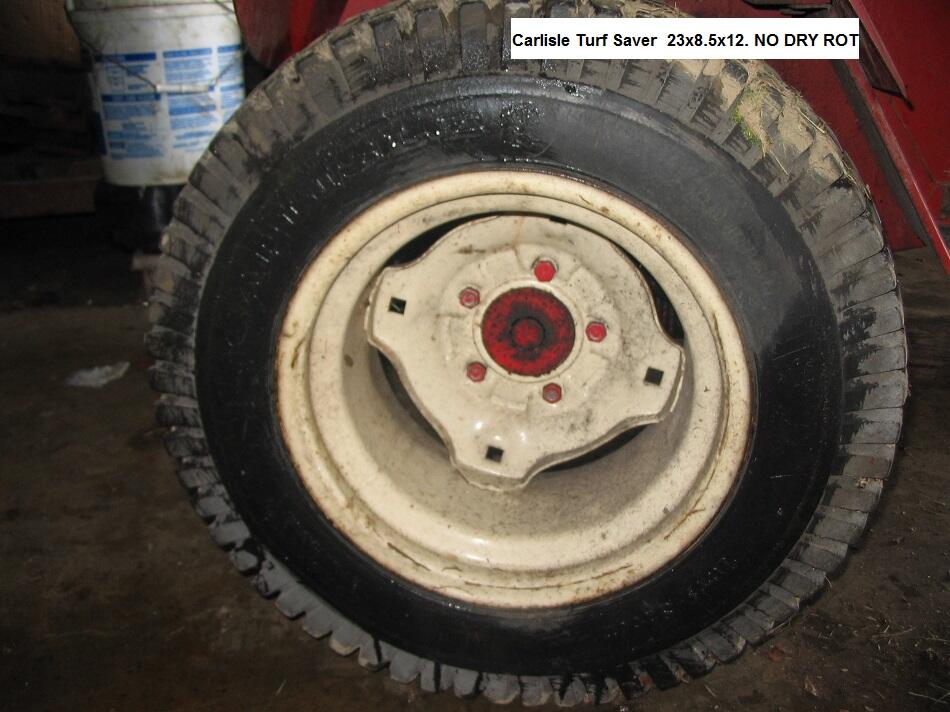

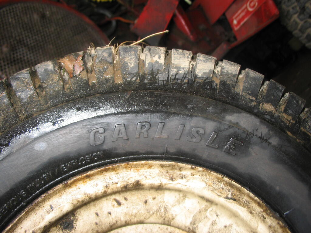

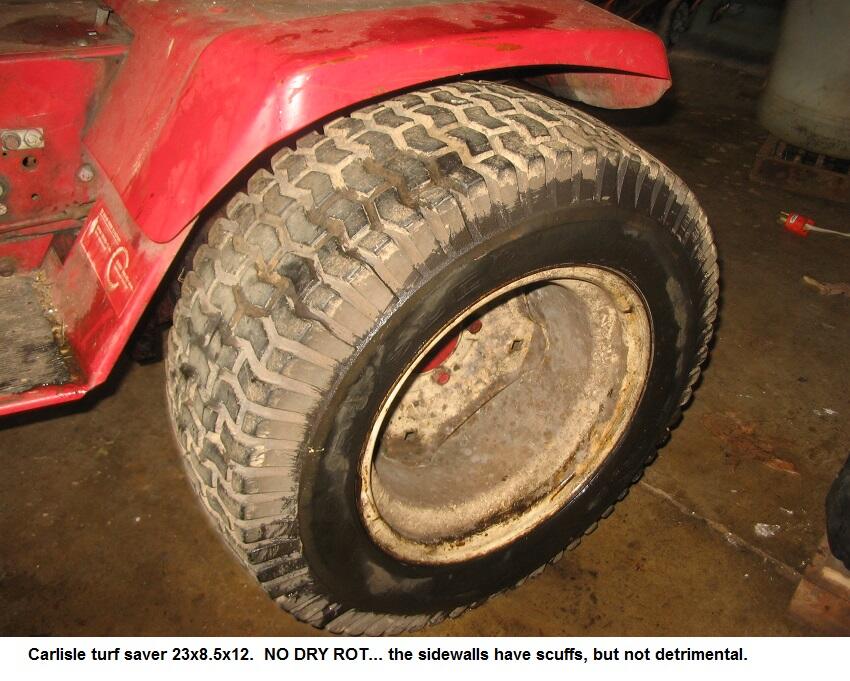

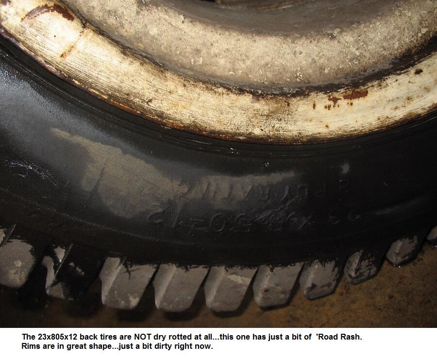

daveoman1966 3,880 #17 Posted July 7, 2022 (edited) I have a pair of CARLISLE Turf-Saver 23x8.5x12 ...ON RIMS.. I took the C-120 Auto in for parts and these tires look fairly new.. No dry rot at all on these rear tires....with only scuff marks on the sidewall of one. $145...no shipping. Come and get 'em with cash in hand. ((Recently sold the NEW front tires (on rims) 16x6.5x8.)) Edited July 7, 2022 by daveoman1966 2 Share this post Link to post Share on other sites

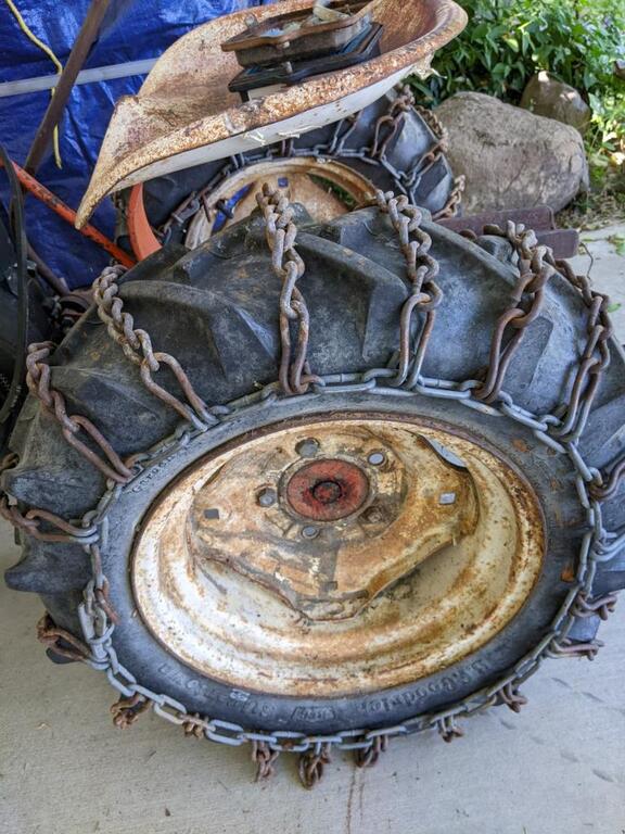

Capespencer68 3 #18 Posted July 25, 2022 On 7/6/2022 at 6:41 PM, Sparky said: I’m sure these guys here are sick of seeing pics of my favorite rear rubber, but these always get my vote AND…they will fit on your current rear wheels. I present my 23x8.00x12 Carlisle All-Trails: Do you use chains on those tires, if so how is the clearance? Thanks 2 Share this post Link to post Share on other sites
The Freightliner Guy 1,363 #19 Posted July 25, 2022 Clearance for me is no prob with chains because I have no fenders 2 2 Share this post Link to post Share on other sites
The Freightliner Guy 1,363 #20 Posted July 25, 2022 (edited) But chained tires have some slack so at speeds the chains would wear away your fenders because they get flinged up so chained tires probably a no go Edited July 25, 2022 by The Freightliner Guy 1 1 Share this post Link to post Share on other sites
ebinmaine 74,998 #21 Posted July 25, 2022 29 minutes ago, The Freightliner Guy said: But chained tires have some slack so at speeds the chains would wear away your fenders because they get flinged up so chained tires probably a no go I've got chains on at least three or four tractors and not one single one of them flings up. They're all properly installed. Stay tight. Don't move. 2 Share this post Link to post Share on other sites
The Freightliner Guy 1,363 #22 Posted July 25, 2022 Oh well mine have some slack because they’ve been on there for probably 30+ years but I could be wrong 1 Share this post Link to post Share on other sites
Rob J. 1,942 #23 Posted July 25, 2022 You try to size the chains with lower air pressure and after the chains are on right you add some air and snug em up. It’s what I do. 2 1 Share this post Link to post Share on other sites
Rob J. 1,942 #24 Posted July 25, 2022 25 minutes ago, The Freightliner Guy said: Oh well mine have some slack because they’ve been on there for probably 30+ years but I could be wrong Might be time for some new chains, they do wear out. 😉 1 1 Share this post Link to post Share on other sites
The Freightliner Guy 1,363 #25 Posted July 25, 2022 The back tires are full of air since it was parked in 2008 2 Share this post Link to post Share on other sites
