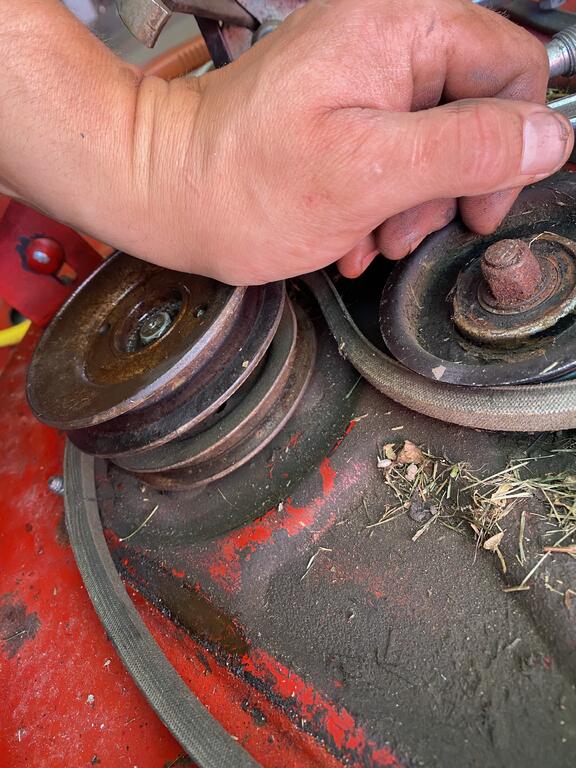

Whats the trick to getting the double pulley off the shaft?
standard puller worked for the 2 outboard pulleys, but this one must be different in some way, but Im not sure. Perhaps this one has a threaded shaft?
Already bent the lower grove on the pulley a bit, which I should be able to straighten out.
Want to get to the bearings to either replace them, or repack.
Heatingman

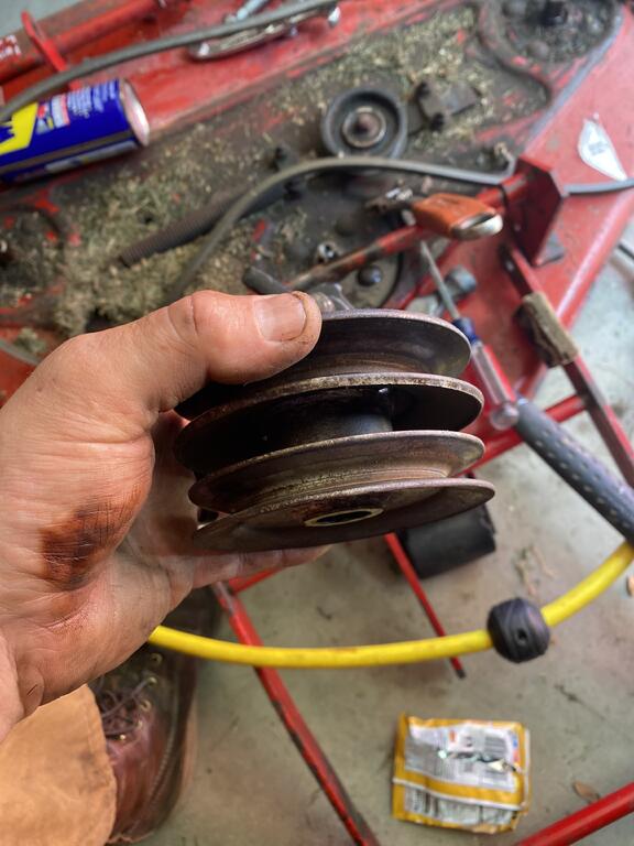

Got it. Standard pulley puller, added some tension, hammer the tension nut on the puller then turn a bit. Rinse and repeat. Trick I use on pump rebuilds at work.
Also let the shaft soak in wd for about 20 minutes.
now onto the bearings.
the pulley was a single piece.

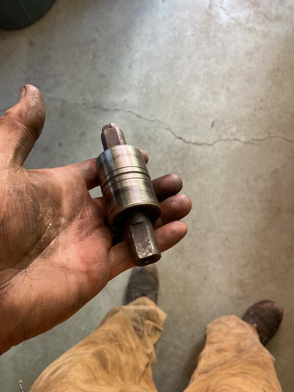

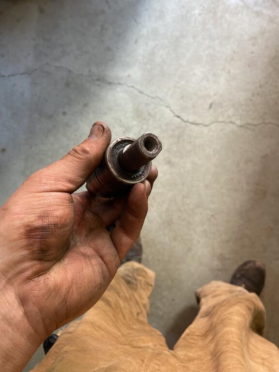

These bearings do not appear to be greasable, and from what I have found, the Toro 103119 part number has been discontinued.
I did find a vendor on ebay that either has a bunch of NOS, or reproduction.
for about 50 each.
Am I wrong to believe that they are not greasable/rebuildable?
I put it in the 12 ton press. If it does come apart, would need more press that I have.
Non serviceable.
on the other hand those bearings are have lasted that way for more than 30 years.
