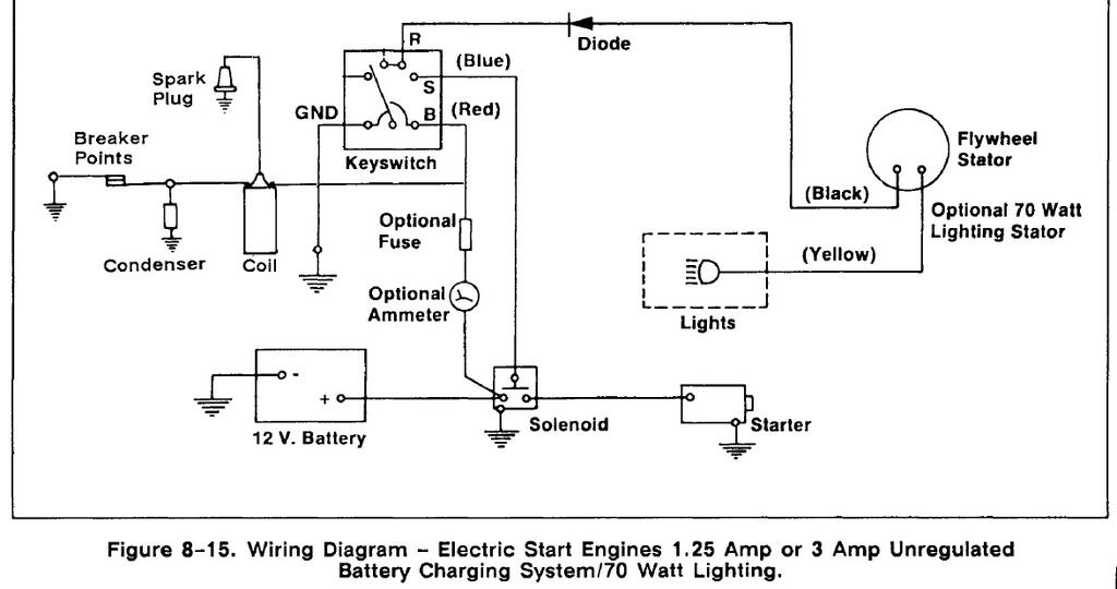

budman2 57 #1 Posted July 2, 2022 Have a 312-8 1985 model, having wire ing problem again. Replaced the diode as it was bad and now the wires get real hot when I plug them into the motor! afraid of burning it up so I disconnected the plug that goes to the engine and battery just to be safe! Can't figure out what I am doing wrong, any help would be appreciated, Thanks in advance budman2 again!!!!!!! Share this post Link to post Share on other sites
953 nut 63,985 #2 Posted July 3, 2022 Is your 312-8 still running the K-301 and a separate voltage regulator/rectifier? If that is the case be sure the two wires coming from the engine to the regulator are on the two AC terminals of the regulator and the wire to your ignition switch is on the B terminal. If it is the 15 amp regulator the AC wires will be side by side and the B terminal will be below them. 1 Share this post Link to post Share on other sites
gwest_ca-(File Mod) 11,986 #3 Posted July 3, 2022 Is the diode by chance installed backwards? Share this post Link to post Share on other sites
lynnmor 8,569 #4 Posted July 3, 2022 Any chance you installed the diode backwards? 1 Share this post Link to post Share on other sites
953 nut 63,985 #5 Posted July 3, 2022 Being the three amp DC charging system if the diode was inserted backward the battery voltage would be going directly through the stator to ground explaining the wire heating issue. If you are lucky you didn't cook the stator, however if the stator is burned up they aren't too bad a job to replace one. 1 Share this post Link to post Share on other sites
oldlineman 1,638 #6 Posted July 3, 2022 That's exactly what I was thinking. Share this post Link to post Share on other sites
