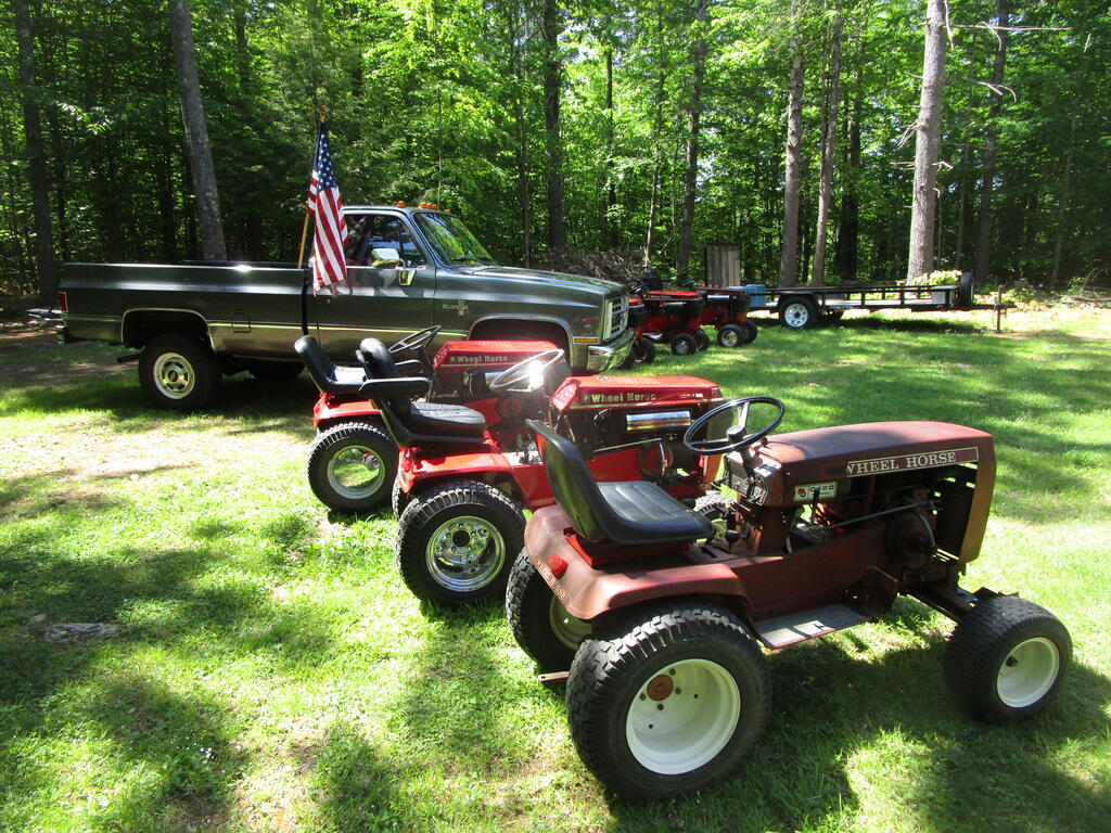

JCM 11,415 #26 Posted July 2, 2022 9 minutes ago, Bradshawn said: I got a Silverado. But that ranger is a good rig I got no hate for Ford! Someone say Silverado ? 1 Share this post Link to post Share on other sites
Bradshawn 49 #27 Posted July 3, 2022 4 minutes ago, JCM said: Someone say Silverado ? That’s a beaut of a truck! 1 1 Share this post Link to post Share on other sites
