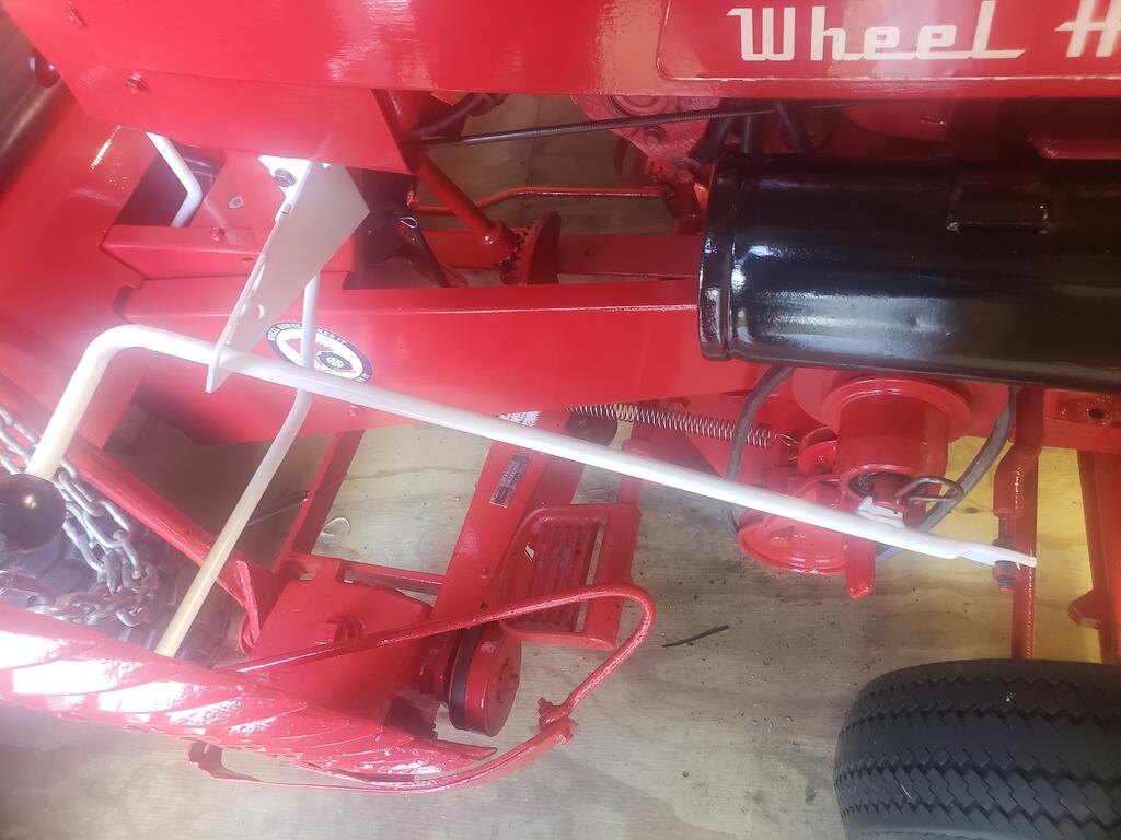

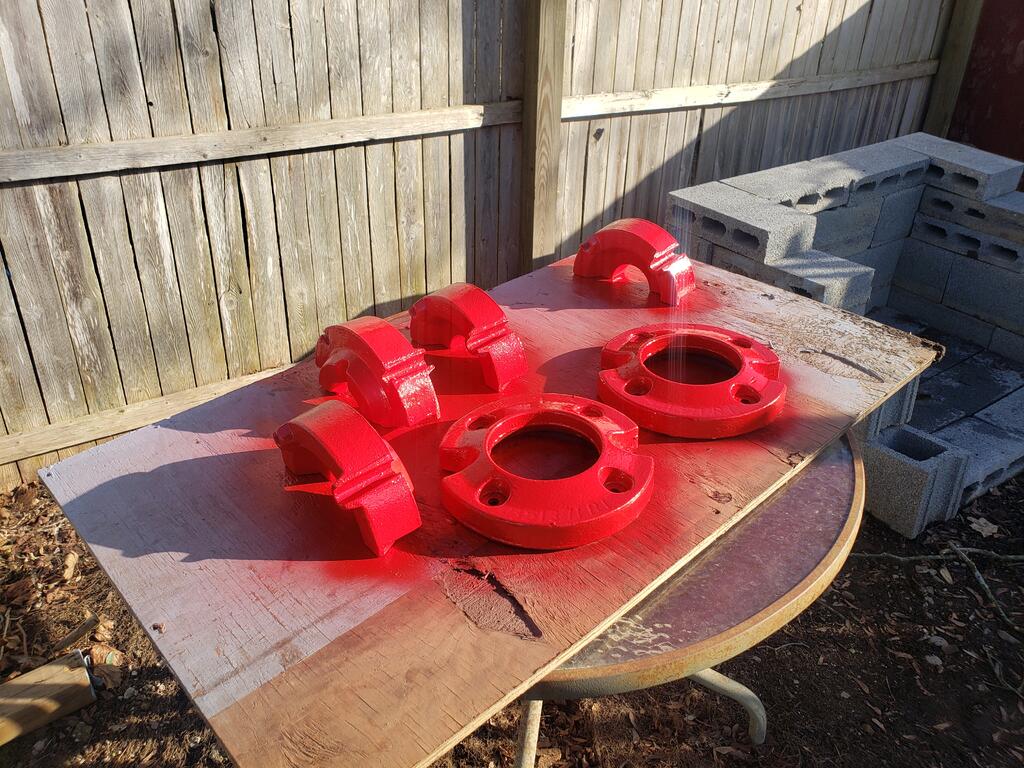

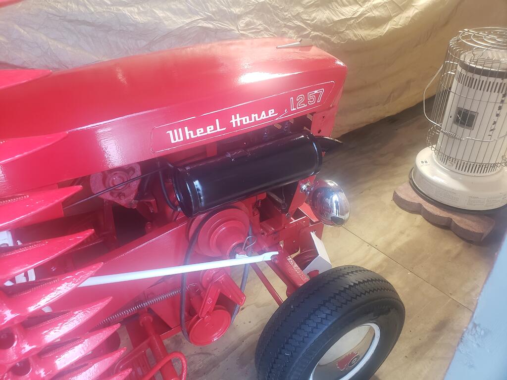

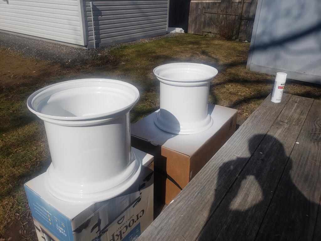

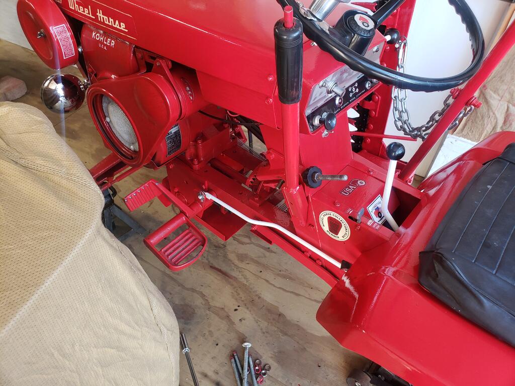

Thegearhead0324 1,842 #27 Posted February 15, 2023 Thought I'd do an update on the ol 1257. It hit 65 degrees today (feb 15th.).... only in upstate NY. I decided to paint up the wider rims I just got (used), going to buy new beefy tires next chance I get. Also re-painted the inner and outer wheel weights since they got banged around past few years. Also, I made a new coil-points wire, soldered some other wires, and threw in a little white paint on a few little things, for some reason I really like the white with the red. Oh and cant forget the muffler.... stack came off, this is from a 300 series i believe. Looks cleaner. I have more to do yet, but its coming along. 2 8 1 Share this post Link to post Share on other sites

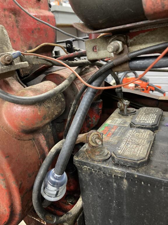

Thegearhead0324 1,842 #28 Posted February 16, 2023 I noticed while taking all the wheels off that it needs tie rods pretty bad, so plan on doing those as well. I must be getting older because more and more things start to bug me. The clear plastic fuel filter I just replaced last year already broke, where the filter element meets the plastic. Just rattling around while running, like really. Now I'm just going to run a nice and neat metal line with a filter in a different spot with less shaking. 2 Share this post Link to post Share on other sites

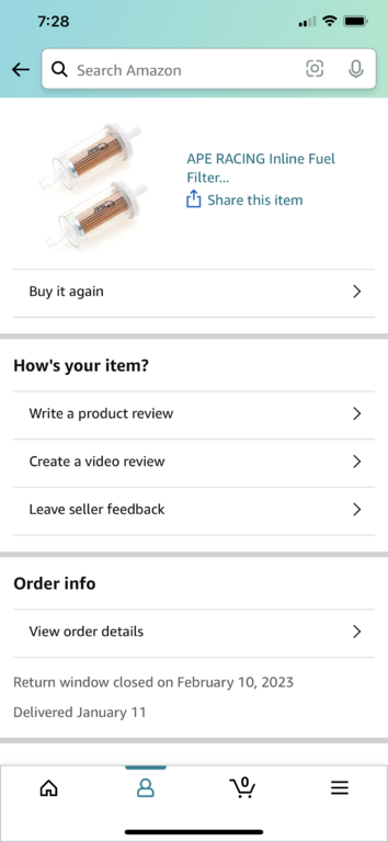

Tonytoro416 1,387 #29 Posted February 16, 2023 I got these APE RACING filters and also check valves from the jungle site and I was very happy with them. They are nice quality 2 Share this post Link to post Share on other sites

Blasterdad 3,168 #32 Posted February 16, 2023 8 minutes ago, Thegearhead0324 said: Thank you. I'll look into those filters, try to find one that doesn't come apart in less than a year. 1 hour ago, Thegearhead0324 said: The clear plastic fuel filter I just replaced last year already broke, where the filter element meets the plastic. Just rattling around while running, I quit using them for the same reason, I've had the "media" disintegrate also... I started using the ones with micro screen. 3 Share this post Link to post Share on other sites

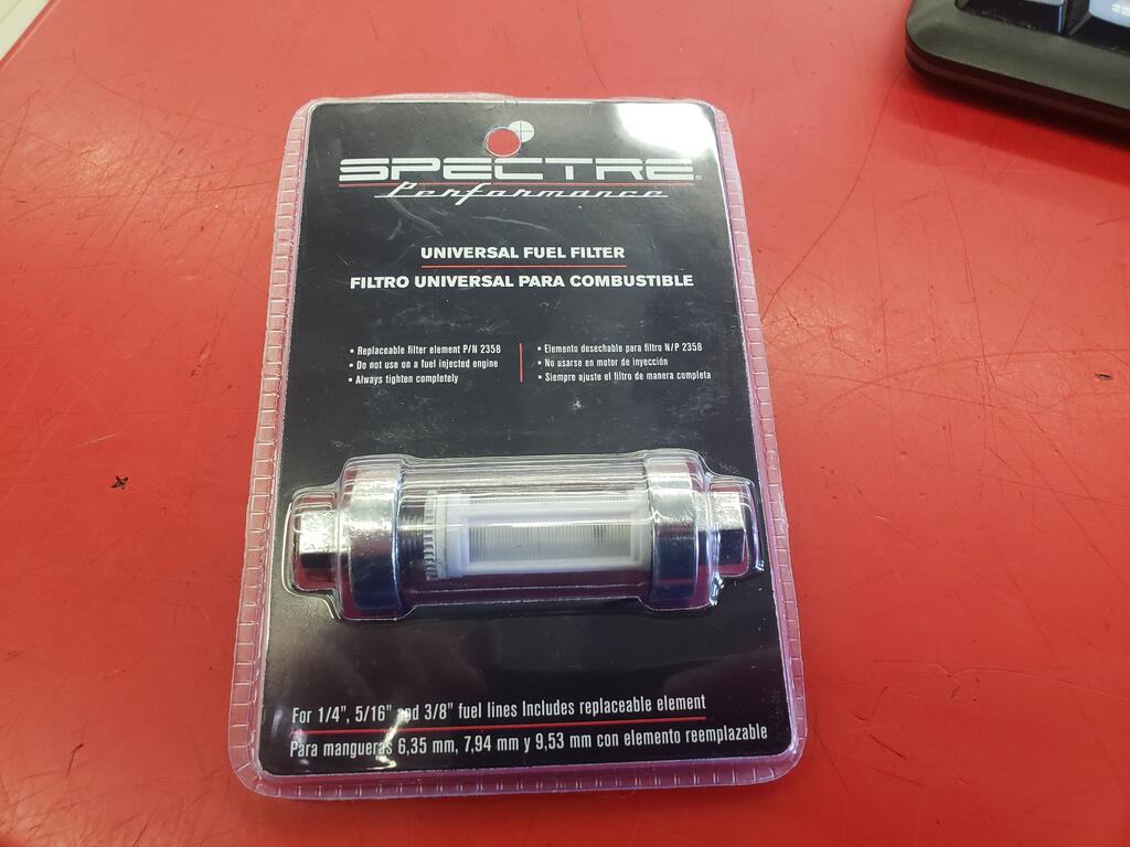

Thegearhead0324 1,842 #36 Posted February 16, 2023 25 minutes ago, ebinmaine said: Interesting you folks would bring up the fuel filter issue. Just last night I was setting parts aside to put on to one of my own tractors and I noticed that there's a HUGE difference in quality and fit and finish between a Stens brand and the generic I had laying there with it. I think I'm going to go with one of these filters, had all sizes so 1/4" is in it. 1 2 Share this post Link to post Share on other sites
ebinmaine 80,694 #37 Posted February 16, 2023 31 minutes ago, Thegearhead0324 said: I think I'm going to go with one of these filters, had all sizes so 1/4" is in it. I like that idea. Extra protection and extra chrome. Bonus. I'd like to see a couple pictures of your setup when it's done. 1 Share this post Link to post Share on other sites

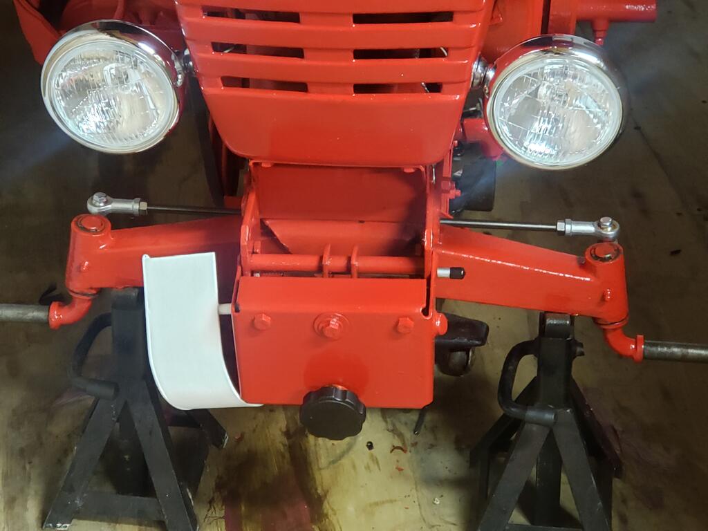

Thegearhead0324 1,842 #41 Posted March 5, 2023 The ol 1257 got new home made tie rods (with greasable ends of course.) 3 3 Share this post Link to post Share on other sites

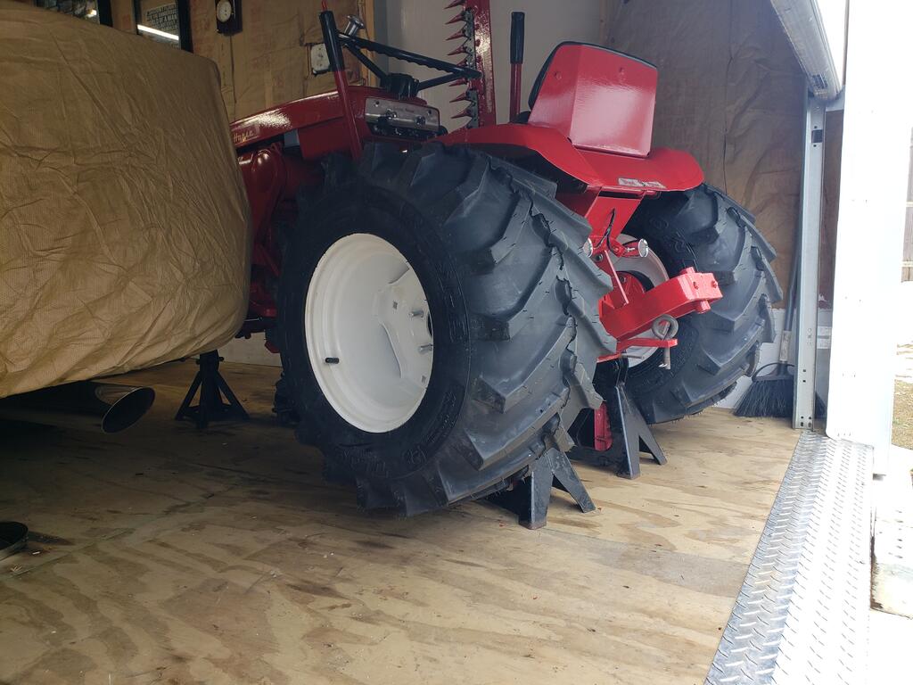

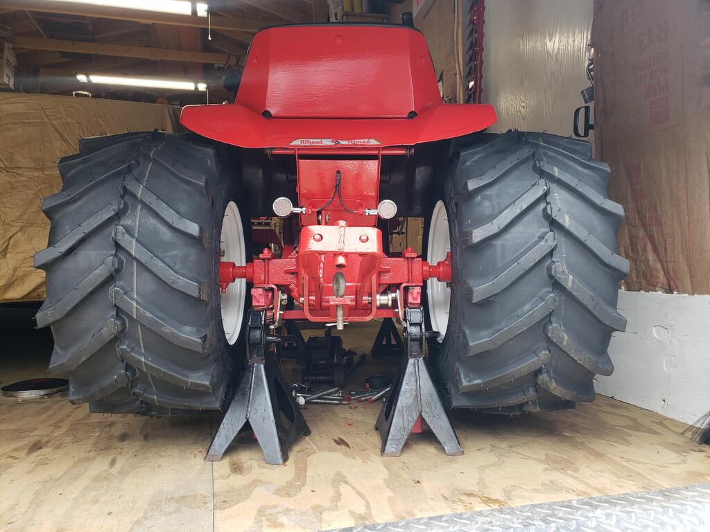

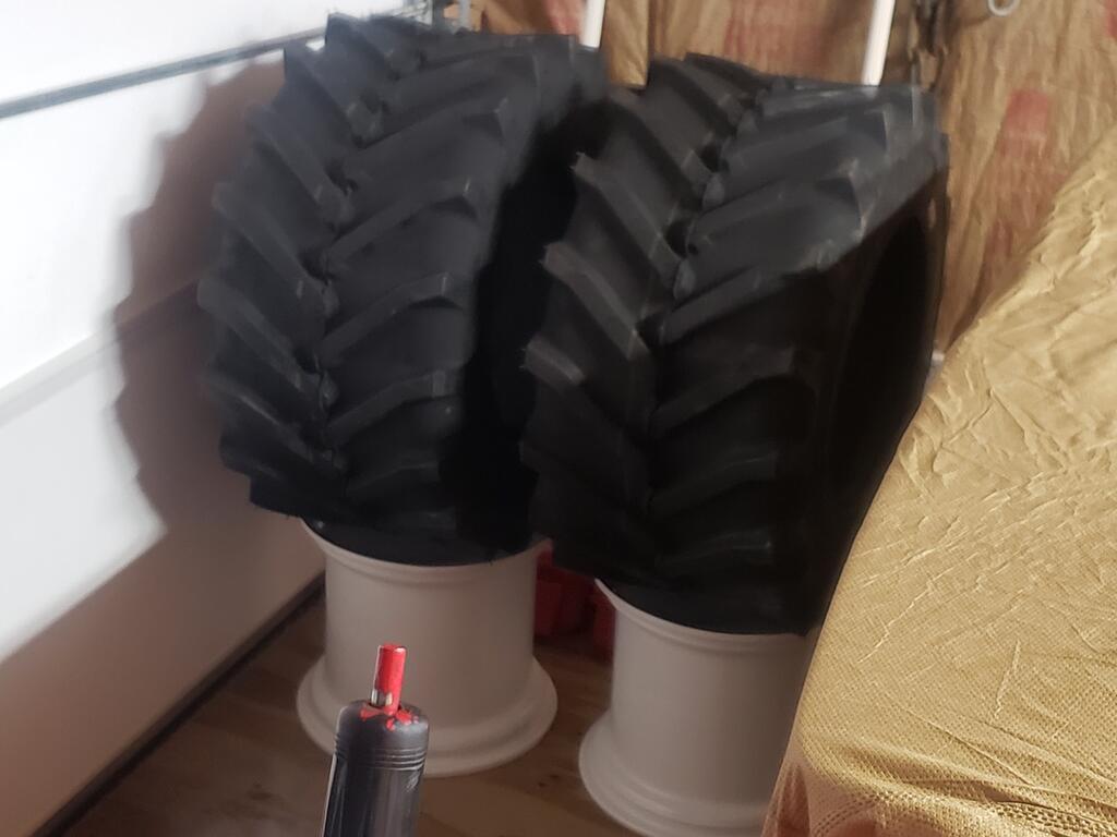

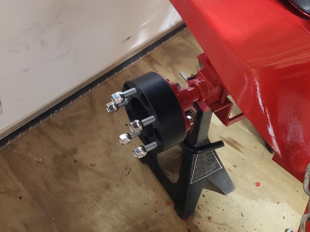

Thegearhead0324 1,842 #45 Posted March 17, 2023 Tires are in and only had time to put on one wheel spacer tonight. Getting there... 2 4 Share this post Link to post Share on other sites

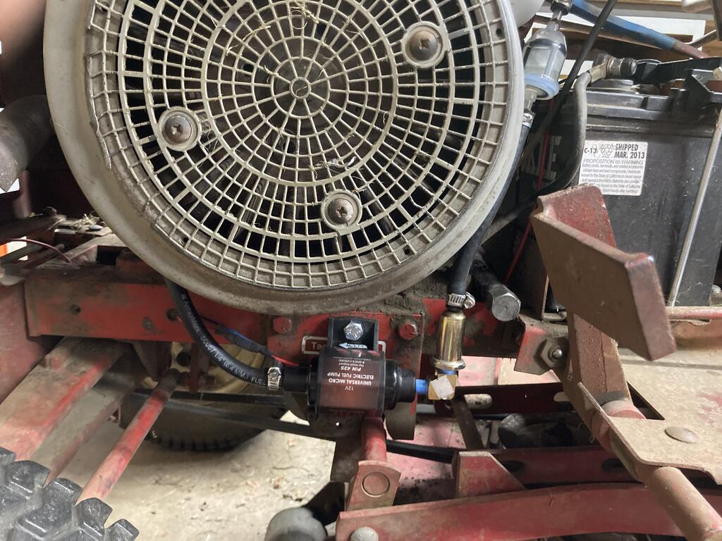

Thegearhead0324 1,842 #46 Posted March 17, 2023 I also decided to go from mechanical to electric fuel pump, so I bought a facet posi flow pump and will be using a relay along with a switch (along with ignition switch powering it on.) So basically I gotta mount tubes+tires on rims, redo the fuel system, and change oil, then touch up everything when its done. (Or should I say its never done.) 4 Share this post Link to post Share on other sites
sjoemie himself 3,209 #47 Posted March 18, 2023 On 3/17/2023 at 1:26 AM, Thegearhead0324 said: Tires are in and only had time to put on one wheel spacer tonight. Getting there... This restoration is looking excellent. If I may ask, what tires and which size did you get? 1 Share this post Link to post Share on other sites
Thegearhead0324 1,842 #48 Posted March 18, 2023 2 hours ago, sjoemie himself said: This restoration is looking excellent. If I may ask, what tires and which size did you get? Front tires I got are deestone 4x8 tri ribs, rear tires are carlisle AGs 26x12x12. I had to look for wider rear rims for them boys. 1 1 Share this post Link to post Share on other sites
ebinmaine 80,694 #49 Posted March 18, 2023 58 minutes ago, Thegearhead0324 said: Front tires I got are deestone 4x8 tri ribs, rear tires are carlisle AGs 26x12x12. I had to look for wider rear rims for them boys. Will the 26" diameter fit under the stock fender pan or did you raise/move things? Share this post Link to post Share on other sites
Thegearhead0324 1,842 #50 Posted March 18, 2023 2 hours ago, ebinmaine said: Will the 26" diameter fit under the stock fender pan or did you raise/move things? I actually just mounted the tires on rims just now. They just barely touch the pan but with human weight they will touch so I'm going to raise it half inch. She looks meeaaaannnnn. Still gotta do fronts, they were a bear to get on there! 2 5 Share this post Link to post Share on other sites
