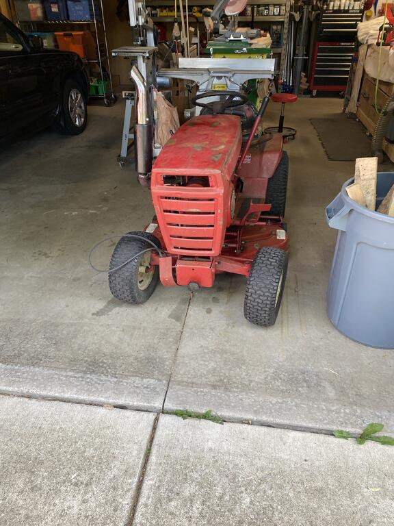

Heatingman 977 #1 Posted June 30, 2022 Just bought a wheelhorse. First one. Seems to fit my old fashioned style. 5 1 1 Share this post Link to post Share on other sites

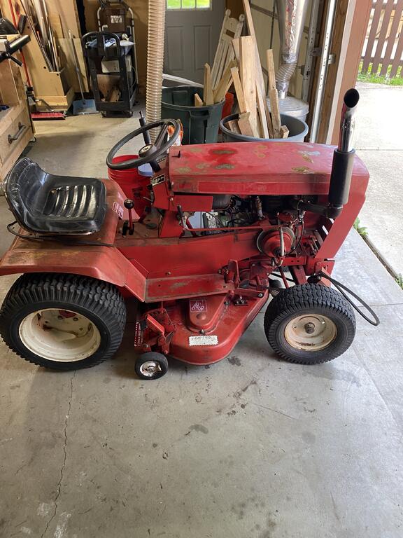

Heatingman 977 #13 Posted June 30, 2022 2 hours ago, Pullstart said: If you’re unsure of the model, we can help. Pictures would be best! There should be an ID tag somewhere, either under the dash, on the frame near the left side of the dash stand, or maybe on the rear fender. It’ll have model ID and serial info. If you can’t do pictures, let’s start by doing 20 questions! Round hood? Fender pan? If there’s a fender pan, is bolted to the tractor or does it flip up? Where’s the gas tank located? What size/brand engine? That should help narrow it down quite a bit! Think its a B-80 8 or 10 HP Kohler. Early to mid seventies model 10141 on the data plate serial 148917 Runs and drives, seems it needs a seat switch for the pto to engage 2 Share this post Link to post Share on other sites
ebinmaine 77,554 #14 Posted June 30, 2022 19 minutes ago, Heatingman said: Think its a B-80 8 or 10 HP Kohler. Early to mid seventies model 10141 on the data plate serial 148917 Runs and drives, seems it needs a seat switch for the pto to engage IIFF... you take the model number and chop the number one off the front, do a search, should come up to a 1975 b80. That's an 8 horsepower Kohler single cylinder engine. I'm not so sure there's a seat switch on that tractor though...... I've got a 1975 C series that does not have a seat switch and I've had 1974 B80 without it. PTO switch not acting right would absolutely cause your issues. 1 Share this post Link to post Share on other sites
Heatingman 977 #15 Posted June 30, 2022 Just now, ebinmaine said: IIFF... you take the model number and chop the number one off the front, do a search, should come up to a 1975 b80. That's an 8 horsepower Kohler single cylinder engine. I'm not so sure there's a seat switch on that tractor though...... I've got a 1975 C series that does not have a seat switch and I've had 1974 B80 without it. PTO switch not acting right would absolutely cause your issues. I followed the wiring, 2 wires go to the bottom of the seat through the frame, and if I trick the machine to think the PTO switch is in the disengage position, the motor stays active, and the PTO engages. I’ll fool with it tonight see if I can bypass the seat switch till I can tear apart the seat and fix the switch. It needs new skins anyways. 3 Share this post Link to post Share on other sites

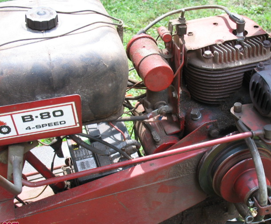

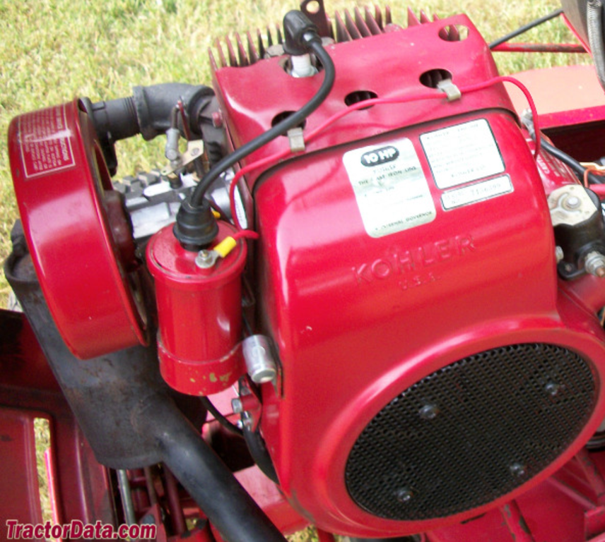

Pullstart 68,986 #16 Posted June 30, 2022 1 hour ago, Heatingman said: 8 or 10 HP Kohler. It’ll be easy to tell the difference based on size. The 8 is a small block and the 10 is a big block 2 Share this post Link to post Share on other sites
rmaynard 16,910 #17 Posted June 30, 2022 8hp has the coil mounted horizontally on the top 10hp is mounted vertically on the front. 2 Share this post Link to post Share on other sites

Pullstart 68,986 #23 Posted July 1, 2022 and a Jim Kemp stack! 1 Share this post Link to post Share on other sites
