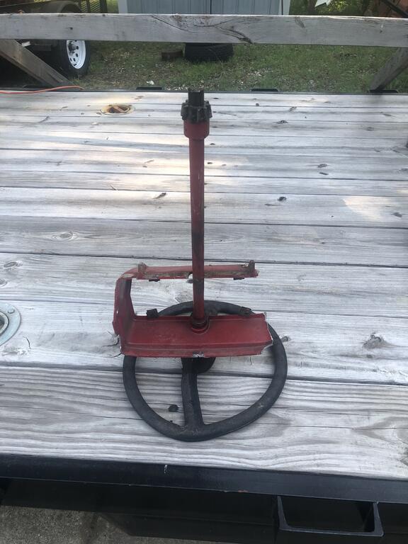

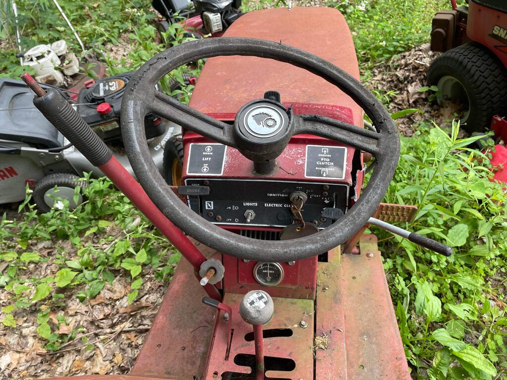

Rob J. 1,942 #29 Posted July 2, 2022 On 6/30/2022 at 6:38 AM, Pullstart said: I’ve got a whole C series dash/steering assembly… Got any pics of this assembly? I might just go that route if I can’t get this roll pin out which is unlikely. Share this post Link to post Share on other sites

Pullstart 70,683 #31 Posted July 2, 2022 1 hour ago, Rob J. said: Already called Lincoln on that, if I have to…… What about that hydro roller? It will have the hubs you need and the dash, for less than the price of the special hubs. 3 Share this post Link to post Share on other sites
Rob J. 1,942 #32 Posted July 2, 2022 8 minutes ago, Pullstart said: What about that hydro roller? It will have the hubs you need and the dash, for less than the price of the special hubs. Last ditch option if I have to. I think I have a set lined up.🤞 2 Share this post Link to post Share on other sites

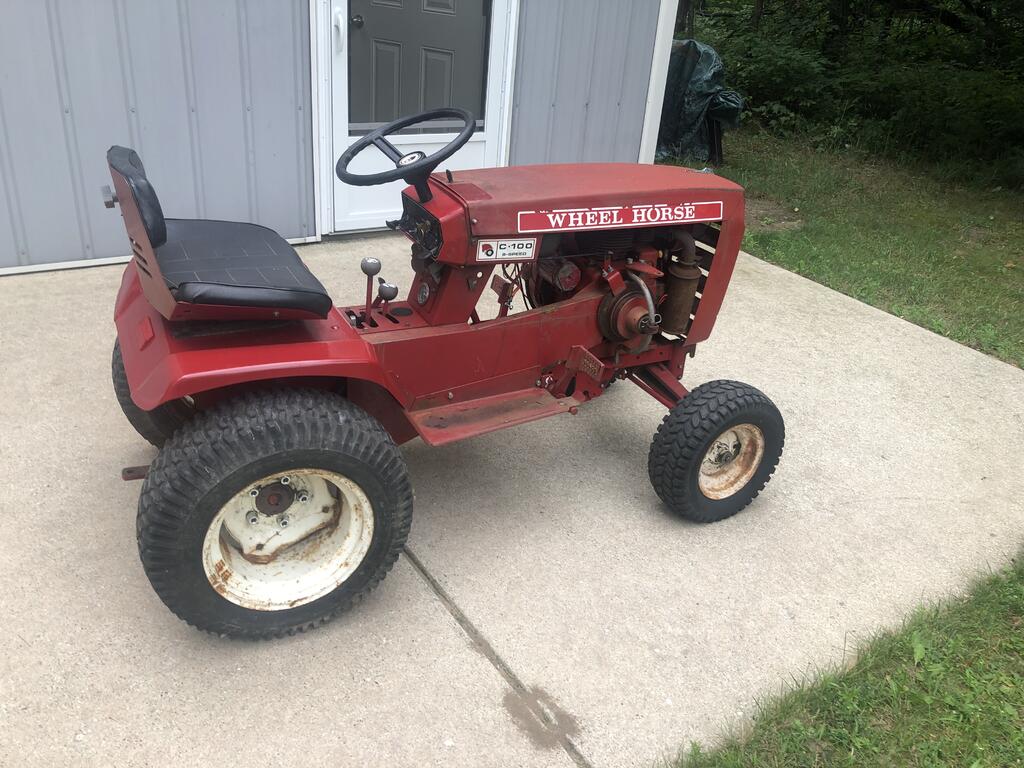

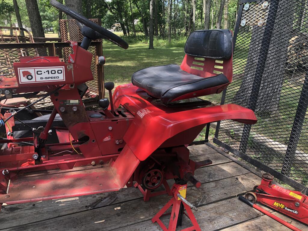

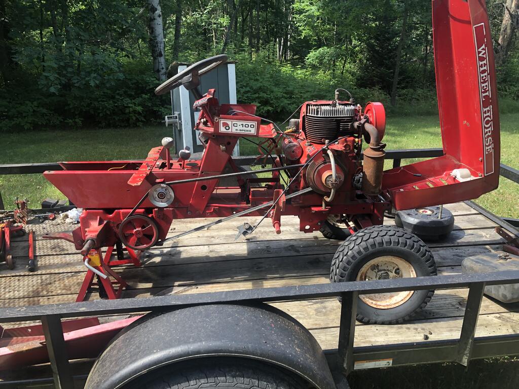

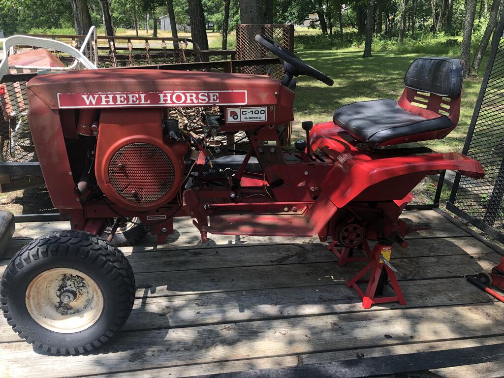

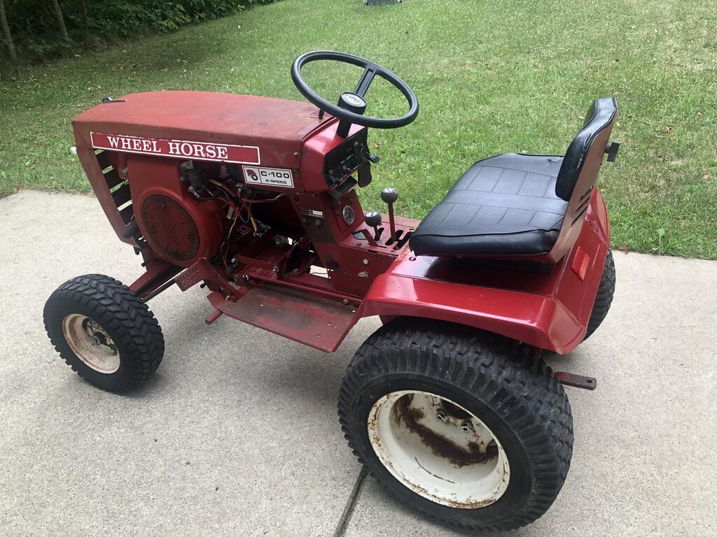

Rob J. 1,942 #35 Posted July 2, 2022 Some more progress, refurbed a seat and fender pan and test fitted it. It’s coming along. As soon as I can get the hubs and roll it the mechanics will come next. I fully expect it to run. How good is another question. 4 Share this post Link to post Share on other sites

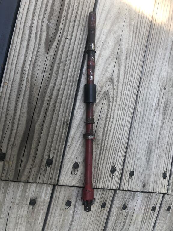

Rob J. 1,942 #36 Posted July 3, 2022 Well made good progress this weekend. I power washed it. Looks a lot better. Got the broken hub off and inspected the other. It’s keyway was turned on the shaft 90 degrees. So it came off. Got the dash tire apart and the steering wheel out. I managed to save the shaft with my basic tools. It’s ready for a set of hubs and dash cowl. Then it will be off to mechanics. Rear end looks good feels good so I’m hoping I get lucky there. I’m confident it will run. Thanks everyone for all your help and insight. Pro-tip if you don’t have a press like me just grind the damn thing off. Get close and hit it with heat, popped right off. Cheers! 6 Share this post Link to post Share on other sites

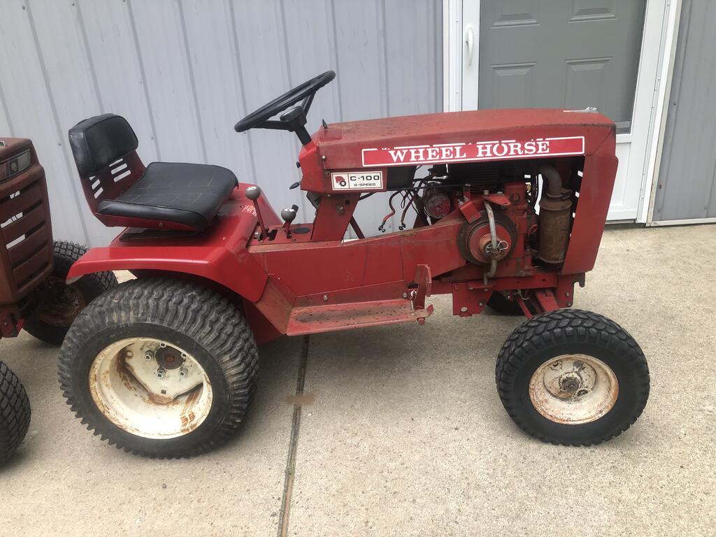

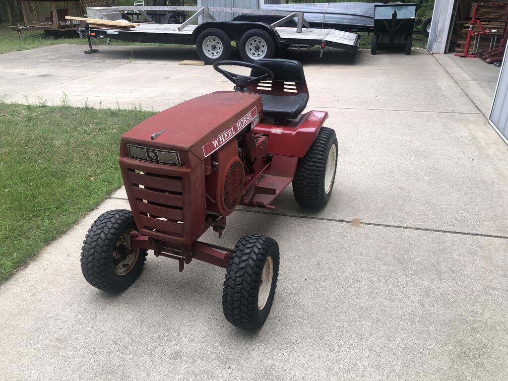

Rob J. 1,942 #37 Posted July 11, 2022 Well a little more progress. It’s officially a roller. So far $270 in this rig. Now off to the mechanics. 5 5 Share this post Link to post Share on other sites

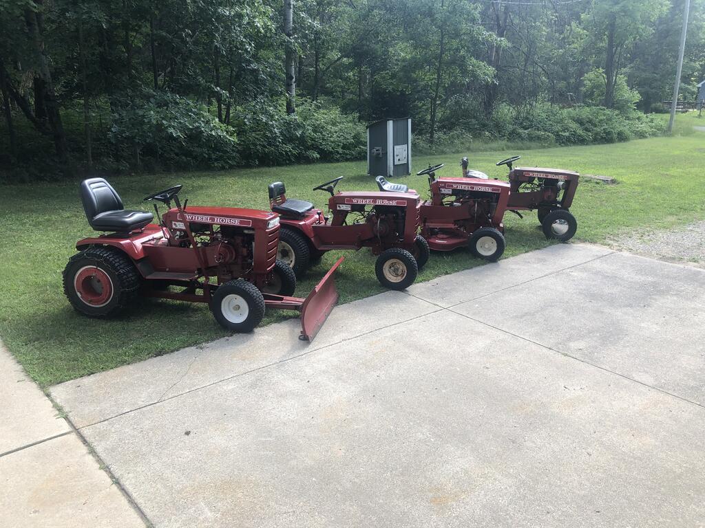

Marv 996 #41 Posted July 14, 2022 Rob, Looking good. Here is two of my special purpose tractors. C141 wheel barrow and C100 sprayer. Marv 1 Share this post Link to post Share on other sites
ebinmaine 79,660 #42 Posted July 15, 2022 11 hours ago, Marv said: wheel barrow Marv you have any more details on that? Build thread? Explanation of how it works? More pics? Share this post Link to post Share on other sites

Rob J. 1,942 #46 Posted July 18, 2022 Hitch update. Did a little cleaning up on the wiring and new spark plug. New fuel lines and filter and bam, runs like a dream. All gears were ran in both hi and low and zero issues. I’m tickled pink! IMG_6038.MOV IMG_6039.MOV 1 5 Share this post Link to post Share on other sites
