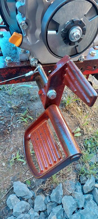

fast88pu 3,394 #79 Posted August 7, 2022 Foot throttle made today 7 Share this post Link to post Share on other sites
SylvanLakeWH 32,587 #80 Posted August 7, 2022 (edited) Slick! Edited August 7, 2022 by SylvanLakeWH 1 1 Share this post Link to post Share on other sites

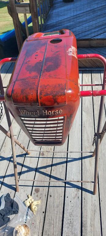

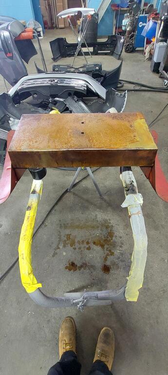

fast88pu 3,394 #81 Posted August 11, 2022 Fender made patina, rust 3 Share this post Link to post Share on other sites

wallfish 20,618 #84 Posted August 13, 2022 Nice! Is 6000 the expected rpm your gonna get for that engine? That's the same throttle set up I did on a hot rod tractor. 2 Share this post Link to post Share on other sites

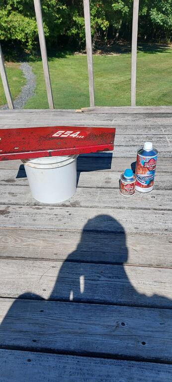

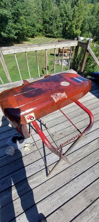

fast88pu 3,394 #92 Posted August 14, 2022 With the low humidity and cooler temperatures I finally got a chance to clear all the sheet metal. I used papa patinas wipe on gloss clear coat. I highly recommend it to anyone who wants to preserve the patina of their machine. It's very easy to apply with an applicator. It is not cheap though. Just over $100 for a quart with activator , but you do get what you pay for. Now for some eye candy, (tractor porn) lol 3 1 Share this post Link to post Share on other sites
stevebo-(Moderator) 8,742 #93 Posted August 14, 2022 Do they have a semi gloss of satin? Share this post Link to post Share on other sites
fast88pu 3,394 #94 Posted August 14, 2022 13 minutes ago, stevebo said: Do they have a semi gloss of satin? Yes they have semi gloss also. Would look nice on your old chevy in gloss to protect it. 1 Share this post Link to post Share on other sites
