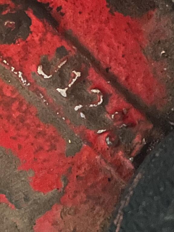

brandon701 23 #1 Posted June 29, 2022 I was wondering if any one could tell me what this ID tag means on my transmission. Thanks Brandon Share this post Link to post Share on other sites
gwest_ca-(File Mod) 11,852 #2 Posted June 29, 2022 Looks like J12% - means nothing to me. What is the model number of the tractor? Share this post Link to post Share on other sites
brandon701 23 #3 Posted June 30, 2022 RJ 58 or 59. There is a 1 next to the % Share this post Link to post Share on other sites
gwest_ca-(File Mod) 11,852 #4 Posted June 30, 2022 So J12%1 - ????? Share this post Link to post Share on other sites
brandon701 23 #5 Posted June 30, 2022 That’s what I make of it Share this post Link to post Share on other sites
8ntruck 8,348 #6 Posted June 30, 2022 Casting date code maybe? 1 Share this post Link to post Share on other sites
stevasaurus 23,517 #7 Posted June 30, 2022 J12% That is September 12th.("I" was not used) A picture of the horse we are talking about would do wonders to name the year and model. J12%1 is a September 12th, 1961 Would have come in a #401 with a #5010 transmission. Concur?? @brandon701 I want to apologize for my crotchety response to your thread. I have edited my post to clean it up. No excuse, I was having a real bad day...I am sorry. If I may, that is the casting number for that trans casting. J12%1 equals September, 12, 1961. That would be a #5010. If you have this on an RJ-58/59...2 things. 1. either the brake drum side was changed to make it a #5003 or 2. the linkage was redone to fit from a 5003 to a 5010. The way to tell, the brake pad attachment is either at a 90 degree angle or a 45 degree angle. If it was the change in the linkage, it could be the tension pulley is either grooved or a flat pulley. Share this post Link to post Share on other sites
J854D 141 #8 Posted June 30, 2022 There’s always a possibility that sometime in the RJ58/9’s past the 9/12/61 transmission was installed as a replacement. -JD- Share this post Link to post Share on other sites
wallfish 18,791 #9 Posted June 30, 2022 The numbers are the casting date of that piece as mentioned Those cast centers are certainly interchangeable between 58 59 60 61 tractors so who knows what was done over the past 60 years. The brake band side cover can be changed to adapt it on to a 58 59 so it is possible it could be on an older RJ. The difference is the brake band mounting tab location. ( but that wasn't necessarily the original question ) It may also be possible that there were extra repair parts cast or the part was sent to a dealer for a repair part. 2 Share this post Link to post Share on other sites
