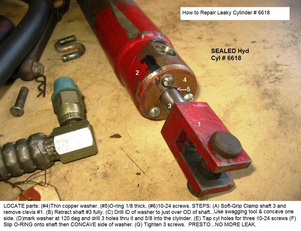

daveoman1966 3,882 #2 Posted June 29, 2022 Bronco 14 cyl leak fix.. I also have a Bronco 14...leaked. He is my fix...a few years ago. 2 4 1 Share this post Link to post Share on other sites
Henry Jr 4 #4 Posted June 29, 2022 That might be a cheaper fix than taking the cylinder to a hydraulic shop turning down the weld and rebuilding the internals and welding back together? Thanks for the fast reply!! 2 Share this post Link to post Share on other sites
