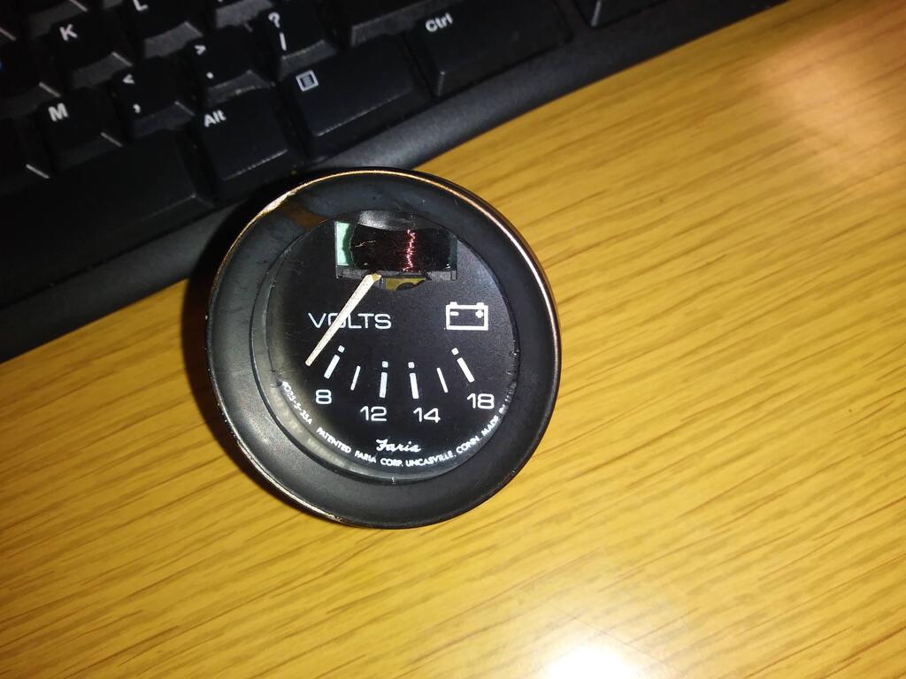

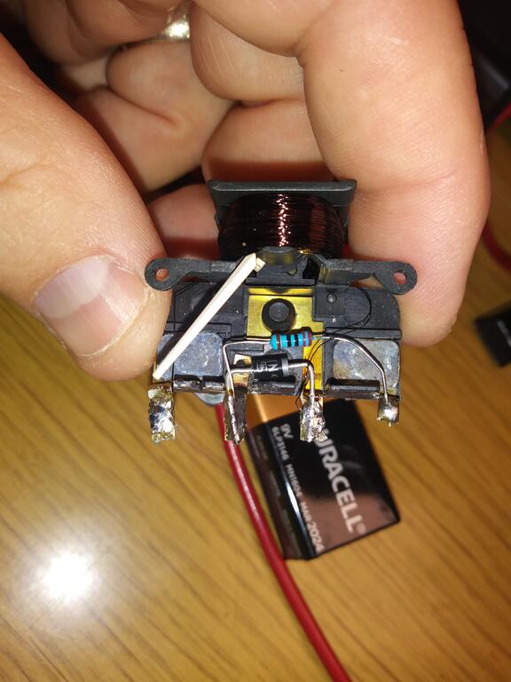

subvet720 179 #1 Posted June 28, 2022 My 310-8 came with a broken Faria volt gauge. I opened it up, and after replacing a 220 ohm resistor and 1N914 diode, and she is back up and running. The hard part was figuring out the resistor size, but a variable resistor helped dial in the value. 2 8 Share this post Link to post Share on other sites
