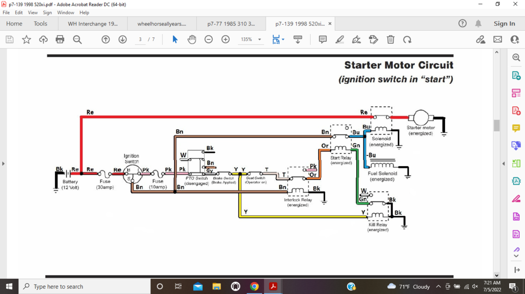

toro520Xi 0 #5 Posted July 3, 2022 (edited) Not having any luck. Checked all the switches and they are fine. Battery is good. If the blue wire is the starting wire, how much voltage should come through? Is that what sends signal to engage solenoid? Edited July 3, 2022 by toro520Xi Share this post Link to post Share on other sites
gwest_ca-(File Mod) 12,066 #6 Posted July 5, 2022 Should be battery voltage. Relays K1, K2 and K3 must be energized for the blue wire to have voltage. If you use a jumper to apply power to the blue wire does the starter engage? Be careful. Do not slip and apply power to the white wire. That would release the magic smoke in the ignition coils. 1 Share this post Link to post Share on other sites
953 nut 64,647 #7 Posted July 5, 2022 If you are not familiar with wiring the diagram can be a daunting. As Garry said, that white wire. Some of the colored wires are likely to be a black wire with a tracer color stripe on them. Check the 10 amp fuse on the pink wire, with the key in the start position do you get power to both ends of the fuse? Is the fuse holder clean and free of corrosion? Have you tried to move the PTO handle slightly while holding the key in the start position? If that isn't the problem lets chase down the other components. Place the rear end of your tractor on jack stands with the rear tires slightly off the ground for safety. A small jumper wire with one end connected to the battery "+" is the best testing tool for the job. Be careful with the live end of this, we don' want any sparks! An insulated gator clip would be a good idea. Touch the jumper to the small terminal on the solenoid where the blue wire attaches, this should close the solenoid and turn over the starter. If that works we will move on to the seat switch. Locate the tan wire and attach your jumper to it then turn the ignition switch to start. You should hear a click as the interlock relay close. If it closes the start relay should also close which would close the solenoid. Presuming this works you can move on to the PTO switch. It is located next to the battery and a bit hard to get at. Moving the battery away from the PTO will probably get you enough room. Connect your jumper to the Gray wire on the PTO switch, sit in the seat apply the brakes and turn the key to start. If this turns over the starter then the PTO switch should be cleaned and examined. Hope this helps. Let us know you make out. Share this post Link to post Share on other sites
