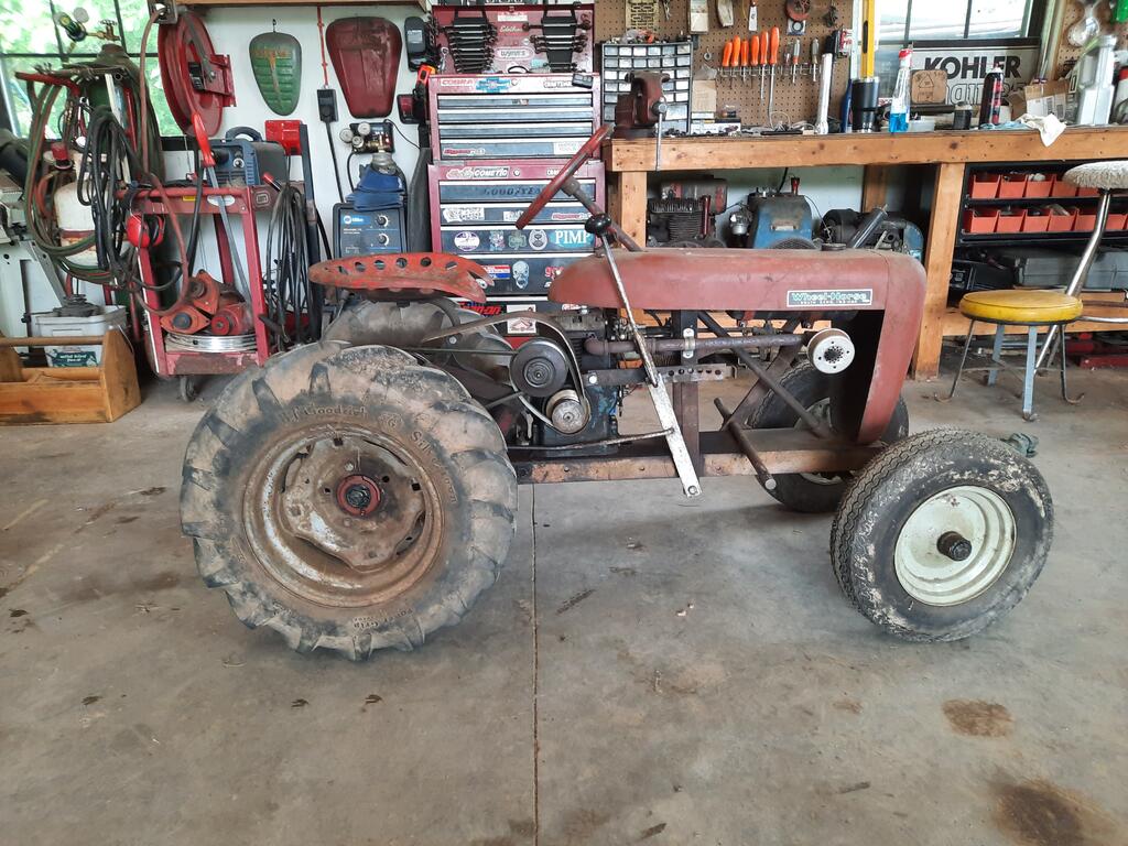

jeremi3210 743 #1 Posted June 26, 2022 (edited) Been awhile since I had this little gem out. One of the first wh tractor I actually bought, when I got it I didn't even know what it was! Lol! Not a bad 300 buck purchase in my opinion! Took the old tired smoker k91 off and installed a great running k90 I found in a pile of junk at my kids uncles shop! Edited June 26, 2022 by jeremi3210 10 5 Share this post Link to post Share on other sites

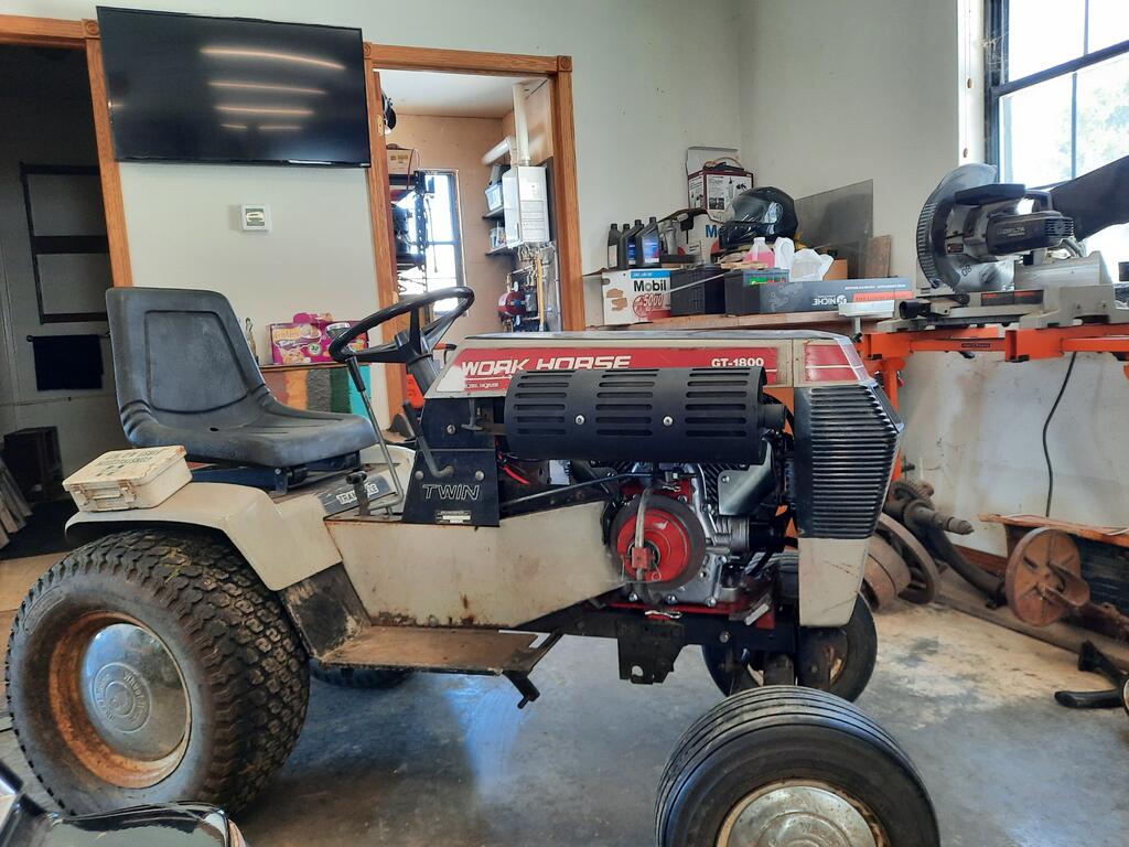

jeremi3210 743 #8 Posted June 27, 2022 41 minutes ago, Sodaking27 said: Nice. What’s that WorkHorse setting in the back ground. That is a gt1800 I got it with a kohler engine in it not the original briggs. That one I did slap a predator 670 in. Fits nice and runs great! I use it for mowing and snowblower duty. 1 Share this post Link to post Share on other sites

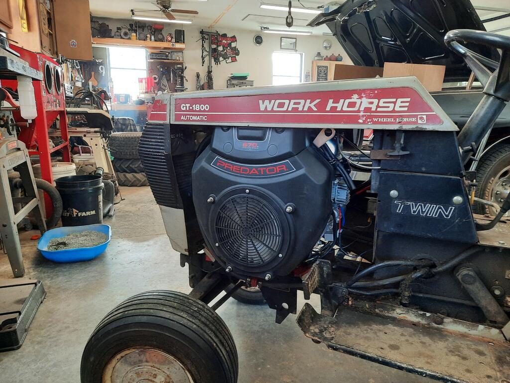

Sodaking27 1,108 #9 Posted June 27, 2022 2 hours ago, jeremi3210 said: That is a gt1800 I got it with a kohler engine in it not the original briggs. That one I did slap a predator 670 in. Fits nice and runs great! I use it for mowing and snowblower duty. Cool. Can you provide me with some pictures of it the next time you have it out. Interested in seeing some closeup of the predator install and any tips you can provide. I hopefully have a GT1800 coming with a blow-in engine. Thanks Share this post Link to post Share on other sites
jeremi3210 743 #10 Posted June 27, 2022 3 hours ago, Sodaking27 said: Cool. Can you provide me with some pictures of it the next time you have it out. Interested in seeing some closeup of the predator install and any tips you can provide. I hopefully have a GT1800 coming with a blow-in engine. Thanks I put it on a wh shaker plate that I solid mounted, just had to drill 2 new holes in the plate and it lined up the pto perfectly. I used a battery ignition key switch and a relay to kill the engine on shut off. The exhaust was kinda a pain you will have to flip the muffler over and extend the pipes to clear the hood, I've since this photo replaced that clunky loud muffler with one off a 520. Still had to modify it but it's a bunch quieter and way smaller! The pto is debatable, some people say you can't side load the crank and go electric, this is my second year on this with no problems. If you could use the thrust bearings from the original gt1800 engine you will be good with nothing to worry about. You will need the pulley anyways off it cause the crank is 1 inch. Any other questions just ask iam happy to help! 2 3 Share this post Link to post Share on other sites
Sodaking27 1,108 #11 Posted June 27, 2022 (edited) Thanks for the info. Can you send me some closeup shots of the shaker plate when you get a chance. I’m sure I’ll have a bunch of questions once I get started. I’ll be in touch once I have the tractor in my possession. Thanks again. Don Edited June 27, 2022 by Sodaking27 1 Share this post Link to post Share on other sites
