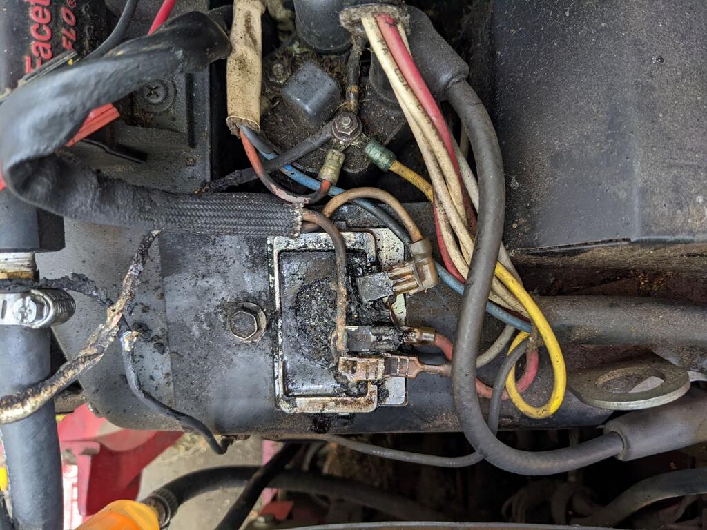

longbikez 3 #18 Posted August 11, 2022 Today I showed the regulator to a friend who knows electronics, he said it's not a real voltage regulator but a 1/2 wave rectifier and to clean out the housing and he'd show me how to put a quality unit in it. Meanwhile, the used one is working great, it's a Stens but it's over 10 yrs old so maybe they bought better quality then. He told me that the junky one was most likely leaking AC into the DC output (said an O scope would have proved it) and that this would really mess with the battery. He also said that when it started over volting that was its last gasp before going up in smoke. So, for two mows now there has been no irregularity and no starter judder on crank, therefore I am going to continue monitoring B4 buying a starter despite the ammeter readings. I'd like to thank everyone who offered their help and wish you all Happy Horsin' Around. 3 Share this post Link to post Share on other sites
peter lena 9,727 #19 Posted August 11, 2022 @longbikez that pile of wires and anything related to it , should be cleaned up , those onan units are known for wiring issues , relay shorting , chafing wires etc. lots of shorting / burning . would also go thru that starter to verify what's working , do a graphite lubrication rebuild , would also , do a graphite check on those flywheel teeth . those back feeding wire burn outs , are showing you the way . just sayin , pete Share this post Link to post Share on other sites
