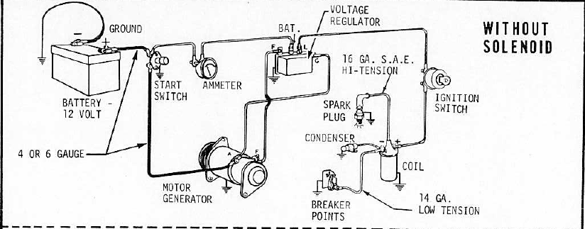

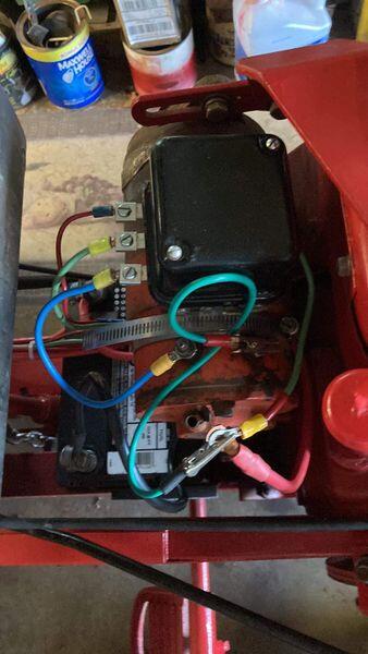

"Manic-Mechanic" 1,485 #1 Posted June 24, 2022 (edited) Well, I went with this circuit and the generator really isn't charging, quite the opposite. I measure voltage across my terminals prior to starting and I get almost 13 v. Once running the voltage drops on my multimeter to 12.35 v. The voltmeter gauge remains at a steady 12v. I do not want to keep it running if there is an issue...The light I used for the warning light off the ignition begins to glow once throttled up, so my generator is not charging. The field terminal does read 12 v with the ignition off. Now I'm under the impression the generator is not in fact "generating?" The light bulb is rated 28 v, perhaps it is causing an issue, not sure Edited June 24, 2022 by "Manic-Mechanic" Share this post Link to post Share on other sites
adsm08 4,250 #2 Posted June 24, 2022 With the engine running, and your volt meter hooked to the battery, ground the field terminal of the S/G unit and monitor voltage. If it spikes high, the regulator, or its wiring, is at fault. If voltage stays low it is time to get the S/G unit rebuilt. There is a guy in our general area (Red Lion maybe) that supposedly still does that work, but I can't remember who. Hopefully one of the other SEPA members will chime in knowing who it is. 1 Share this post Link to post Share on other sites

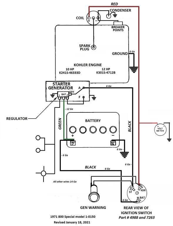

gwest_ca-(File Mod) 12,066 #4 Posted June 24, 2022 This old Kohler service manual has a good section on the starter/generator. One here also by Briggs and Stratton 1 Share this post Link to post Share on other sites

"Manic-Mechanic" 1,485 #8 Posted June 24, 2022 (edited) I see on the diagram above a wire from A to a terminal marked GEN, could that be the one terminal underneath my regulator? Here is what I am looking at from gwest_ca might be my issue the additional wire to G from A? Edited June 24, 2022 by "Manic-Mechanic" Share this post Link to post Share on other sites
adsm08 4,250 #9 Posted June 24, 2022 3 minutes ago, "Manic-Mechanic" said: I see on the diagram above a wire from A to a terminal marked GEN, could that be the one terminal underneath my regulator? Here is what I am looking at from gwest_ca might be my issue the additional wire to G from A? Yes, the A terminal on mine is down below, and hard to access. I remember this because it is one of the ones that has to be jumpered to polarize the regulator. 1 Share this post Link to post Share on other sites
"Manic-Mechanic" 1,485 #10 Posted June 24, 2022 (edited) 2 minutes ago, adsm08 said: Yes, the A terminal on mine is down below, and hard to access. I remember this because it is one of the ones that has to be jumpered to polarize the regulator. That would totally explain the readings I am getting, seems to me I had this issue decades ago on a Sears... Edited June 24, 2022 by "Manic-Mechanic" Share this post Link to post Share on other sites

"Manic-Mechanic" 1,485 #13 Posted June 24, 2022 8 minutes ago, adsm08 said: Yeah, at one point I was taking my 855 apart so often for various electrical issues that I left a wire alligator-clipped to the A-terminal and looped off and capped for quick access because I was polarizing the regulator a couple times a week. Then I got my issues fixed (mostly) and took it off. I was just debating what color to use, an alligator clip would be smart. I loosened the inside screw and removed the other, regulator slides right off. Here goes nothing! Lol Share this post Link to post Share on other sites
"Manic-Mechanic" 1,485 #14 Posted June 24, 2022 Well, I set it up as indicated and that was not good! I parked it back in the shop as the carburetor seems off as well. She will run, that's half the battle! Share this post Link to post Share on other sites
