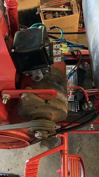

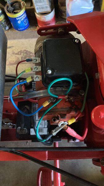

"Manic-Mechanic" 1,485 #26 Posted June 25, 2022 I believe that is what I had seen in the video. I have another regulator, a flat mount. Going to hook it up temporary and see what's, what Share this post Link to post Share on other sites

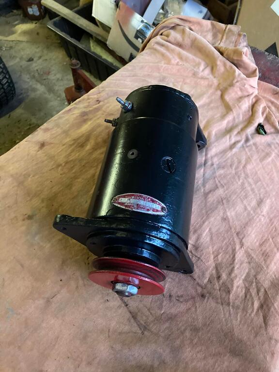

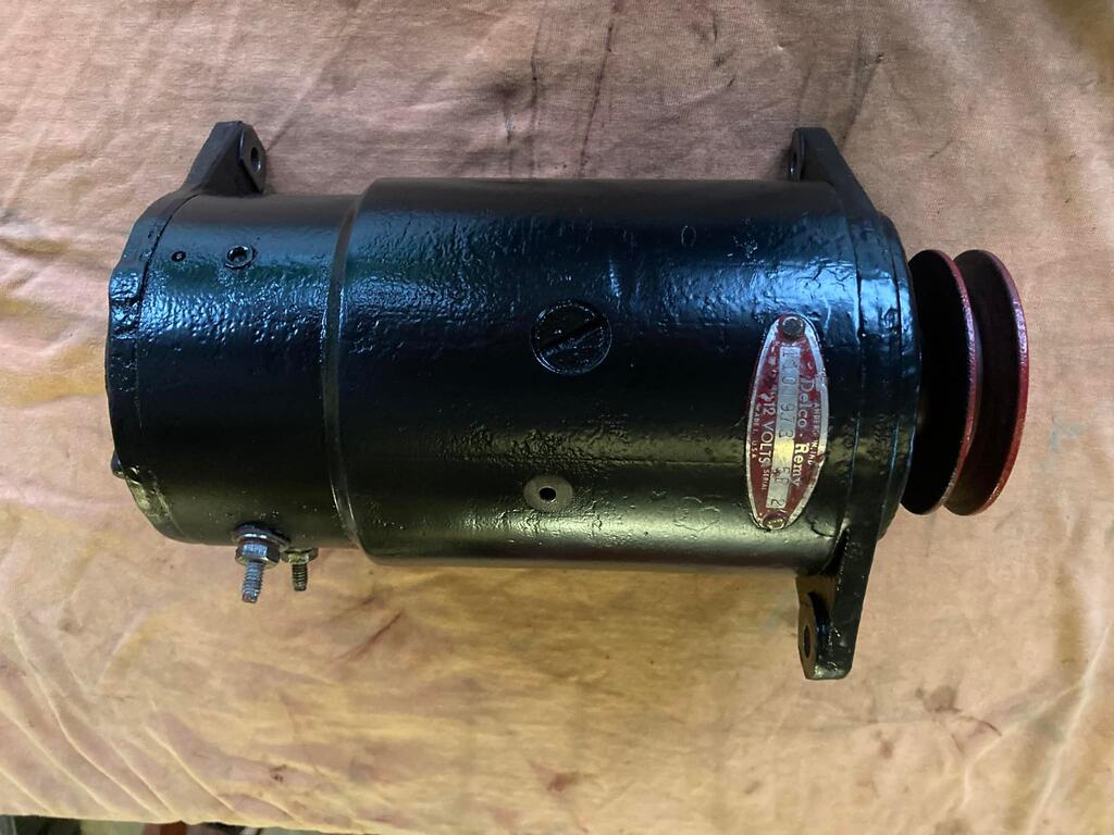

"Manic-Mechanic" 1,485 #36 Posted June 27, 2022 Well, not hot enough for heat proof paint tho'. Here is the finished Genny ready to go back in. 1 Share this post Link to post Share on other sites
