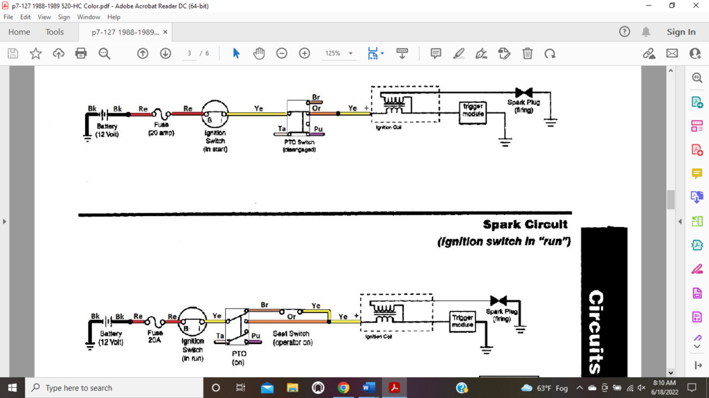

953 nut 64,647 #14 Posted June 18, 2022 Your seat switch is supposed to turn off the engine if the PTO is on and the operator leaves the seat, with the PTO off (handle pulled back) the seat switch just sits there and does nothing. You can test each step as Dan suggested or waste money on parts you don't need, your choice. If you understand how the wiring is supposed to work you will find it a bit easier to correct the problem you're encountering. Take a look at these two wiring diagrams. The first one shows the PTO OFF, seat switch isn't in the picture because it isn't doing anything. The second drawing has the PTO ON and the seat switch closed because the operator is in the seat. Not shown is if the operator leaves the seat the seat switch will OPEN which has the same effect on the ignition as turning off the key because the PTO switch is also open in this configuration. You say the engine will have spark if you run a jumper to the coil +, did the started turn over from the key switch? My suggestion would be to clean and tighten ALL of the electrical connections shown in these diagrams, any loose or corroded connection between the battery and the ignition coil could be culprit, CLEAN THEM ALL! Also inspect the wires to be sure they aren't chafed or in bad condition. 2 Share this post Link to post Share on other sites

lynnmor 8,684 #17 Posted June 18, 2022 2 hours ago, TJ Salyers said: Would it hurt anything to run it that way. Of course you would be bypassing all safety systems. Simply fix the circuit, the schematic in post #14 shows the components involved. 1 Share this post Link to post Share on other sites
