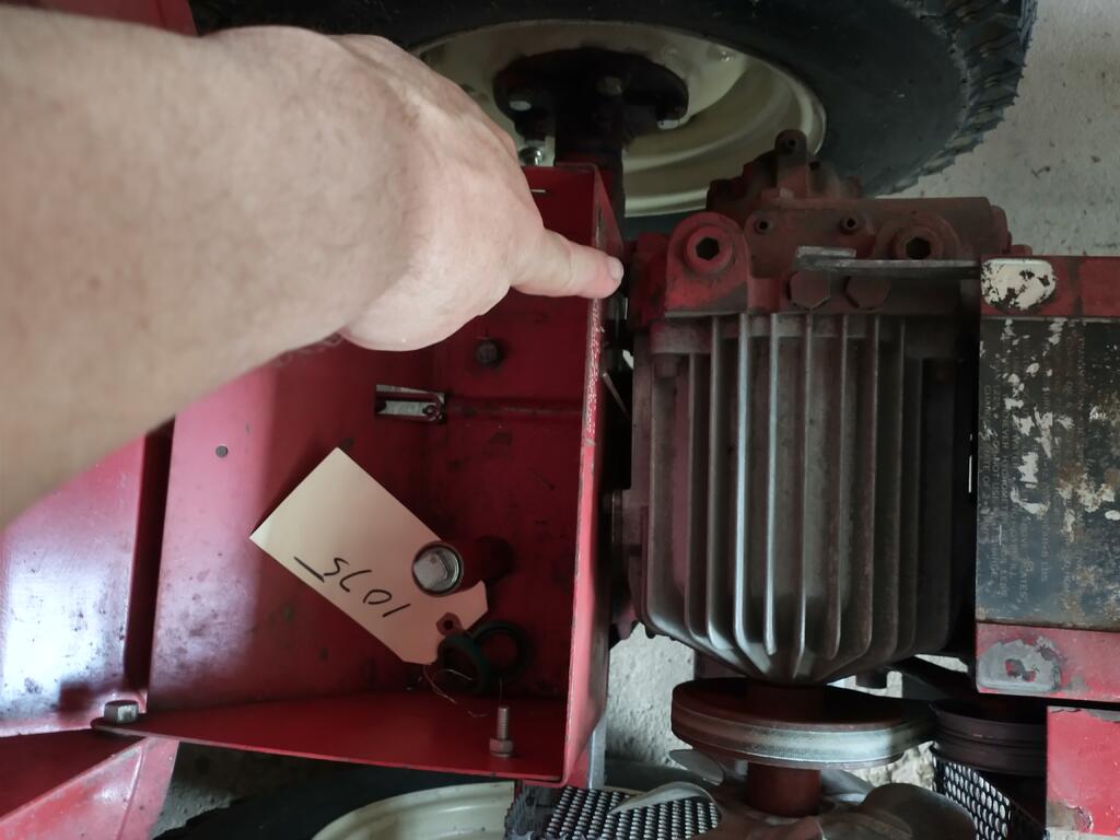

squonk 45,590 #10 Posted June 16, 2022 1/2" hex bolt. Right where my finger is pointing. 1 Share this post Link to post Share on other sites
GaryRat 31 #11 Posted June 17, 2022 My mother told me it was not polite to point but that sure helps! I tried to turn the one under the seat latch part (similar location to the 1968 Charger 12) and found it quite tight so I didn't mess with it. I'll be messing with it more in the morning. Thanks for that! 1 Share this post Link to post Share on other sites
GaryRat 31 #12 Posted June 17, 2022 I found the bolt head backed out so I tightened it until I felt some resistance. Seems to work just fine now! Thanks for all the help! Now to grease it all up and mow. 2 2 Share this post Link to post Share on other sites
