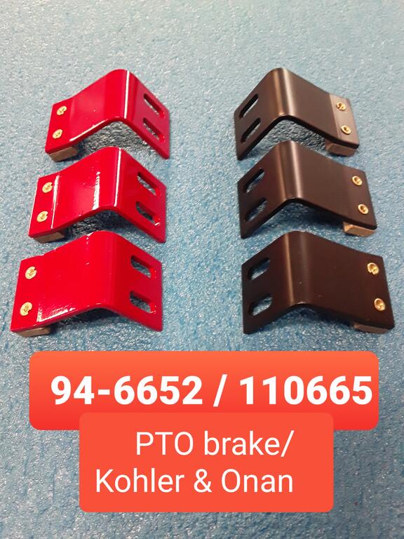

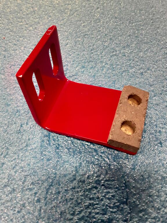

76c12091520h 4,009 #4 Posted June 14, 2022 4 hours ago, Scrapguy said: Recently changed the drive belt and idler pulley on my 1976 C-120 automatic. Noticed my clutch brake assembly (old WH part number 104730, new Toro part 94-6652) was worn down nearly to the rivets. After Waiting for over a month, I was told, no shipping possible. My local Toro shop secured one from another shop. It looks to be a correct part but the rivets holding the friction material seems slightly proud. Old guy me remembers riveted brake shoes having counter sunk rivets. Don’t want to use this part as i believe the rivets will score the main drive engine pulley. I can’t seem to find this part as a NOS part anywhere. Any suggestions? See our listing in the vendors section of the classifieds, private message me if interested 2 Share this post Link to post Share on other sites
