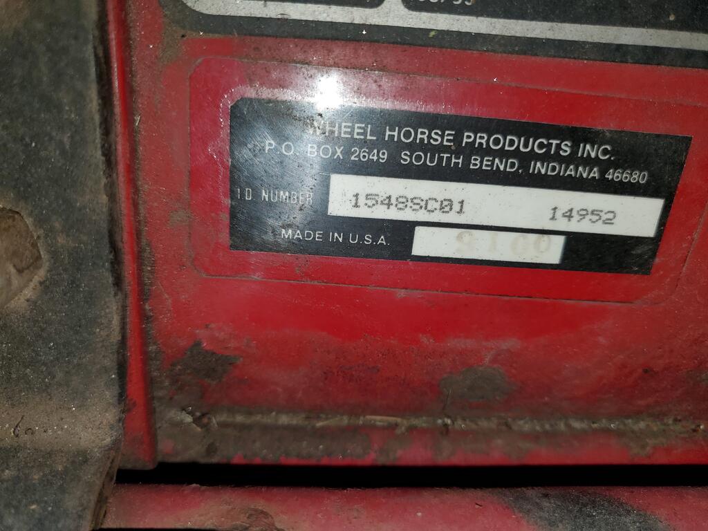

Ajbass60 2 #1 Posted June 13, 2022 (edited) Hi, looking for a replacement belt and can't locate what belt I should be using. The belt that came off appears to be about 96"x1/2". Does this seem correct and does anyone have a Toro oem part #. Adding "48" deck model 1548SC01. Thanks Edited June 13, 2022 by Ajbass60 more info 1 Share this post Link to post Share on other sites
daveoman1966 3,882 #2 Posted June 13, 2022 (edited) We need to know what mower deck your are using. The PTO to deck drive belt is identified by the deck size...not the tractor Edited June 13, 2022 by daveoman1966 1 Share this post Link to post Share on other sites
Ajbass60 2 #3 Posted June 13, 2022 (edited) Sorry, 48" deck model 15-48sc01. Edited June 13, 2022 by Ajbass60 more info 1 Share this post Link to post Share on other sites

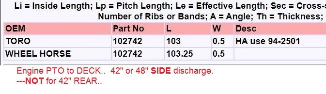

daveoman1966 3,882 #4 Posted June 13, 2022 (edited) The 48" deck belt s/b # 102742... updated to # 94-2501 Edited June 13, 2022 by daveoman1966 3 Share this post Link to post Share on other sites
