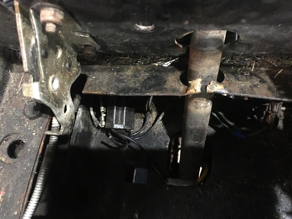

davem1111 2,268 #8 Posted June 13, 2022 49 minutes ago, Lee1977 said: While you have it apart replace the bushing with a two bolt flange bearing. I use a Toro 6472 flange bearing like on the lower shaft, some use a ball flange bearing. Yeah, I've seen that done, seems like a great idea. I'd like to get this tractor back in service in a few days though, and don't know if I can get a new one here that quick. But I do have a parts tractor I can pull the front one from. Also, to drill the holes I'll need to take that whole top section off, and I also need to weld some metal in here for reinforcement. This is in bad shape (locking collar and bushing already slid down, they seem okay): 1 Share this post Link to post Share on other sites
