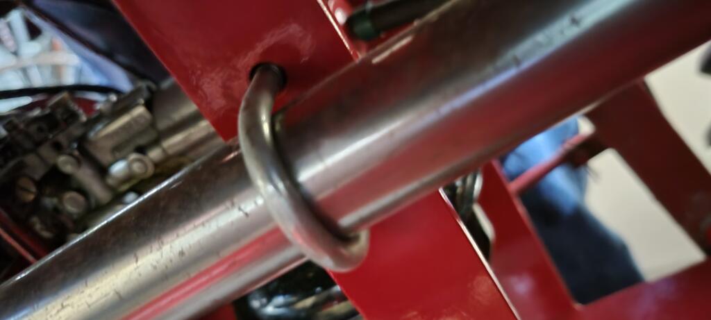

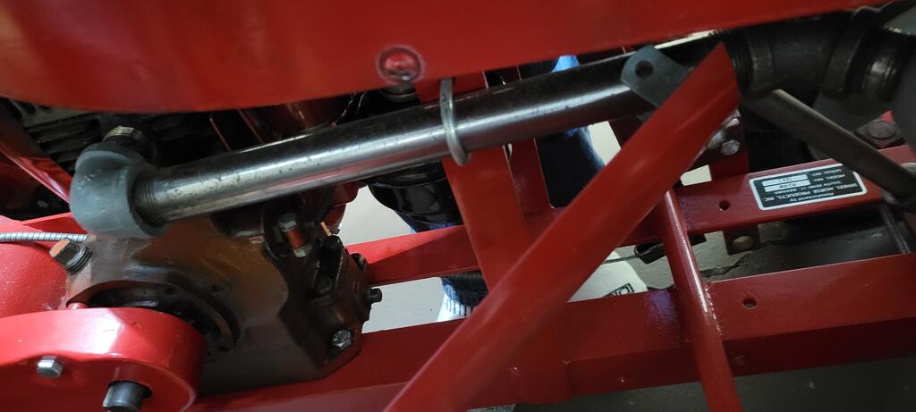

wallfish 19,608 #26 Posted June 10, 2022 Early RJs didn't have cast numbers in the trans case Not original --- the front rims/tires, the exhaust pipe and muffler and whatever that bar thingy is on the front 2 2 Share this post Link to post Share on other sites
Rattlecan 67 #27 Posted June 10, 2022 Didn’t think that loop thingy belonged. Thanks for confirmation. It’s welded but I can get to welds with small cut off wheel and remove it. I will go dig thru my taps I think I have 3/4 tapered pipe taps somewhere and see if I can do something with exhaust port threads. thanks again Share this post Link to post Share on other sites

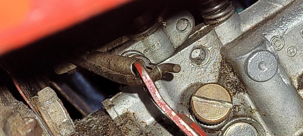

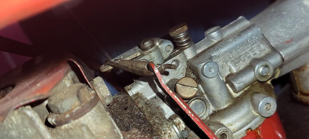

AMC RULES 37,256 #32 Posted June 12, 2022 23 minutes ago, Rattlecan said: There is nothing on tractor to support the exhaust but there are two holes in vertical flat bar on that side. Am I missing some kind of exhaust 23 minutes ago, Rattlecan said: There is a small spring around the link between the governor arm and carb. One end is hooked in a hole in the pivot arm on the carb the other hooked end is not hooked to anything. Anyone know what it hooks to? Share this post Link to post Share on other sites
Rattlecan 67 #33 Posted June 12, 2022 thanks AMC RULES. The link on mine is reversed from yours and the link is threaded thru the coils in the spring. I tried to hook it where yours is today and it was all twisted around and slipped off. I need to remove link from inside if coils and put link in opposite side of governor arm. Pics worth a thousand words. thanks Share this post Link to post Share on other sites
Rattlecan 67 #34 Posted June 12, 2022 A unbolt clamp. That will do it. thanks again Share this post Link to post Share on other sites
AMC RULES 37,256 #35 Posted June 12, 2022 https://www.manualslib.com/manual/1011204/Kohler-K91.html?page=15#manual Share this post Link to post Share on other sites
Rattlecan 67 #36 Posted June 12, 2022 Stevasaurus. Stuck a small rod into front seat spring bolt hole into transmission. About 1 1/2 to 1 3/4 inches of oil on rod. Bottom 1/4 inch is kind of sludgy brown. Looks like a pipe plug drain on right side of trans and a fill pipe plug on top. Does it take 90 wt gear oil? AMCRULES. I got the link to the governor arm flipped over and the link out of the spring coils and hooked up like the pic you sent. Much better. Also did the preliminary settings from the instruction link you sent. thanks again 1 Share this post Link to post Share on other sites
