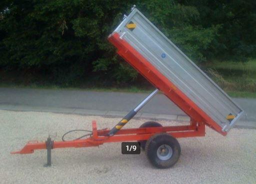

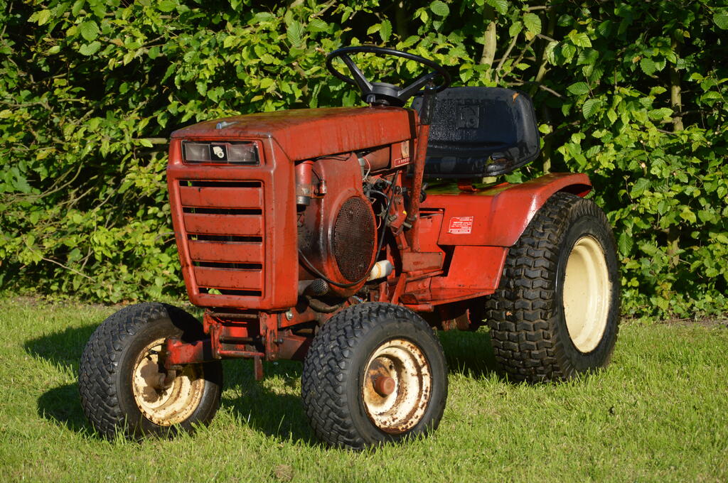

Maxwell-8 4,370 #1 Posted June 4, 2022 The guy that bought my WH with a 14hp wants to add a hydraulic pump to it. It will be used to drive a small hydraulic tipper trailer. I have seen some posts were some of you guys added such a pump. Does anyone of you have any pictures on it? as well as some specs? What is better? under the frame, or use the front attach a matic? Maybe be looking into doing the same to one of my horses. 3 1 Share this post Link to post Share on other sites

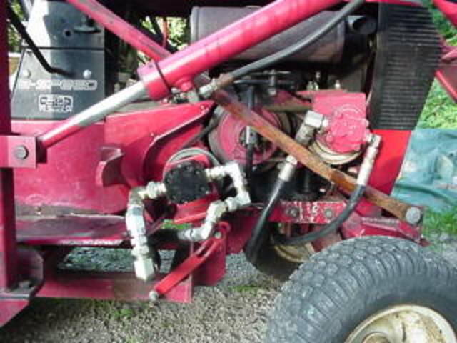

wallfish 18,768 #2 Posted June 4, 2022 (edited) Here's mine with 2 pumps on it. The FEL uses the right. I kept the hoe completely separate with it's own pump even though it could have been run from just the one. Not sure what's available over there but here's a pump you might be able to compare to. https://www.northerntool.com/shop/tools/product_200329712_200329712 It's the same as the one on the lower left used for the hoe. https://www.northerntool.com/shop/tools/product_200329712_200329712 Edited June 4, 2022 by wallfish 1 3 1 Share this post Link to post Share on other sites
Maxwell-8 4,370 #3 Posted June 4, 2022 31 minutes ago, wallfish said: Here's mine with 2 pumps on it. The FEL uses the right. I kept the hoe completely separate with it's own pump even though it could have been run from just the one. Not sure what's available over there but here's a pump you might be able to compare to. https://www.northerntool.com/shop/tools/product_200329712_200329712 It's the same as the one on the lower left used for the hoe. https://www.northerntool.com/shop/tools/product_200329712_200329712 Thanks for that info, helps me and probably him out a lot! Share this post Link to post Share on other sites
Goldnboy 1,066 #4 Posted June 4, 2022 Here is I picture of mine that I added a type two power steering pump and dual hydraulic valve. Hoses run to the back of tractor to auxiliary quick couplers. 3 1 Share this post Link to post Share on other sites

gwest_ca-(File Mod) 11,838 #6 Posted June 5, 2022 The pumps driven by belts have bearings that withstand the shaft side loading caused by a belt. Make sure the pump you decide on states it can be belt driven. 3 1 Share this post Link to post Share on other sites
953 nut 62,959 #7 Posted June 5, 2022 Also be sure the rotation is correct for your application. 2 1 Share this post Link to post Share on other sites
