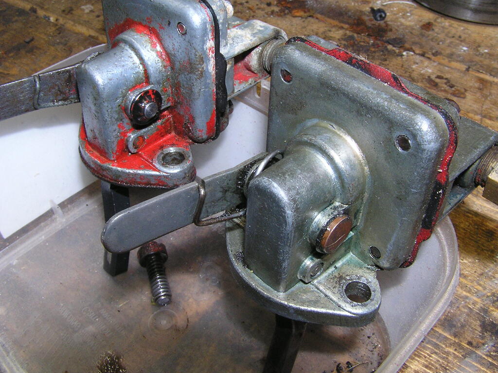

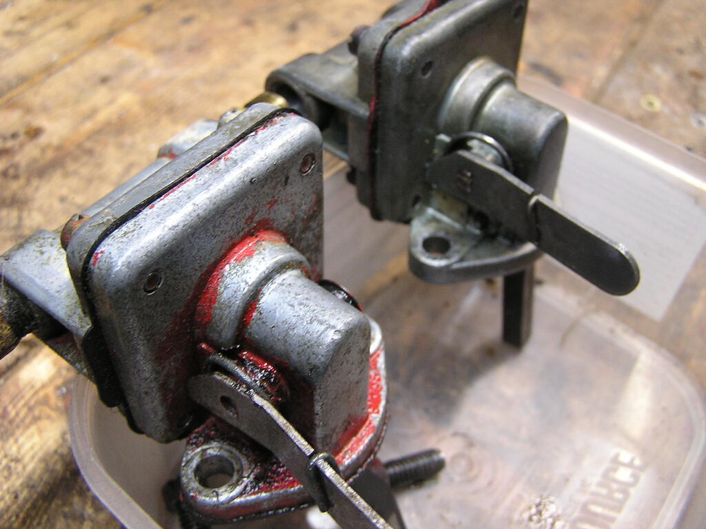

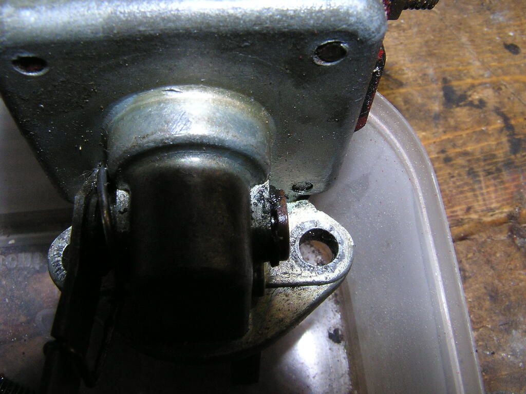

ri702bill 10,067 #1 Posted June 2, 2022 (edited) All: Has any one experienced an oil leak at the Priming Lever Shaft on early 1960's Kohler fuel pumps and come up with a repair solution? I say repair because I want to keep the priming lever and am NOT interrested in going to a low pressure electric pump. I have 2 of these, but they are differently constructed. The red oily one that had oil dripping off the end of the lever has a removable shaft held on with a small (and annoying) Tinnerman Clip. The other has the lever swaged to the end of the headed shaft. The issue as I see it is the thru-the-body shaft rotates with the lever, it is not pressed in place like the pump arm shaft. I will disassemble th red one to see if there is enough meat in the body to machine a pocket on either side for Viton O-rings. As seen in the last picture, the flat seal is split and compromised on the clean one. Something else I saw - I like to use gasket sealer on the engine block side and a film of grease on the pump - makes R&R so much easier. It is not an OE gasket that would have a perimeter profile - it is an aftermarket one with a vertical "window" cut in it and would become a wall that would trap in the pump cavity & collect oil that could not drain back to the block. Maybe time for the Exacto Knife?? I noticed this issue last fall when I drained the straight 30 weight Rotella and filled (not overfilled) it with 10-30 multiweight Rotella for the winter. I did bump up the high speed a tad, I was onlly getting 2800 RPM at WOT with the snowblower engaged, I upped it to 3350. Edited June 2, 2022 by ri702bill Share this post Link to post Share on other sites

953 nut 62,181 #3 Posted June 2, 2022 2 hours ago, ri702bill said: I will disassemble th red one to see if there is enough meat in the body to machine a pocket on either side for Viton O-rings. I'm thinking that the soft cast aluminum body has worn a bit and you may want to drill it out for some bronze bushings. 1 Share this post Link to post Share on other sites
ri702bill 10,067 #4 Posted June 3, 2022 16 hours ago, 953 nut said: some bronze bushings Perhaps, not all that easy as the pump lever is blocking a thru-and thru line ream. Have to do it from both sides - good potential for mis-alignment there.... 1 Share this post Link to post Share on other sites
