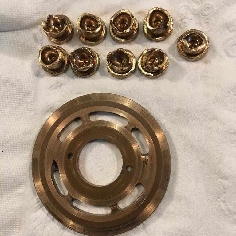

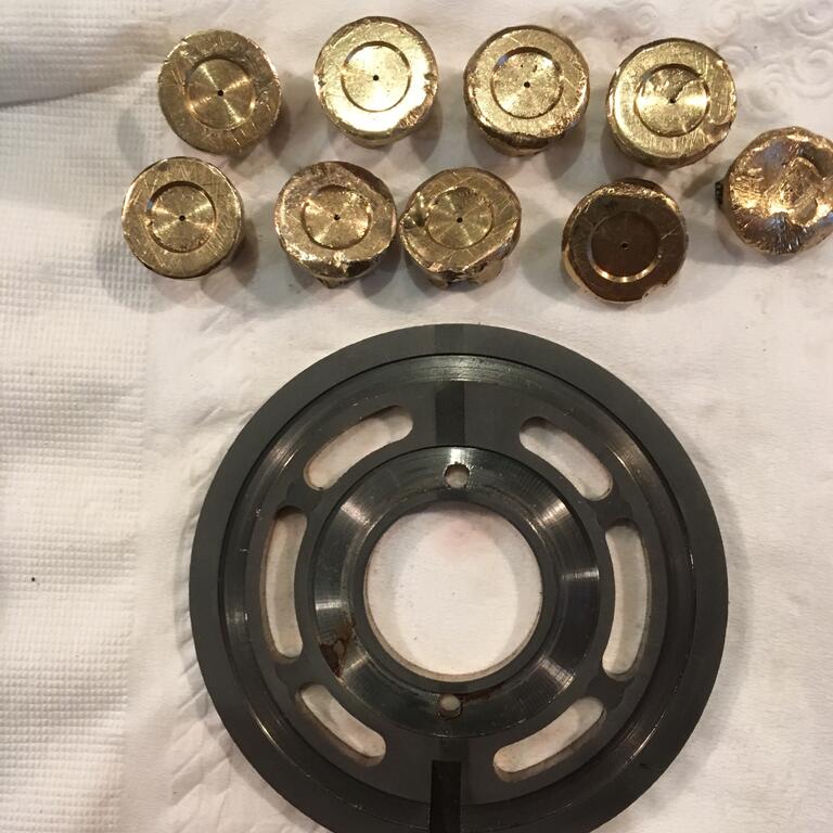

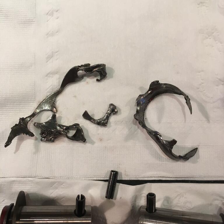

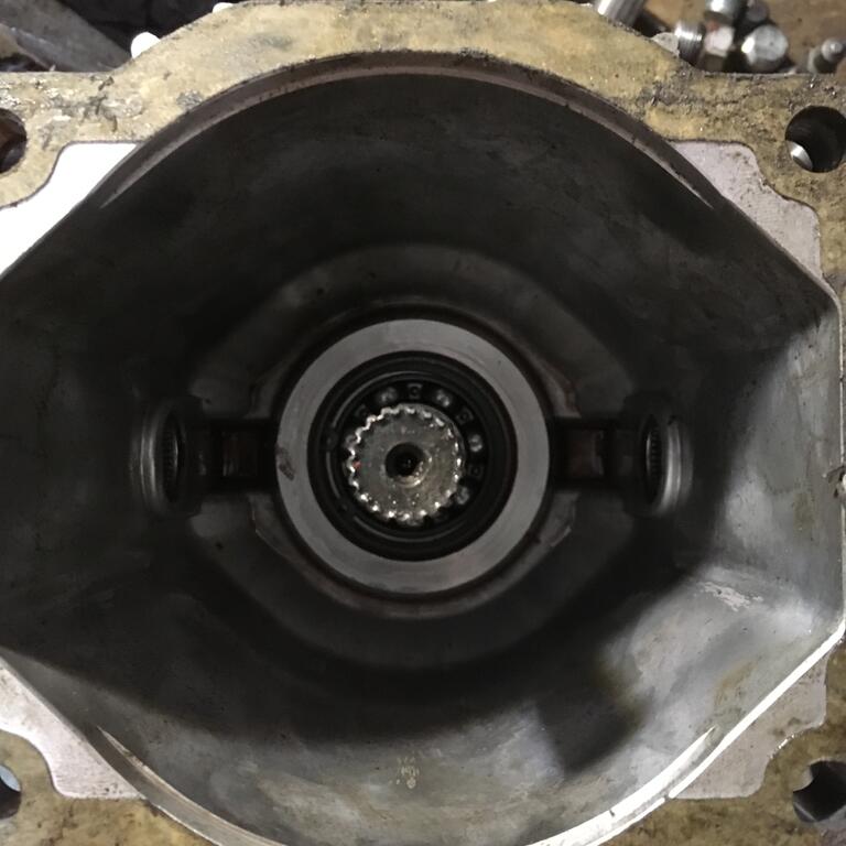

Jrain 276 #1 Posted June 1, 2022 90-1140 Sundstrand , I finally got around to opening up the pump today ,here are some pictures , So take a look and tell me if it can be saved . 2 Share this post Link to post Share on other sites

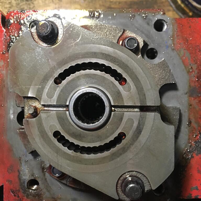

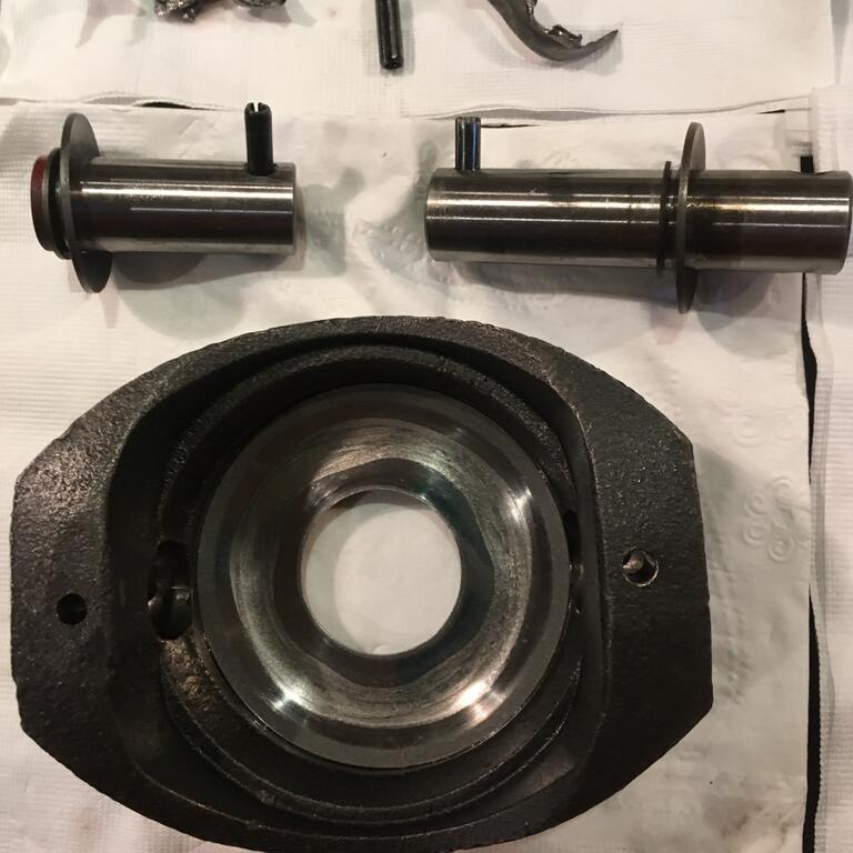

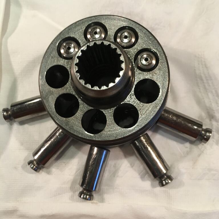

daveoman1966 3,882 #2 Posted June 1, 2022 The 9 pistons & slippers are junk. Take the charge pump housing off and look at the Gerotor set...THAT's what pumps the oil and provides pressure. The swash plate look bad too. The base of the cylinder block looks saveable...but are the cylinder bores damaged...? If so, it too is junk. From what I see, you will also find similar damage inside the Hyd MOTOR...it is attached to the gearbox and shares the common oil. Pull it off and have a look-C. Share this post Link to post Share on other sites
Jrain 276 #3 Posted June 1, 2022 22 minutes ago, daveoman1966 said: The 9 pistons & slippers are junk. Take the charge pump housing off and look at the Gerotor set...THAT's what pumps the oil and provides pressure. The swash plate look bad too. The base of the cylinder block looks saveable...but are the cylinder bores damaged...? If so, it too is junk. From what I see, you will also find similar damage inside the Hyd MOTOR...it is attached to the gearbox and shares the common oil. Pull it off and have a look-C. Yep swash plate is wavy like the sea , cylinder bores look and feel good to my surprise I do not have any experience with this set up but as far as the piston movement in the bore and looks they seem ok is there a bore spec ? , I do have the hydro motor on the bench already , when I opened the pump up and found this catastrophic failure I stopped disassembly ,I did not think it was worth going beyond this point , is this going to be cost effective , because as you say odds are similar damage with in the hydro motor. Share this post Link to post Share on other sites

daveoman1966 3,882 #7 Posted June 2, 2022 5 hours ago, Jrain said: Yep swash plate is wavy like the sea , cylinder bores look and feel good to my surprise I do not have any experience with this set up but as far as the piston movement in the bore and looks they seem ok is there a bore spec ? , I do have the hydro motor on the bench already , when I opened the pump up and found this catastrophic failure I stopped disassembly ,I did not think it was worth going beyond this point , is this going to be cost effective , because as you say odds are similar damage with in the hydro motor. A we3ek or so ago, a guy was lookin' for a replacement motor shaft and some of the internals....his was FUBAR. Forget on what forum though...FB Instagram Red Sq... don't recall. MAYBE he could get parts from you. Share this post Link to post Share on other sites
Jrain 276 #8 Posted June 2, 2022 9 hours ago, daveoman1966 said: A we3ek or so ago, a guy was lookin' for a replacement motor shaft and some of the internals....his was FUBAR. Forget on what forum though...FB Instagram Red Sq... don't recall. MAYBE he could get parts from you. Well I would have to see what direction I am going with this tractor first , and if that direction left me with this unit just sitting , then yes pay for the shipping and I would send him what he needs . Since I know you are well versed with the Sundstrand , I have a question, I do have a good 2046 pump and motor , would there be anyway to use parts from the 2046 and or adapt it to the 90-1140 transaxle . or would finding a 2046 transaxle for the 2046 pump and motor I have be ok behind the Kohler K341 . Share this post Link to post Share on other sites
