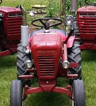

rjg854 12,838 #4 Posted June 1, 2022 (edited) I have tri ribs on the front of my 854 Edited June 1, 2022 by rjg854 Correction 1 Share this post Link to post Share on other sites
