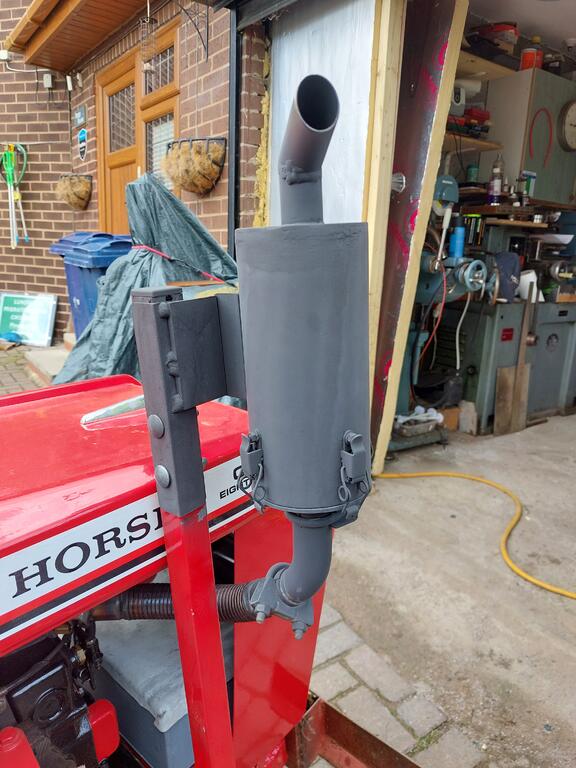

Mickwhitt 5,257 #1 Posted May 31, 2022 Hi all, I have been playing with different silencers / mufflers on the C-125 I made a vertical stack which was great but did make a bit of noise. So I changed to a shorter larger diameter stack with glass wool padding inside. This has lowered the noise level and I'm pretty happy with it. 11 6 Share this post Link to post Share on other sites

Retired Wrencher 6,442 #4 Posted June 1, 2022 Mick that looks like it will be just fine. Myself I like a low noise runner. I use when I can find them an old Gravley muffler. Enjoy the ride. 3 Share this post Link to post Share on other sites
Mickwhitt 5,257 #5 Posted June 1, 2022 The cannister is all home made, I bought a length of mild steel tube and made up end plates on the lathe. One was brazed in place for the outlet and the other was made with a step to sit just inside the can so I could fasten it with those sprung clips. That way I can fill it with glass wool to try different amounts. The inlet pipe also has a perforated tube inside the cannister to help with noise. I was happy with the stainless steel stack but fancied a change. Mick 4 Share this post Link to post Share on other sites
