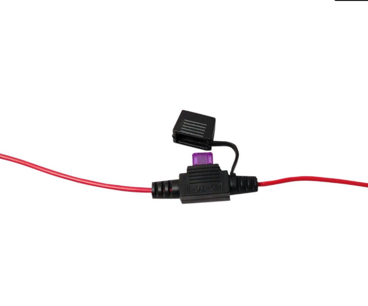

Achto 29,857 #7 Posted May 27, 2022 (edited) 1 hour ago, Mike C160 said: I also have a proper spare amp gauge I can put in too. I would forget the amp meter and keep the volt meter. If an amp meter shorts out it can start your wiring on fire. If a volt meter fails it just quite working. I replace all of my amp meters with volt meters. If you are going to keep the amp meter install a fuse on the power "in" side of the meter. 1 hour ago, Mike C160 said: Do the regulators fail much? Not an uncommon occurrence. If you have good AC voltage but only battery voltage (not charging) then you have one of these issues. 1 - The regulator has a bad ground. 2 - There is no "+" DC power getting to the center or lower DC terminal on the regulator when the switch is in the "ON" position. 3 - You have a bad regulator. Edited May 27, 2022 by Achto 5 Share this post Link to post Share on other sites
Mike C160 251 #8 Posted May 27, 2022 1 hour ago, Achto said: I would forget the amp meter and keep the volt meter. If an amp meter shorts out it can start your wiring on fire. If a volt meter fails it just quite working. I replace all of my amp meters with volt meters. If you are going to keep the amp meter install a fuse on the power "in" side of the meter. Not an uncommon occurrence. If you have good AC voltage but only battery voltage (not charging) then you have one of these issues. 1 - The regulator has a bad ground. 2 - There is no "+" DC power getting to the center or lower DC terminal on the regulator when the switch is in the "ON" position. 3 - You have a bad regulator. Amp meter fuse. Noted. I will pick up 2 new fuse links next time im in town. Share this post Link to post Share on other sites

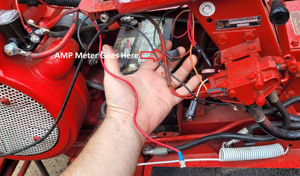

Mike C160 251 #9 Posted May 27, 2022 Well, Its charging again. And it wasnt just one thing. Apart from the regulator being toast, I dont know why they did it, they had wiring messed up at the ignition switch too. The fact it started and ran was a miracle. But Accessories was mixed up with regulator out put..... I can only assume this mess fried the Reg. I can clearly see they were working at that plug at the back of the ignition switch. Those connectors were in and out of that plug a few times. I can only guess the amp gauge failed and left everything dead. I stole the gauge panel and reg from my 8 speed for now to verify everything is now correct. So now to neaten it all up so it looks clean. All new connections are soldered and heat shrunk. I dont expect further issue. Maybe someday I;; get to cut the grass with it. 1 1 Share this post Link to post Share on other sites

Mike C160 251 #11 Posted May 27, 2022 5 minutes ago, peter lena said: @Mike C160 very good ground source start point ,is your battery negative cable bolt down point . separate wire to ground related areas . added that to , dash , headlights , rectifier , electrical mounting points , all reliably working , keep it sparky , pete I hear you. Grounding hasnt yet been a direct issue but as I go I have been removing paint to ensure things that need ground get a good one. There is a heavy ground cable from the battery to the base of the motor. Its too long. I will get some short ones and ground the motor and the frame. Right now as things stand everything electrical are wired and work properly. Even the tail light My poor 8 speed has suffered I have robbed some parts from it to get thru all this. I will have to do some ordering to get that one back on line. But the 8 speed motor is due for rebuilding this winter as it burns some oil and crank case pressure is high. Cheers and Thanks. Share this post Link to post Share on other sites

Mike C160 251 #13 Posted May 27, 2022 8 minutes ago, pacer said: This is highly recommended!! That darn amp gauge on yours couldve very easily caused the whole cascading of your problems. You asked about regs failing, of the 4-5 that I have had fail all were directly tied to the ammeter! One of the first things I rip out of a 'new' tractor is that blankedy blank ammeter!!! Tell me, What with the amp meter fails? Does it not just go open? Blankedy blank - Thems some strong words Cheers Share this post Link to post Share on other sites
Achto 29,857 #14 Posted May 27, 2022 4 minutes ago, Mike C160 said: What with the amp meter fails? Does it not just go open? They fail & end up shorting out to the body of the gauge. Creating a dead short. 3 Share this post Link to post Share on other sites
Mike C160 251 #15 Posted May 27, 2022 8 minutes ago, Achto said: They fail & end up shorting out to the body of the gauge. Creating a dead short. OK Now I understand. I have two of them here and they are both plastic body. a 1975 and 1977 C160. Could wheel horse of upgraded them after discovering this issue? 1 Share this post Link to post Share on other sites
8ntruck 8,155 #16 Posted May 27, 2022 25 minutes ago, Achto said: They fail & end up shorting out to the body of the gauge. Creating a dead short. Ah. That might explain one of the electrical 'fixes' on my C195. The PO obtained it just before the scrap guy. He tinkered with it enough to get it running. Said it kept blowing a fuse. I found the ammeter jumped out. I've left it that way knowing that it could be the cause, and I haven't taken the time to trouble shoot it. Now I know what to look for. 1 Share this post Link to post Share on other sites
Achto 29,857 #17 Posted May 27, 2022 9 minutes ago, Mike C160 said: Could wheel horse of upgraded them after discovering this issue? This is a possibility. Share this post Link to post Share on other sites

Mike C160 251 #20 Posted May 28, 2022 (edited) 1 hour ago, Achto said: This is a possibility. I dont see a way these plastic backed one would short. Even the mounting system they used with these are short proof. Worst that could happen is they go open. But I certainly understand how the metal backed ones could get exciting in a hurry Along with the run from the battery to the gauge not being fused. That was a bit of a boo boo. My gauge is plastic and cant short, but imma still gonna put a fuse block in that lead. Prolly one of those GM style fuse holders incased in rubber. Install it right at the source. Edited May 28, 2022 by Mike C160 2 3 Share this post Link to post Share on other sites
