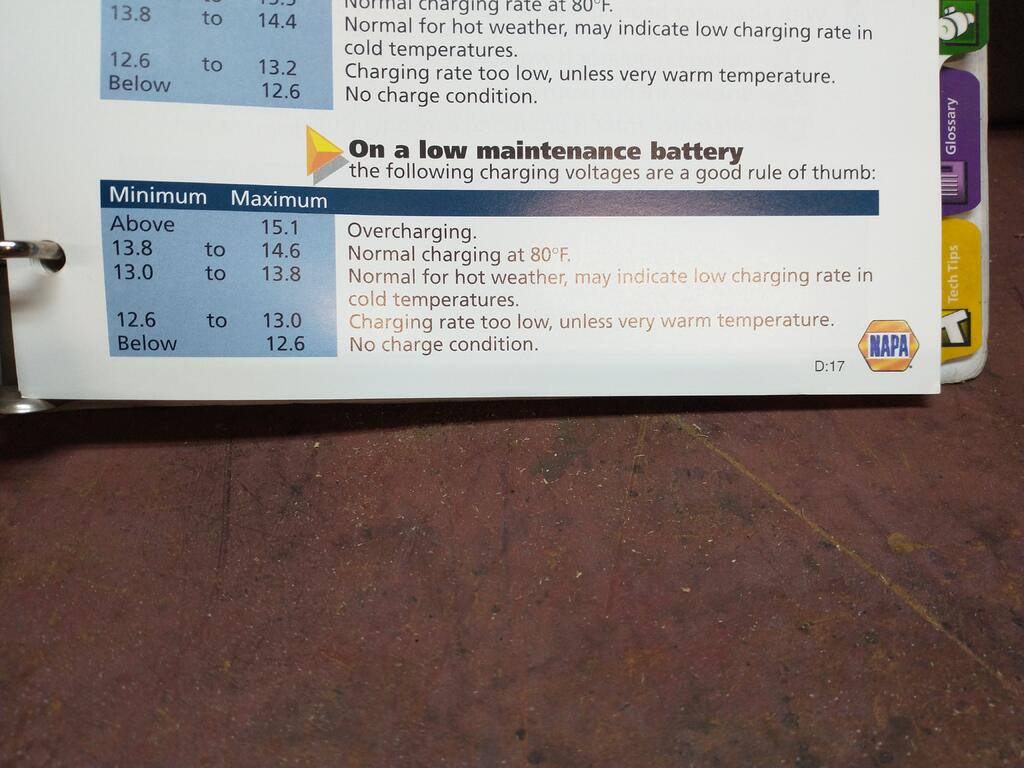

squonk 44,859 #6 Posted May 27, 2022 General rule of thumb. Your milage may vary! 1 Share this post Link to post Share on other sites
ebinmaine 75,694 #7 Posted May 27, 2022 9 minutes ago, squonk said: General rule of thumb Excellent chart Mike. Thanks for posting that. I edited my first post. Share this post Link to post Share on other sites

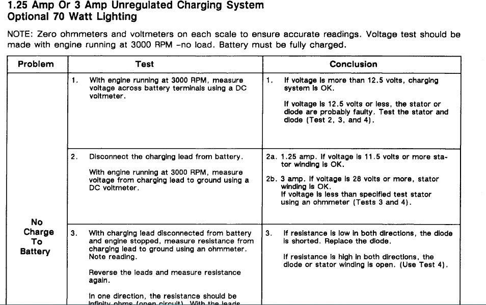

pfrederi 19,243 #9 Posted May 27, 2022 Kohler manual is your friend. At 3000 RPM a voltage of more than 12.5 means system is operating properly. 1 Share this post Link to post Share on other sites

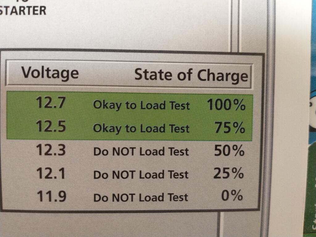

squonk 44,859 #10 Posted May 27, 2022 Considering 12.5 volts is 75% charged, that isn't much of a charging system. 1 Share this post Link to post Share on other sites
