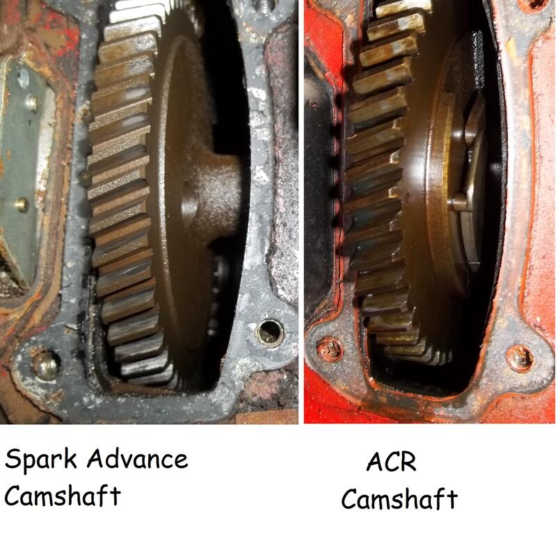

953 nut 68,519 #32 Posted May 25, 2022 So glad you found the problem prior to needlessly going into the engine. For future reference the ACR mechanism can be seen with the cam gear cover, The springs don't show in this photo but can be examined with a small inspection mirror. 1 Share this post Link to post Share on other sites

Mike C160 251 #35 Posted May 25, 2022 44 minutes ago, 953 nut said: So glad you found the problem prior to needlessly going into the engine. For future reference the ACR mechanism can be seen with the cam gear cover, The springs don't show in this photo but can be examined with a small inspection mirror. Pictures are worth a thousand words for sure. Thanks. I think i can see the tab of the spring bent over the weight... Cheers. 1 Share this post Link to post Share on other sites
