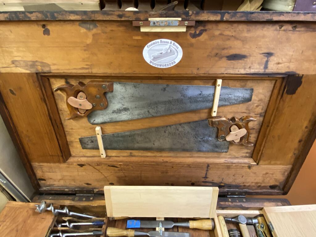

formariz 12,381 #26 Posted June 3, 2022 Starting to visualize all the tools that I want to put in box. Decided to make a few additions to it without altering the existing in order to fit and organize everything. I will leave all repairs and new additions looking as they are without staining them so changes are obvious adding to the story of box for future generations. Still have a few boards of old growth long leaf pine which is actually what most of box is made off. They are totally clear with perfectly straight grain. They are a pleasure to work with, leaving their scent through out house. 4 1 Share this post Link to post Share on other sites

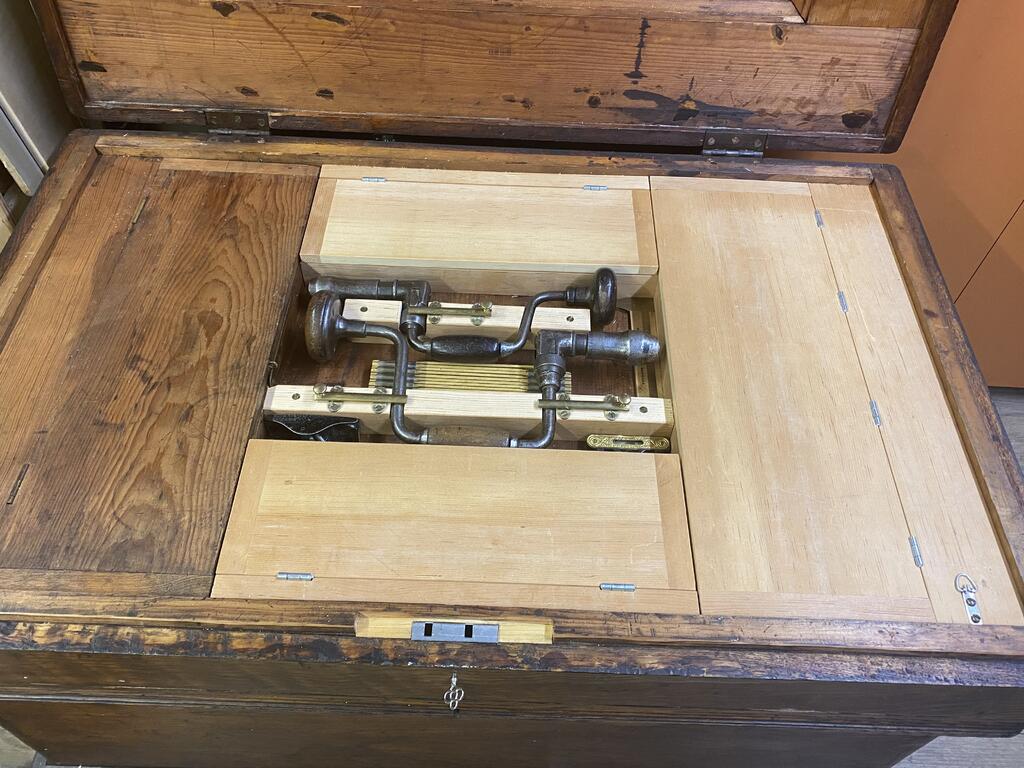

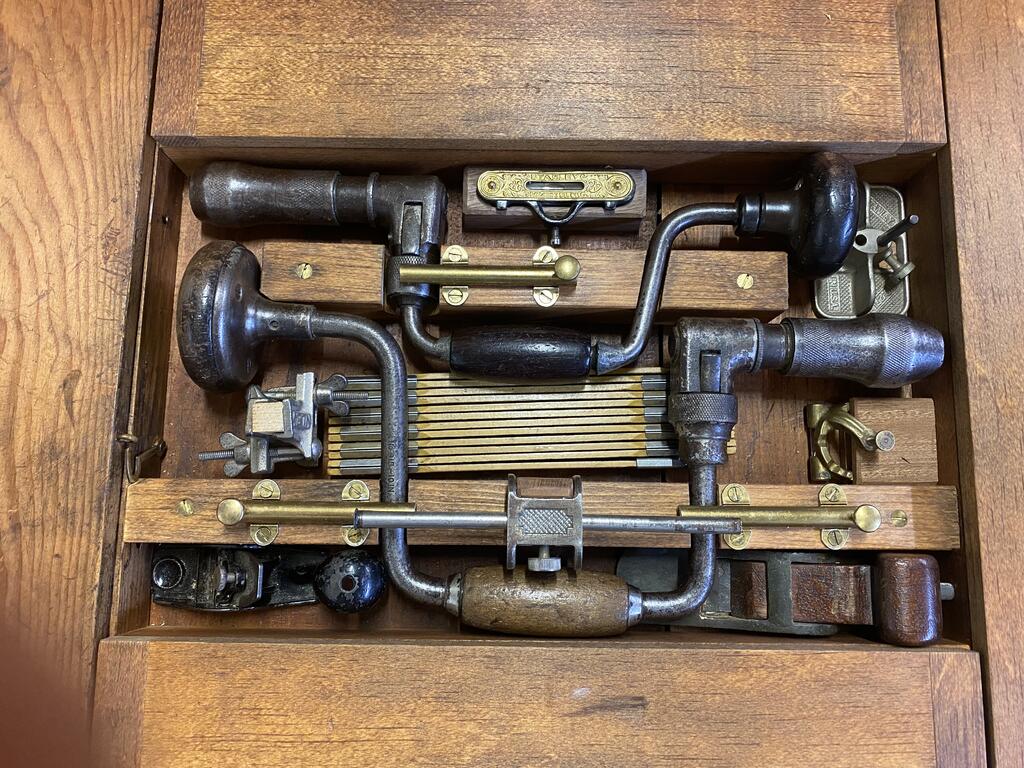

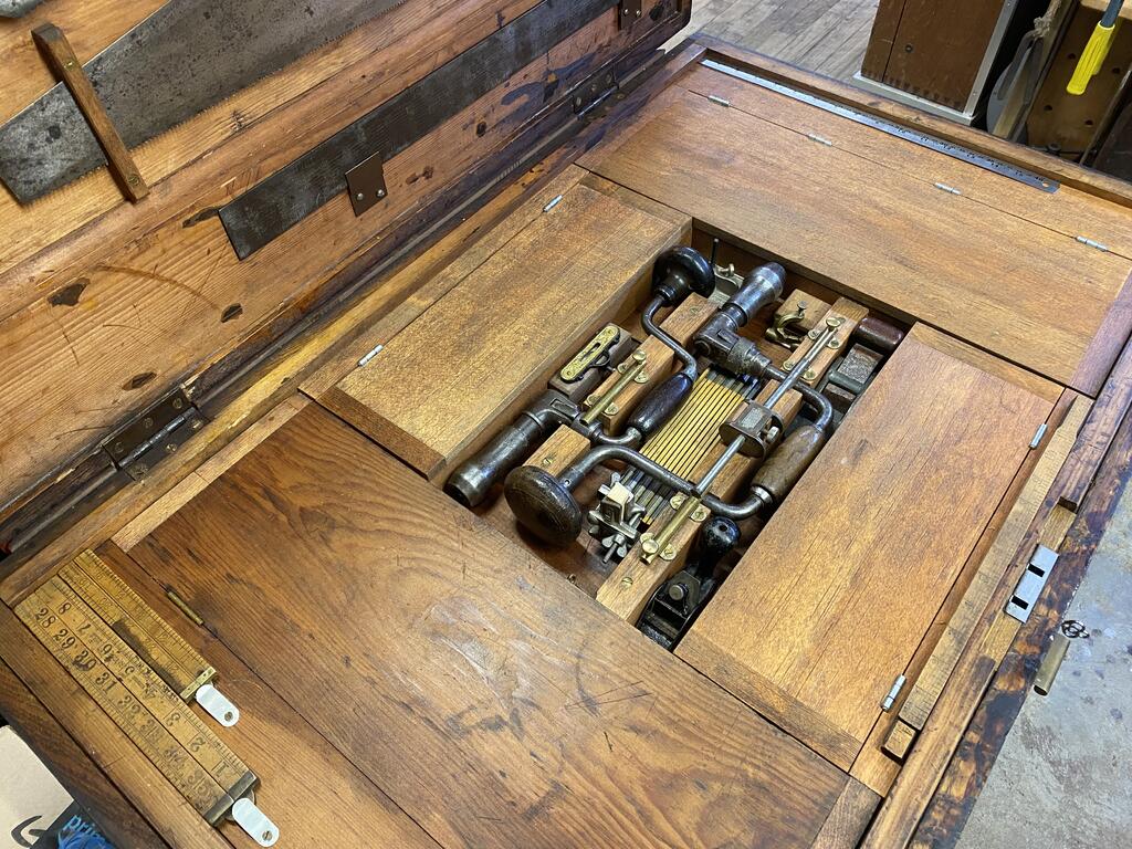

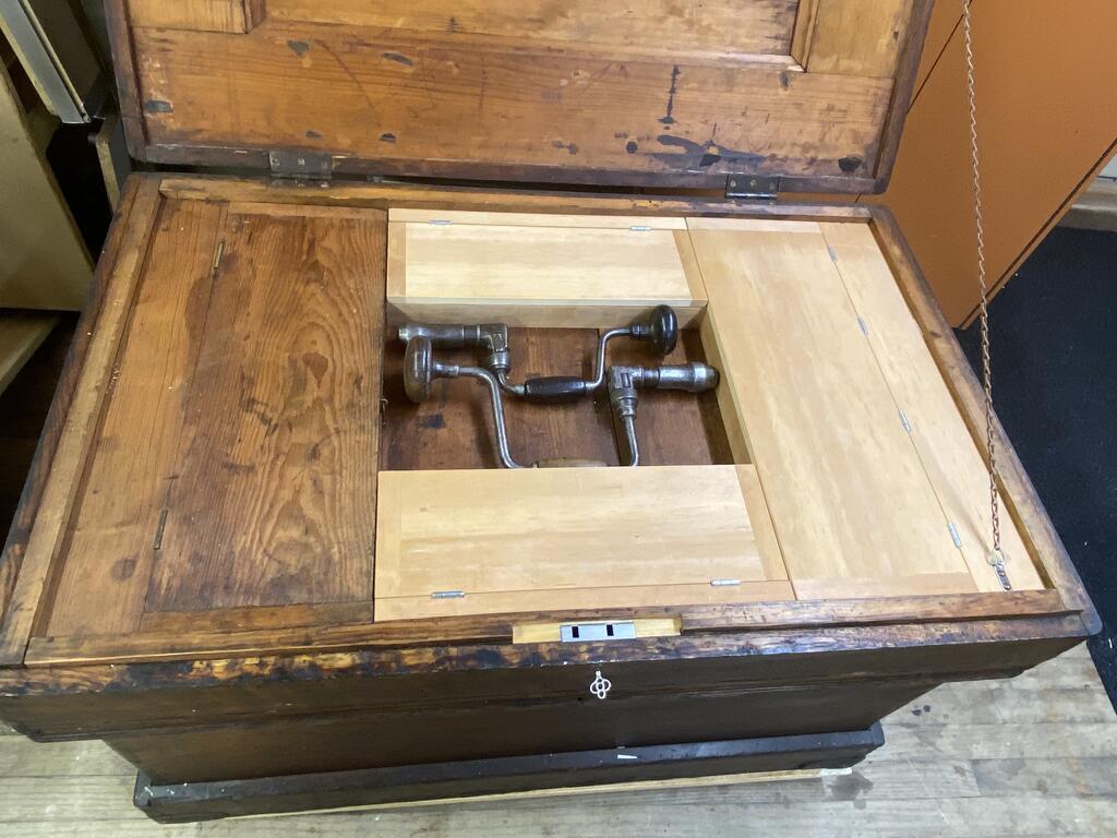

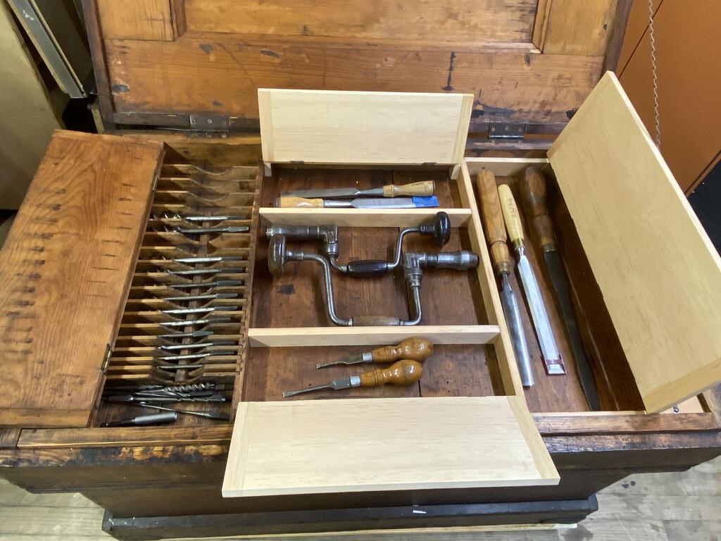

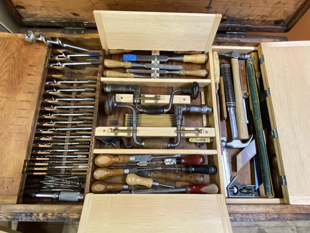

formariz 12,381 #27 Posted June 3, 2022 (edited) New compartments for second lid made. Only now need to make some dividers for chisels and hold downs for braces . Most frequently used tools will be on this lid such as chisels screwdrivers , etc. First lid will have a couple of most frequently used handsaws. Edited June 3, 2022 by formariz 3 4 3 Share this post Link to post Share on other sites

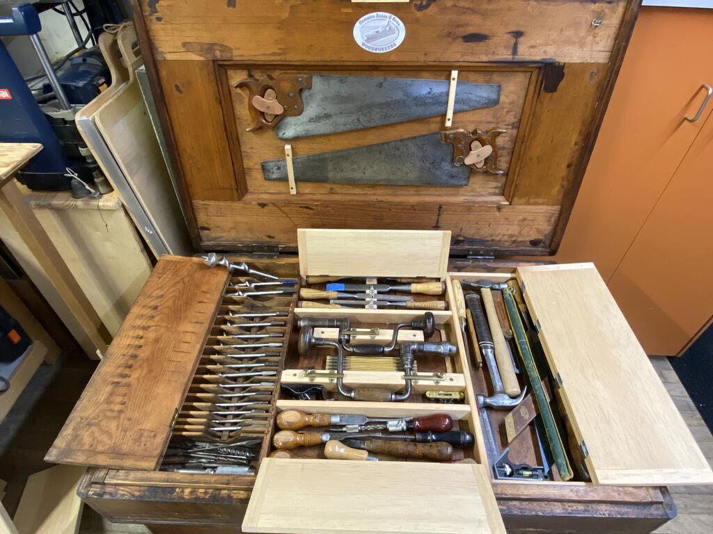

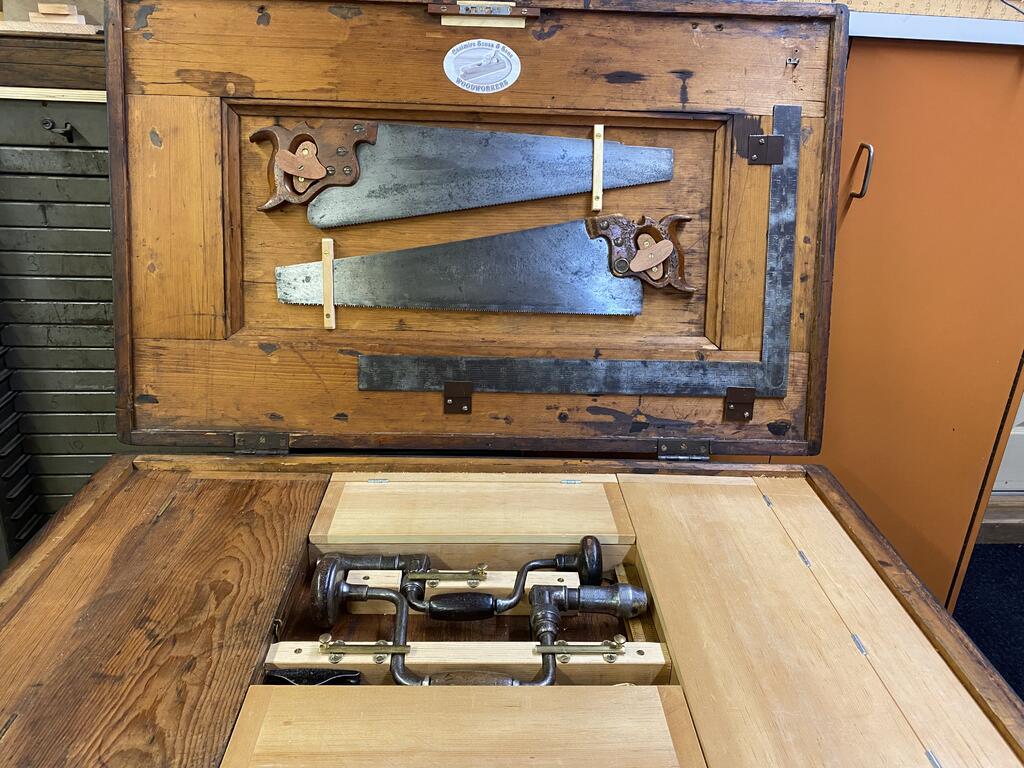

formariz 12,381 #28 Posted June 10, 2022 Most frequently used tools will be on lids. Still lots of little spaces for more. 1 8 1 Share this post Link to post Share on other sites

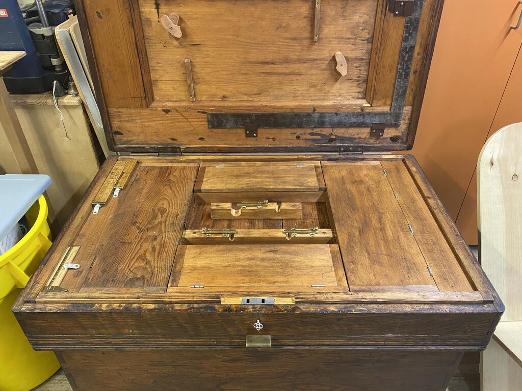

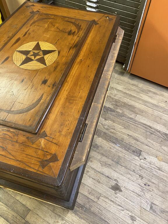

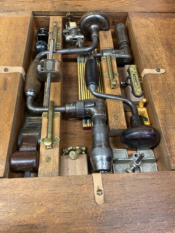

formariz 12,381 #29 Posted June 12, 2022 Working my way into the chest body. Underside of second lid made useful also. First lid Second lid underside 4 6 Share this post Link to post Share on other sites

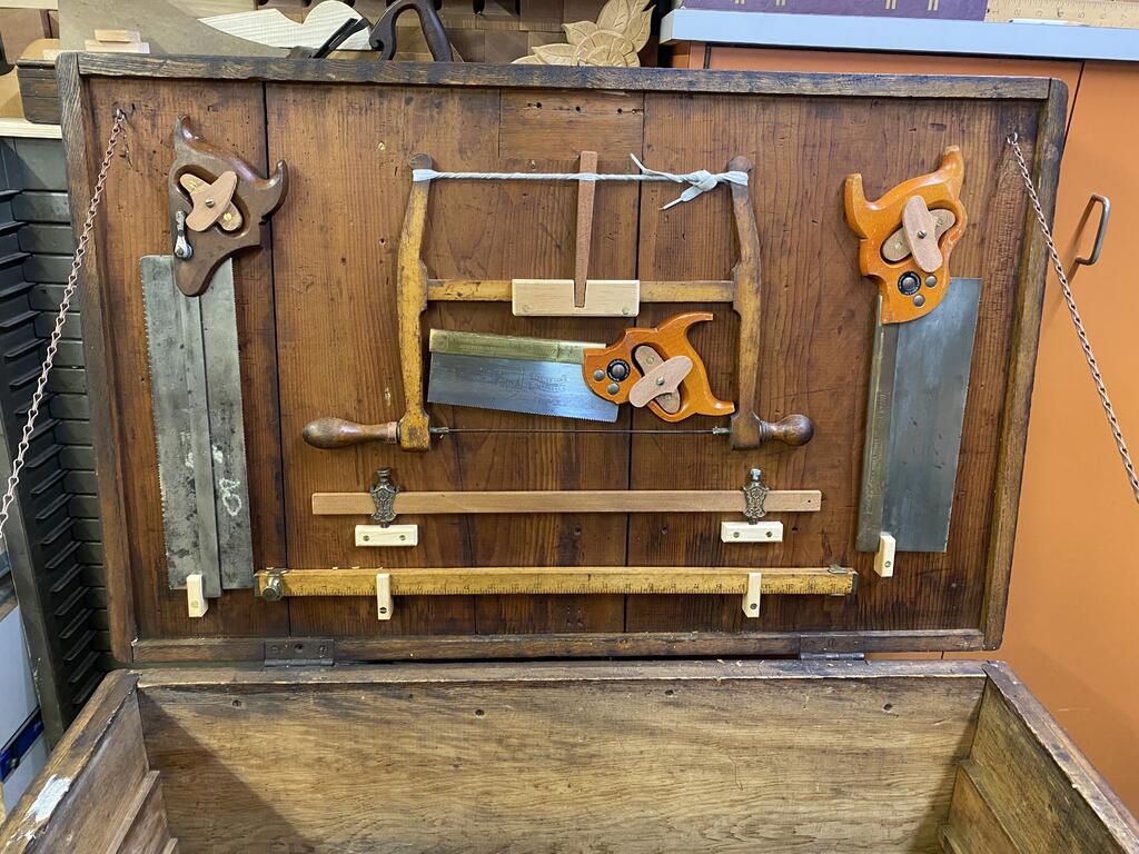

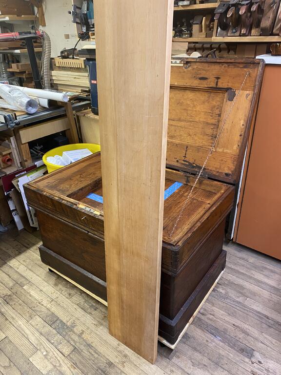

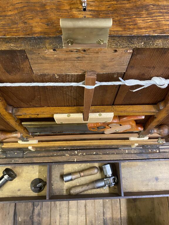

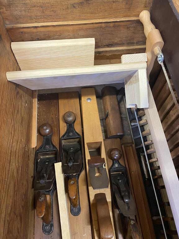

formariz 12,381 #30 Posted June 13, 2022 (edited) Chain to hold first lid was proving troublesome after new compartments addition since there was no longer much space for it with lid closed. Decided to resort to a simple tried and true method used in the late 1700s. Old methods never fail. Edited June 13, 2022 by formariz 1 5 1 Share this post Link to post Share on other sites

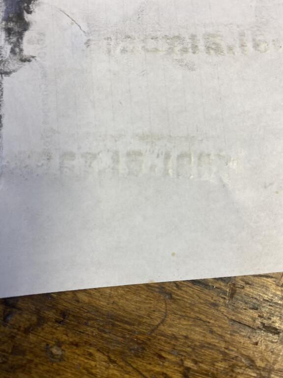

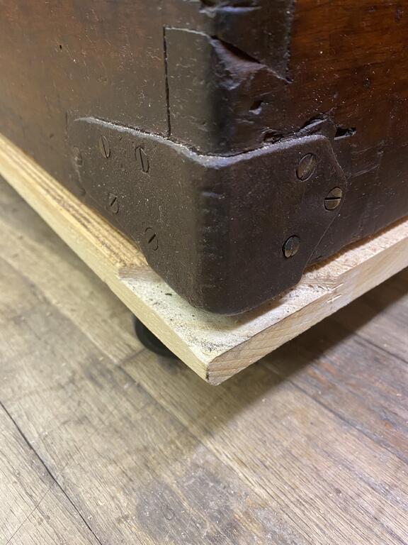

formariz 12,381 #31 Posted June 14, 2022 Chest has some substantial corner protectors on bottom pretty cleverly designed since they will keep bottom of chest off floor. I had noticed that they had some inscription on the very corners as oar of casting. They are somewhat worn specially towards the bottom from the obvious reason. However I was able to take a pretty good imprint of the best one. What is in there is essentially the patent date for them. It is Oct.15.1863. Along with other features this establishes a pretty accurate date for chest’s construction making it now around 159 years old. 2 4 Share this post Link to post Share on other sites

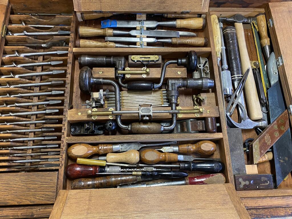

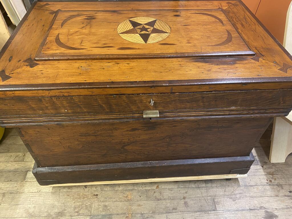

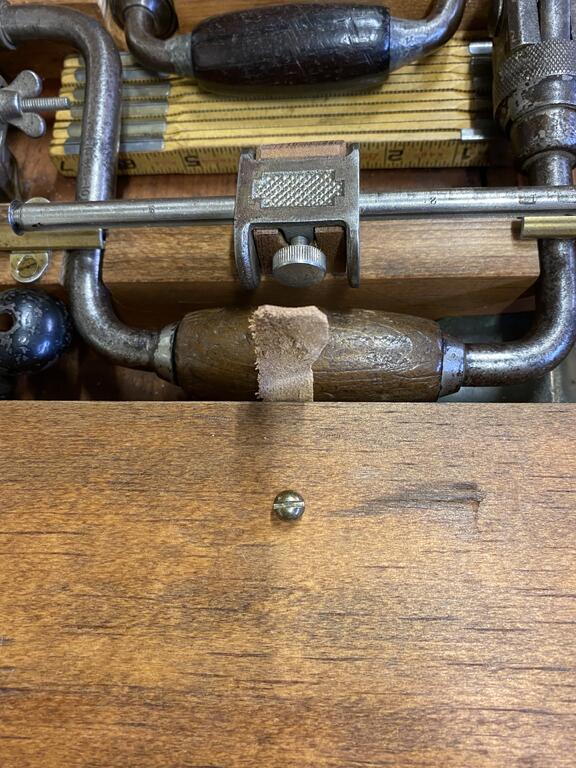

formariz 12,381 #34 Posted June 15, 2022 (edited) New compartments? What new compartments? Decided to instead blend them in so as to keep chests dignity. A list of all changes or additions will be inside of it for future generations. Edited June 15, 2022 by formariz 6 3 Share this post Link to post Share on other sites

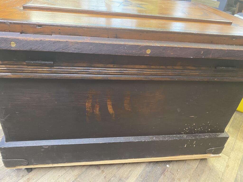

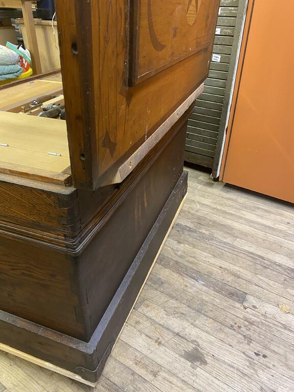

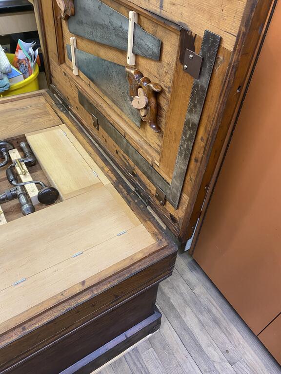

formariz 12,381 #37 Posted June 15, 2022 One will essentially be able to work just out of second lid due to all of the tools now in it. However it did make the lid too heavy to lift and lower safely without any provisions for that. Empty it is already a bit difficult to grab properly. Had to introduce a small handle to help with it which works really well without being too obvious. Will oxidize it a little more to make it look more like it has always been there. At sometime in its life box body was stained quite a bit darker . Most were actually painted. I believe it may have been done after it came out of originals owners hands. Back is still dark but strangely enough there are no signs of rest of box have been stained and stripped. There are “rub off “ marks on back from fingers. Quite possibly also that someone started on back and did not like the looks and left it that way. Box has always been used against a wall to hold lids since there are no signs of provisions for a chain or anything like it that would hold lids and aging on back substantiates how it placed during its life. Blended in lid stop to match aging on back. 1 4 Share this post Link to post Share on other sites

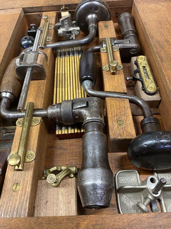

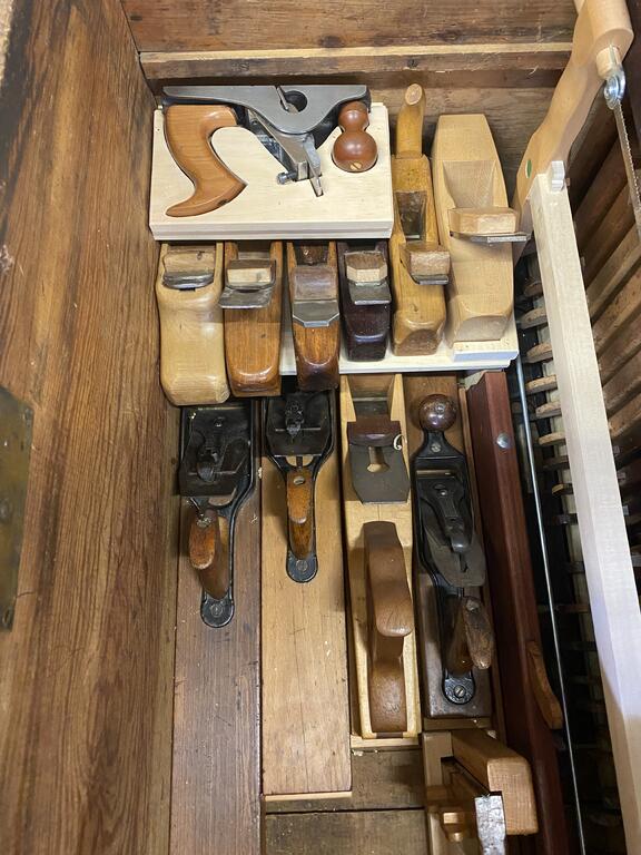

formariz 12,381 #42 Posted July 12, 2022 Still working on filling the two lids with tools as I think of which ones to use. Basic idea on the lids is to have all of the necessary tools to perform most tasks without having to go into the well of chest. Rather than just randomly “throw “ tools into it, for the majority of them they are given dedicated secure places conveniently placed according to the frequency of use. Although I will be working out of this chest , in the very least it already has a destiny for the next two generations . At the completion of its furnishings , placed in it , there will be an inventory of every single tool present ,along with how they came to me since a lot of them were given to me by individuals who had a great influence in my work and life. 1 4 5 Share this post Link to post Share on other sites

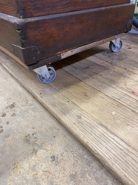

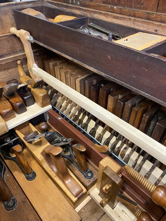

formariz 12,381 #43 Posted July 15, 2022 Fitted better more appropriate wheels. Started fitting chest’s well with tools . Next will build the remaining sliding saw and tool tills. 2 3 Share this post Link to post Share on other sites

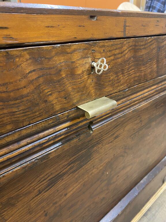

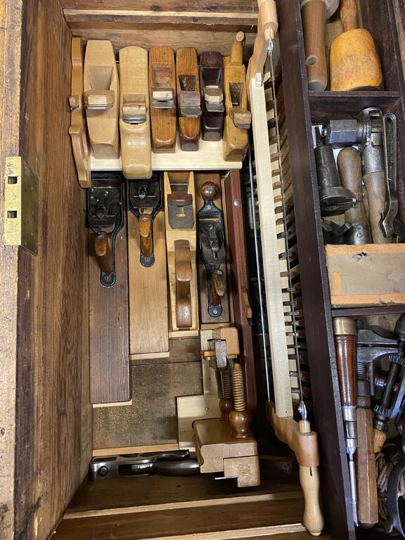

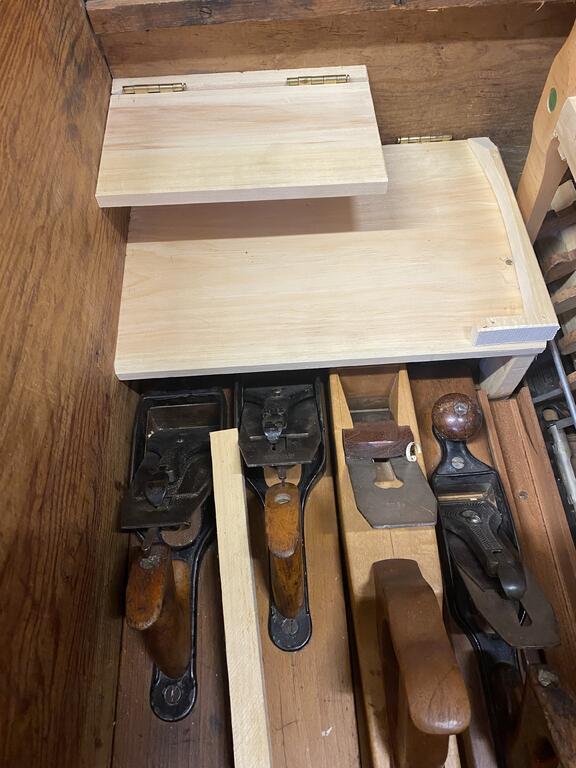

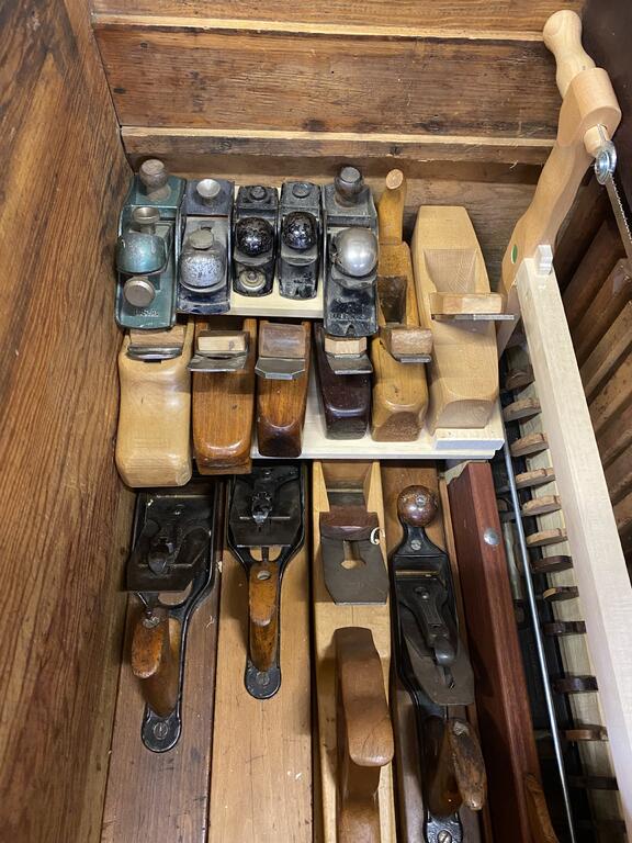

formariz 12,381 #45 Posted July 18, 2022 Trying to utilize all space available but not having to remove a tool in order to get to another. Added two additional shelves for planes. Not sure which planes will reside on top one yet. These are hinged so they can be lifted for cleaning or access any dropped item on bottom of chest. Not really needed but added “custom” latches for lids. 3 5 Share this post Link to post Share on other sites
