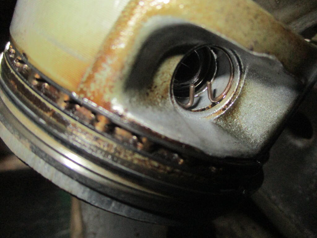

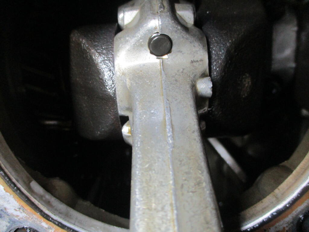

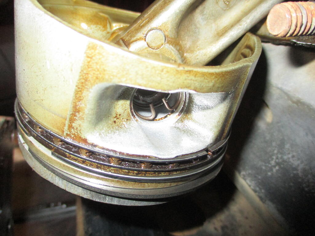

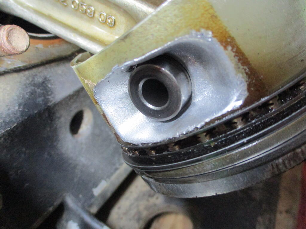

johnnymag3 2,647 #27 Posted June 13, 2022 UPDATE on clacking noise.....I took the nuts off of the cylinder jug which had the piston angling in the bore and slid it carefully off.....Guess what I found....Piston pin clip missing, pin not even in the one side of the piston.. No rod issues ..., but going to need a piston, Std. bore....also rings and cylinder jug...Std. bore. Where might I find any of this stuff??? Anyone here with good used M18 parts??? isave tractors has some stuff, but no Std. bore pistons or jugs John 2 Share this post Link to post Share on other sites

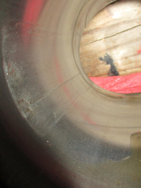

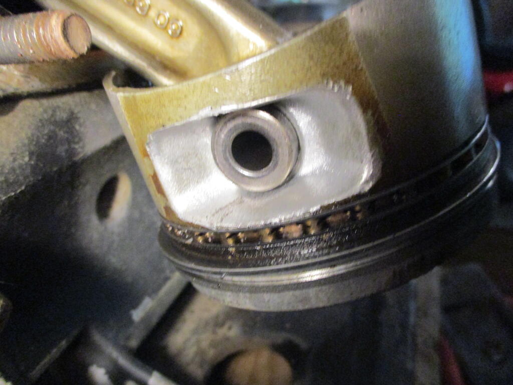

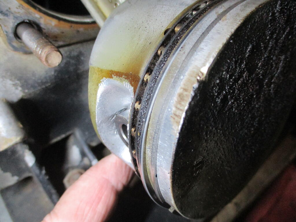

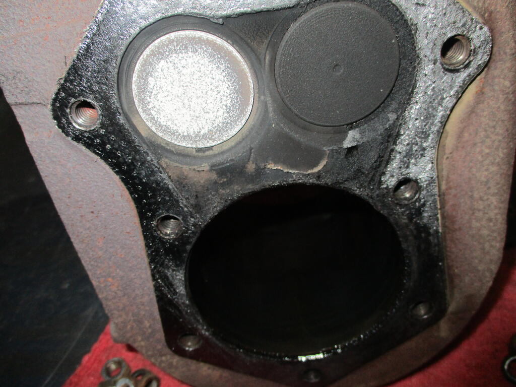

johnnymag3 2,647 #30 Posted June 13, 2022 It appears they were shredded and possibly spit out the exhaust valve??? or shredded and into oil.....I have pics to post....there is no sign of clip, albeit the thinnist little thing to begin with.. The pison is beat up in that cavity, and also the cylinder wall has a nice score,,,, UNKNOWN..... 1 Share this post Link to post Share on other sites

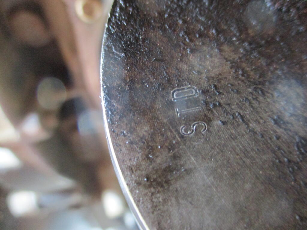

johnnymag3 2,647 #33 Posted June 13, 2022 Pictures.....cuz we love them........ Share this post Link to post Share on other sites
Jeff-C175 7,211 #34 Posted June 13, 2022 43 minutes ago, johnnymag3 said: Pictures.....cuz we love them........ Boy, that's discouraging! I think you can see marks where the pieces of the clip snuck past the piston. Share this post Link to post Share on other sites
johnnymag3 2,647 #35 Posted June 13, 2022 3 minutes ago, Jeff-C175 said: Boy, that's discouraging! I think you can see marks where the pieces of the clip snuck past the piston. Indeed.........still ran well.....Glad I popped it apart whem I did....It will run again ? Share this post Link to post Share on other sites
RED-Z06 2,720 #36 Posted June 13, 2022 32 minutes ago, johnnymag3 said: Indeed.........still ran well.....Glad I popped it apart whem I did....It will run again ? Itll run but compression will always get past the rings in those gouges. Is it worth punching out..? No... Share this post Link to post Share on other sites
