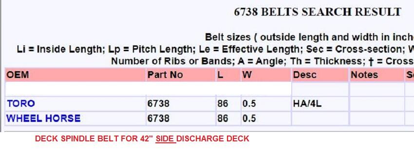

gwest_ca-(File Mod) 11,852 #4 Posted May 14, 2022 Mower belts have been added to this page. Click on the fuzzy picture to see them. 1 1 Share this post Link to post Share on other sites

daveoman1966 3,881 #6 Posted May 14, 2022 The correct SPINDLE BELT for the 05-42SC-02 is OEM #6738 (86" x 0.5") ....as per the Toro MPV. If this belt doesn't fit right, either (1) the belt tension pulley is stuck (MUST) be free floating...or (2) it is the wrong size pulley...aka not OEM. ps...the FREE FLOATING flat bar that the Idler Pulley is mounted on MUST absoultely be FREE-FLOATING. The grease zerk you need is #1030. To prevent future breakage of this grease zerk, use a die grinder and trim off 1/4" or so of the 'pointy end' of the lift rod that is near it... 1 Share this post Link to post Share on other sites
