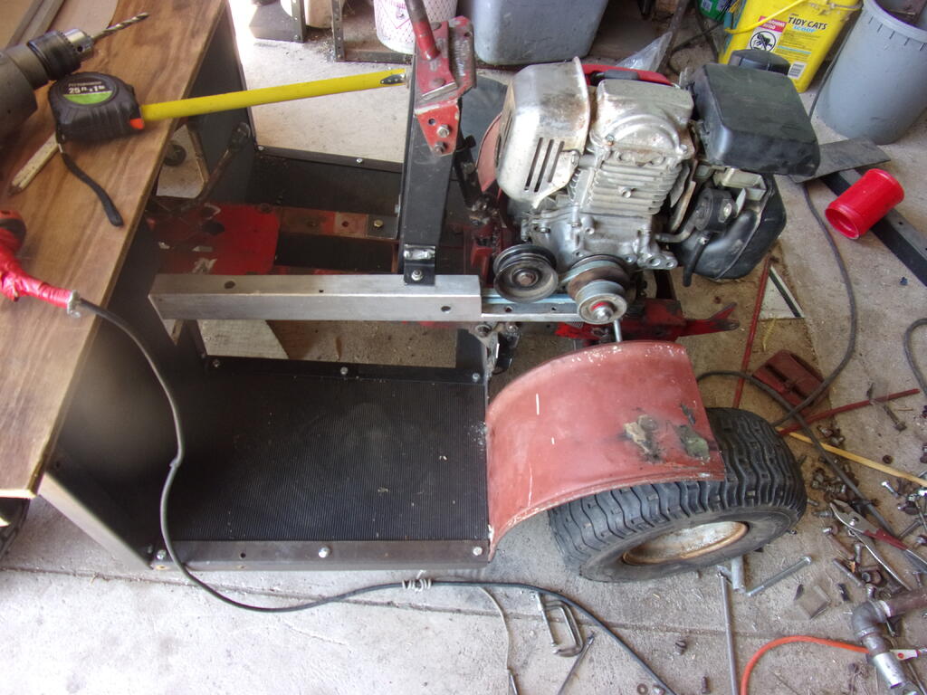

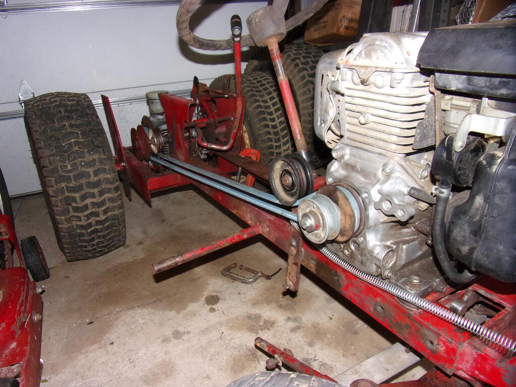

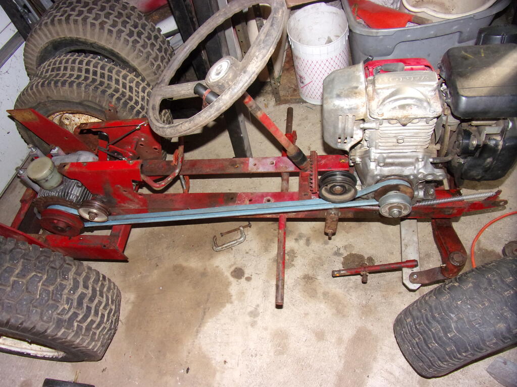

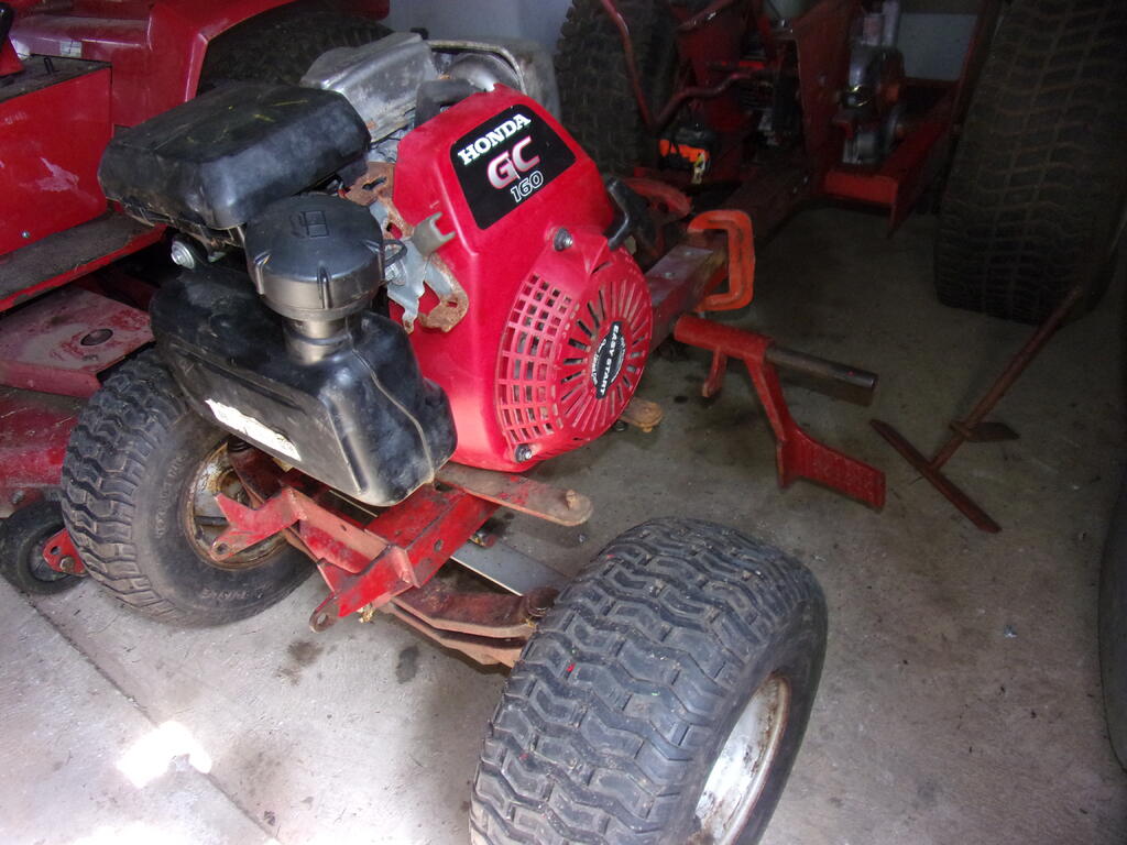

Ed Kennell 47,023 #27 Posted May 16, 2022 Wo got power. I picked up this little Honda 160GC for $60 today. It's small but 5HP should take me to my deer stand. It's a one pull start and it fits under the hood nicely. I played with rear mount, but decided front mount would be easier and the front weight is a plus. Got the Eaton cleaned up and gave her a pressure wash. 9 6 Share this post Link to post Share on other sites

Ed Kennell 47,023 #33 Posted May 20, 2022 It's alive. Got the Honda aligned and mounted. Full forward @ WOT she moves at a fast walk.... perfect for a show ride around. Now to build a steering /hood support, then a seat and some foot rests. 7 1 Share this post Link to post Share on other sites

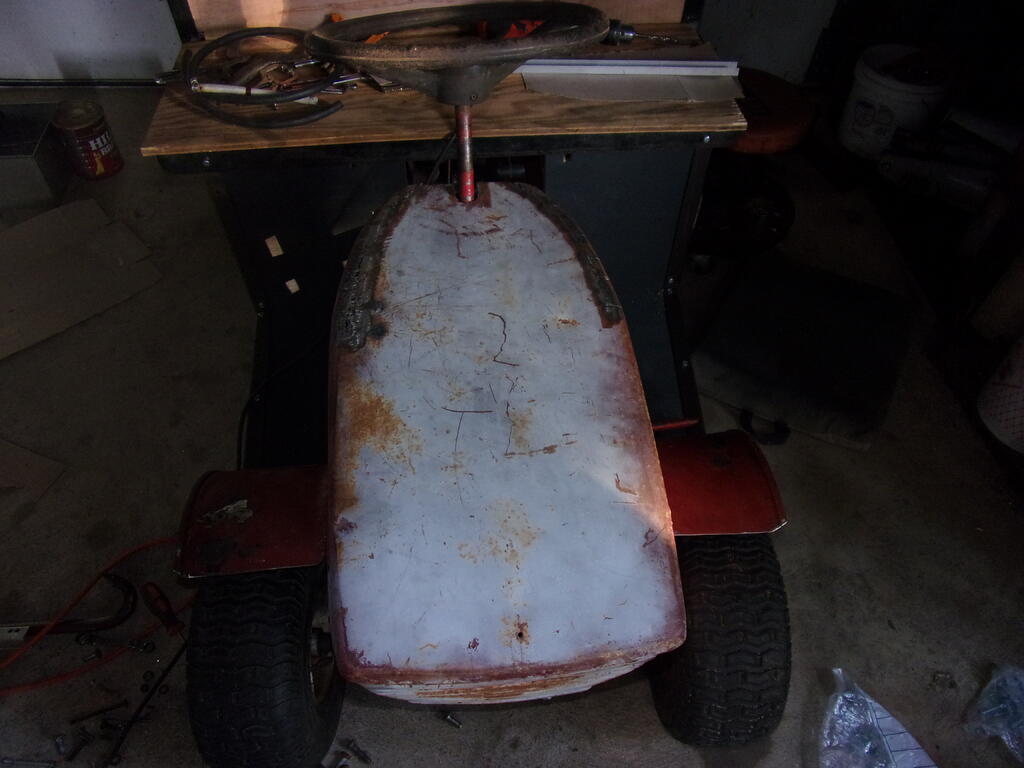

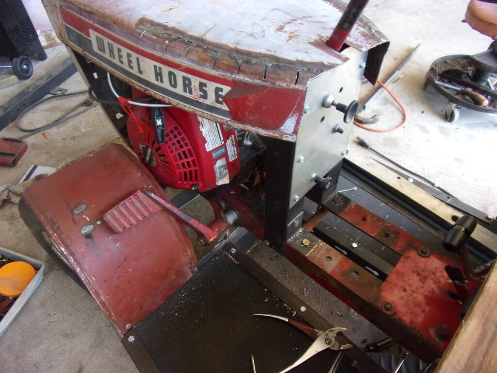

Ed Kennell 47,023 #34 Posted June 13, 2022 Little pick up is coming along. Finished the floor boards and front fenders. Started the hood mod today. 8 5 1 Share this post Link to post Share on other sites

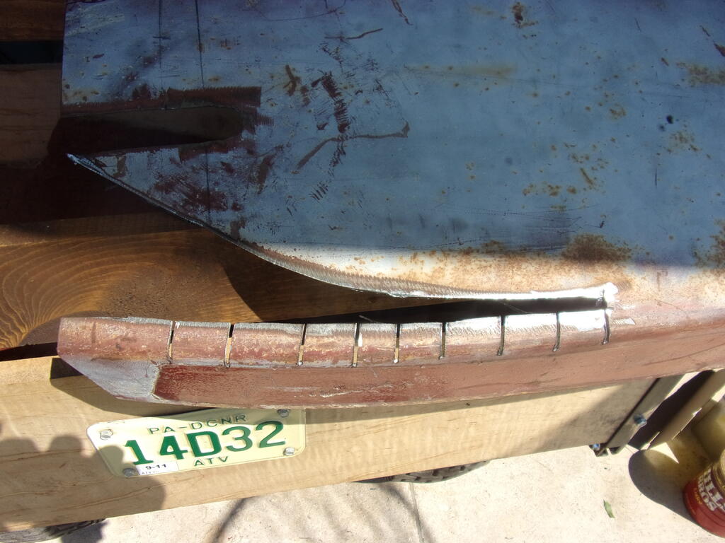

oliver2-44 11,701 #39 Posted June 15, 2022 On 6/13/2022 at 6:18 PM, Ed Kennell said: Little pick up is coming along. Finished the floor boards and front fenders. Started the hood mod today. Kind of a round hood/square hood 4 1 Share this post Link to post Share on other sites
Ed Kennell 47,023 #40 Posted June 15, 2022 11 hours ago, wallfish said: Nice job Ed! I like that look you did and probably give ya some leg room too. Good idea. Don't think my new custom is going to be ready to bring but still working on it when I can. Much appreciated coming from the Hammer Guru...thanks John. Leg room is limited and rounding the back corners of the hood really did help. The long leggers will have to ride on the tailgate, but me 5'8" and Mrs K 5'3" fit up front just fine. I really didn't plan to build this in time for this years show, but when I got an offer on the low rider dragster that I couldn't refuse, I stepped up the pace to build this one. I usually reserve April, May, and June for trout fishing, turkey hunting ,and lawn mowing, with 3-4 tractor shows mixed in. So all this extra work is getting old. As soon as the Big Show is over, I'll be ready for a two week vacation of crabbing on the Delaware Bay. 5 Share this post Link to post Share on other sites

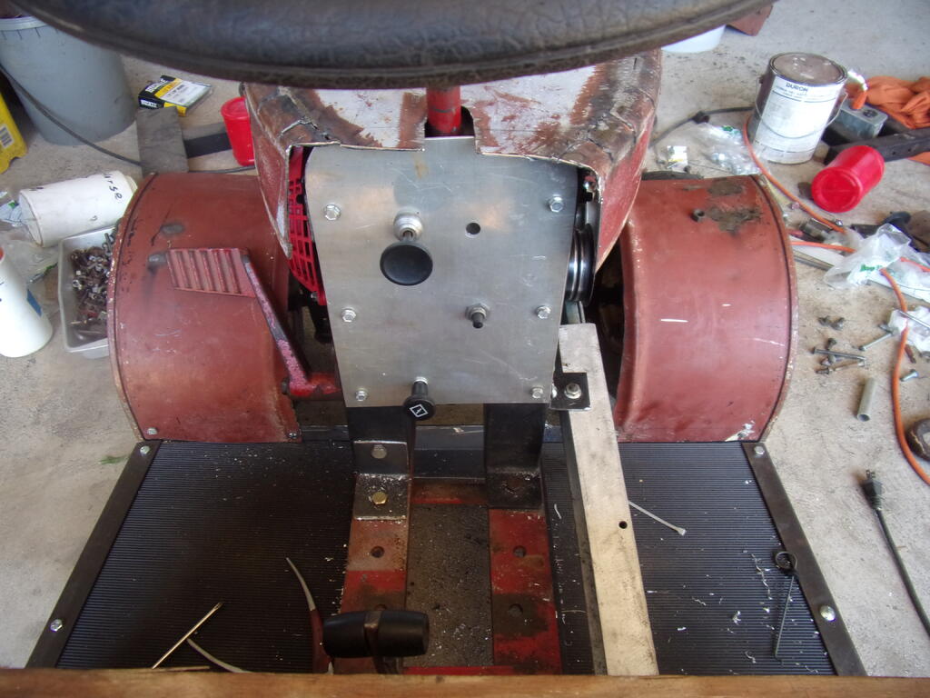

Ed Kennell 47,023 #41 Posted June 15, 2022 Got the dash plate made and added the remote choke, throttle, and kill switch. 6 3 Share this post Link to post Share on other sites
