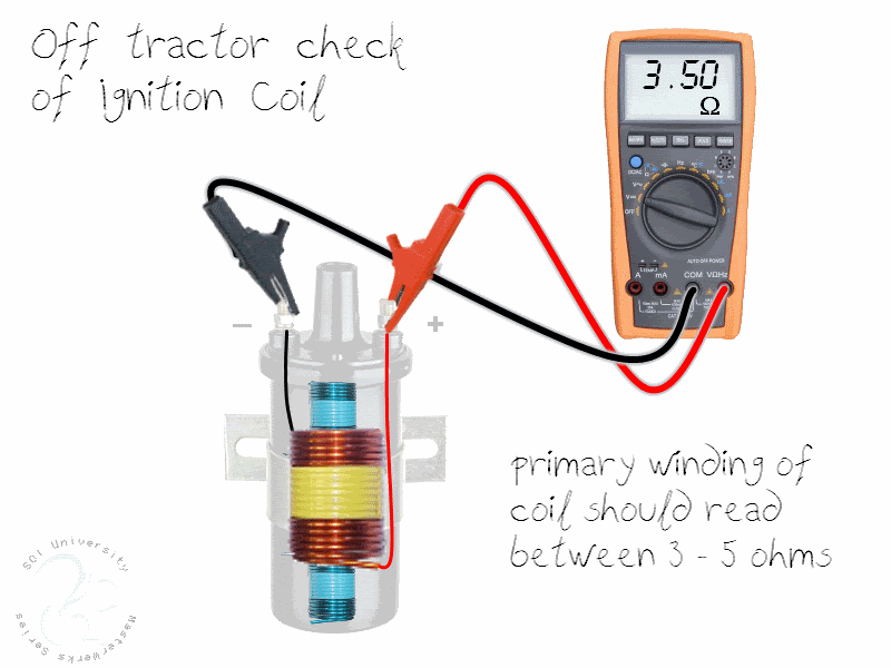

squonk 45,809 #3 Posted May 12, 2022 What coil did you use? You need an internally resistive one. Napa IC14 or equivalent. 2 Share this post Link to post Share on other sites

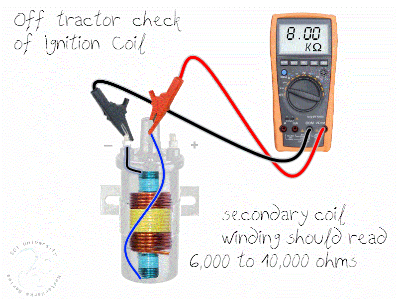

953 nut 64,649 #4 Posted May 13, 2022 If you have meter you can check to see if you have the proper coil. 3 1 Share this post Link to post Share on other sites
motor12 367 #5 Posted May 13, 2022 Thanks 953nut , those are the figures I need. Share this post Link to post Share on other sites
