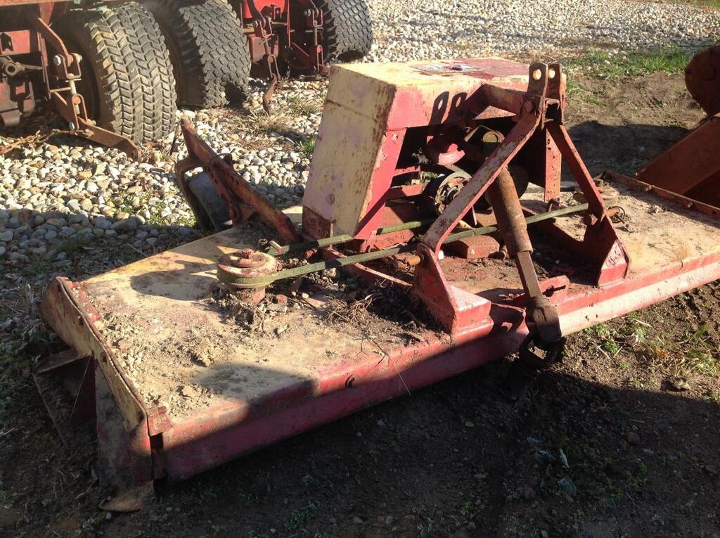

"Manic-Mechanic" 1,406 #1 Posted May 11, 2022 I currently have a nice 48" SD for my 18 Auto. Is there any justification in getting the 3pt finish mower, (any size?) Other than another rare implement and backing into odd spots? 1 Share this post Link to post Share on other sites
peter lena 9,562 #2 Posted May 12, 2022 @manic mechanic , finish mowers are very often , heavily abused and never serviced , very prone to violent rock hits , bent rusted , never lubricated or under cleaned . look like a money pit , pete 1 Share this post Link to post Share on other sites
Handy Don 15,230 #3 Posted May 12, 2022 19 hours ago, "Manic-Mechanic" said: I currently have a nice 48" SD for my 18 Auto. Is there any justification in getting the 3pt finish mower, (any size?) Other than another rare implement and backing into odd spots? That one looks like it was rode really hard and put away muddy. I'll bet the underside looks even worse. 1 Share this post Link to post Share on other sites
peter lena 9,562 #4 Posted May 12, 2022 @Handy Don guy up behind me , has some acreage , over 100 , typically knows it all , very sarcastic . was asking one of his workers how come he didn't get a flail mower instead of the finish type , with all the stones and debris , he just laughed and said , you can, t tell him anything . regularly mower deck slamming screeching to a violent stop . could not happen to a nicer guy . pete 1 Share this post Link to post Share on other sites
"Manic-Mechanic" 1,406 #5 Posted May 13, 2022 11 hours ago, Handy Don said: That one looks like it was rode really hard and put away muddy. I'll bet the underside looks even worse. That is not the one I am looking at, just for reference on the topic. The one I am considering is in really good shape, maintained and solid. The end shields will need replaced, which I can easily replicate. Share this post Link to post Share on other sites
"Manic-Mechanic" 1,406 #6 Posted May 13, 2022 (edited) 15 hours ago, peter lena said: @manic mechanic , finish mowers are very often , heavily abused and never serviced , very prone to violent rock hits , bent rusted , never lubricated or under cleaned . look like a money pit , pete Yes, the one in the picture looks scary! Again, I used the picture for reference on the topic. I went this morning and the mower for all appearance's looked good spindles were free. At first the seller said it would need a belt, then pulled the cover(at least it had a cover) and the belt was on and pliable. Thought this is odd, he didn't know it had a belt? Then its mounted on a D which hasn't run for a Season, so couldn't run it, not liking that, but it's a work around. For what I saw it looked fairly complete, but going by memory isn't smart. I looked into the manual for both the Wheel Horse 5-0900 and Woods 59 59L, apparently the left and right shields were getting rotted and the skids were not even there. This isn't honest, not liking that. (Coleman Equipment list the parts in stock and for another 300.00 could have them in 3 days) So, it sits at 500, another 300? Little high for a "rare" implement. Also, seems heavy, too heavy for the D hydro. I will get back to this seller and maybe hold off on delivery, seems off somehow... Thanks for the info Edited May 13, 2022 by "Manic-Mechanic" Share this post Link to post Share on other sites
